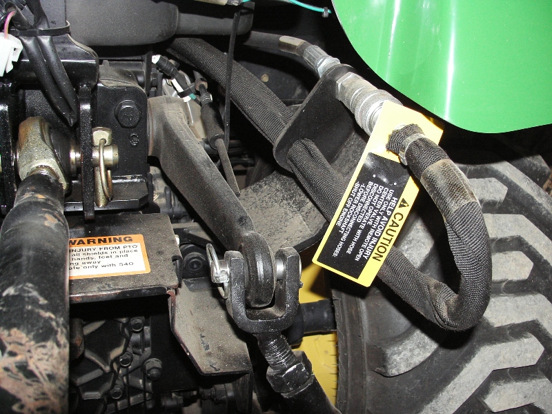

As far as a splitter goes, hard to tell from the pics but it looks like it has a "power beyond" kit installed. The hose on back that loops around to itself. Should have a yellow tag on it talking about using an open center valve and not to run the tractor without it connected to itself or a control valve. If that is what I see that's what you need to run a splitter. It might be a little slow but should do the trick.

FEL =Front end loader...got it. Yes he insatlled a power after . Is it just an extra hydraulic line? What does it do? I'd like to say Im a city boy, but just a regular guy that never grew up around tractors. thanks.

That power beyond gives you hydraulics at the back so you are almost ready for a splitter or a small backhoe, or top 'n tilt. (i'll let you look up the t 'n t as a contribution to your tractor education :)
