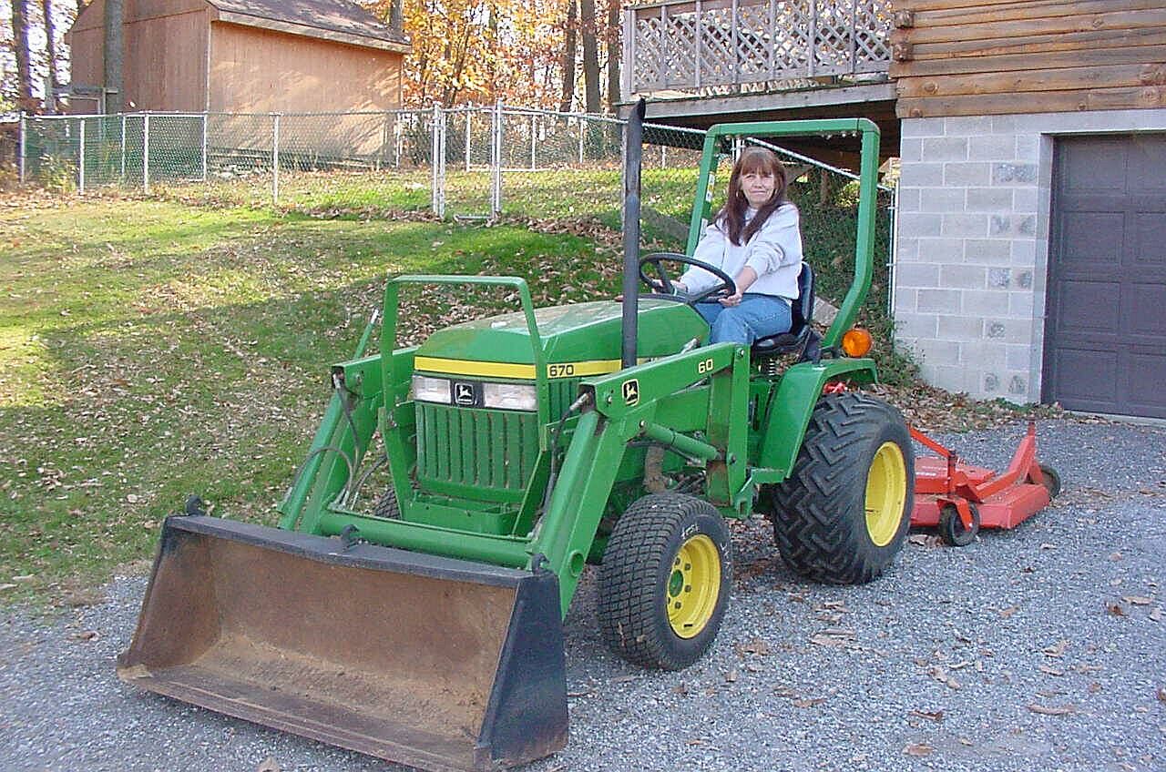

There's a picture of a 670 in the first post of this thread. They're considerably smaller then a 1050 and 1070....but larger then a 332 lawn tractor. About 19 Engine HP and 16-17 PTO HP.
These tractors haven't been built since 1994, IIRC. Finding a Mid-Mount mower will likely be a challenge and the 670 will need a mid-PTO to run a mower.
I ran a 60" rear mower with my 670. The picture below is my wife on our 670 (circa 2001) and should give you an idea of the size of the tractor.
In some ways, I wish I still had this great little machine...not as a replacement for my 4520, but some chores can be handled better by a smaller tractor
