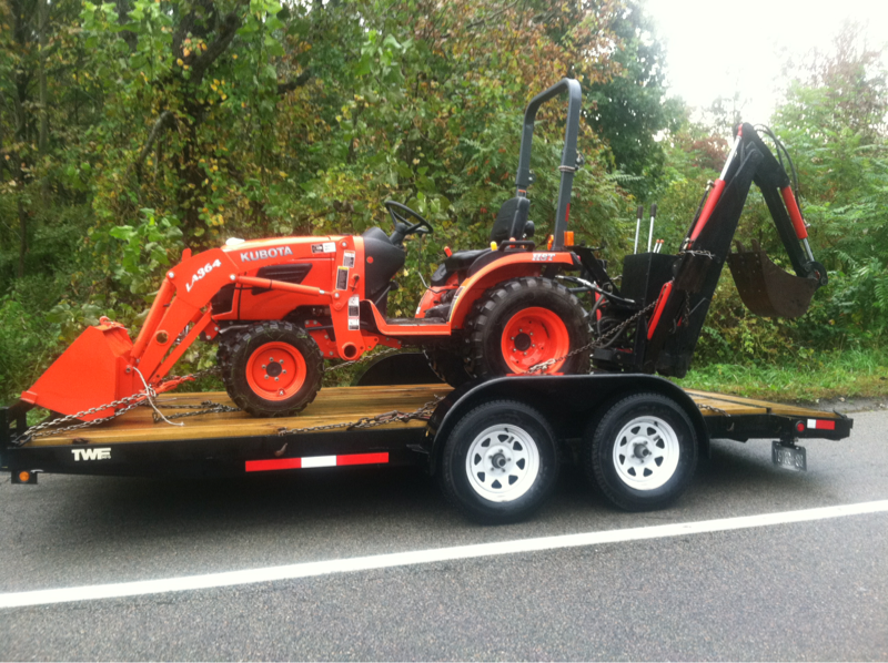

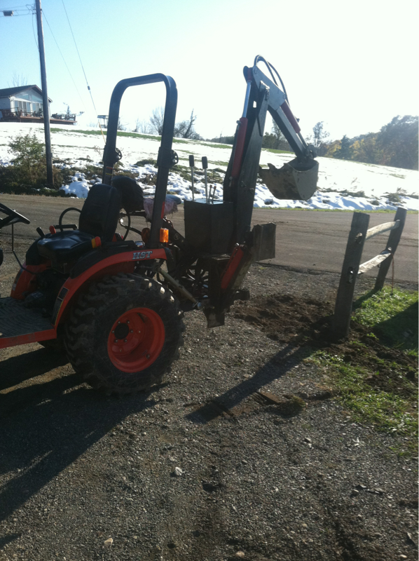

I have a 7' 3 pt hoe for sale,,not too far from western mass,,,,zip 12523,,, like new, but a few years old,, jakell2010@gmail.com. Runs off tractor hydraulics, no pump, works 100%, to heavy for my B series
   / Just bought a Kubota L2950 #25
What do you want for the hoe, and pls post a picture......:thumbsup:
   / Just bought a Kubota L2950 #26
$2800. Pm me with your email and I will email pics and what I know about it
