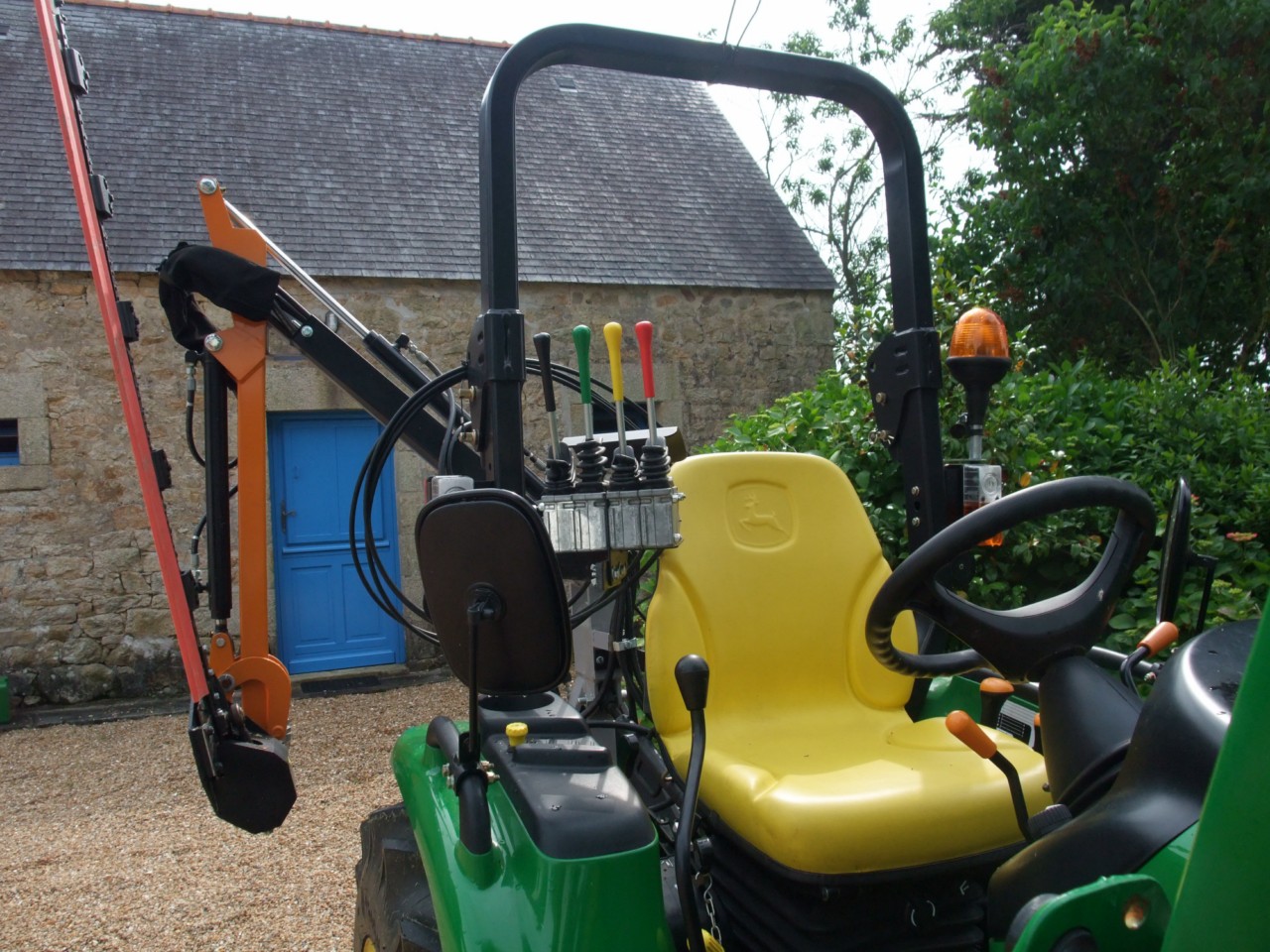

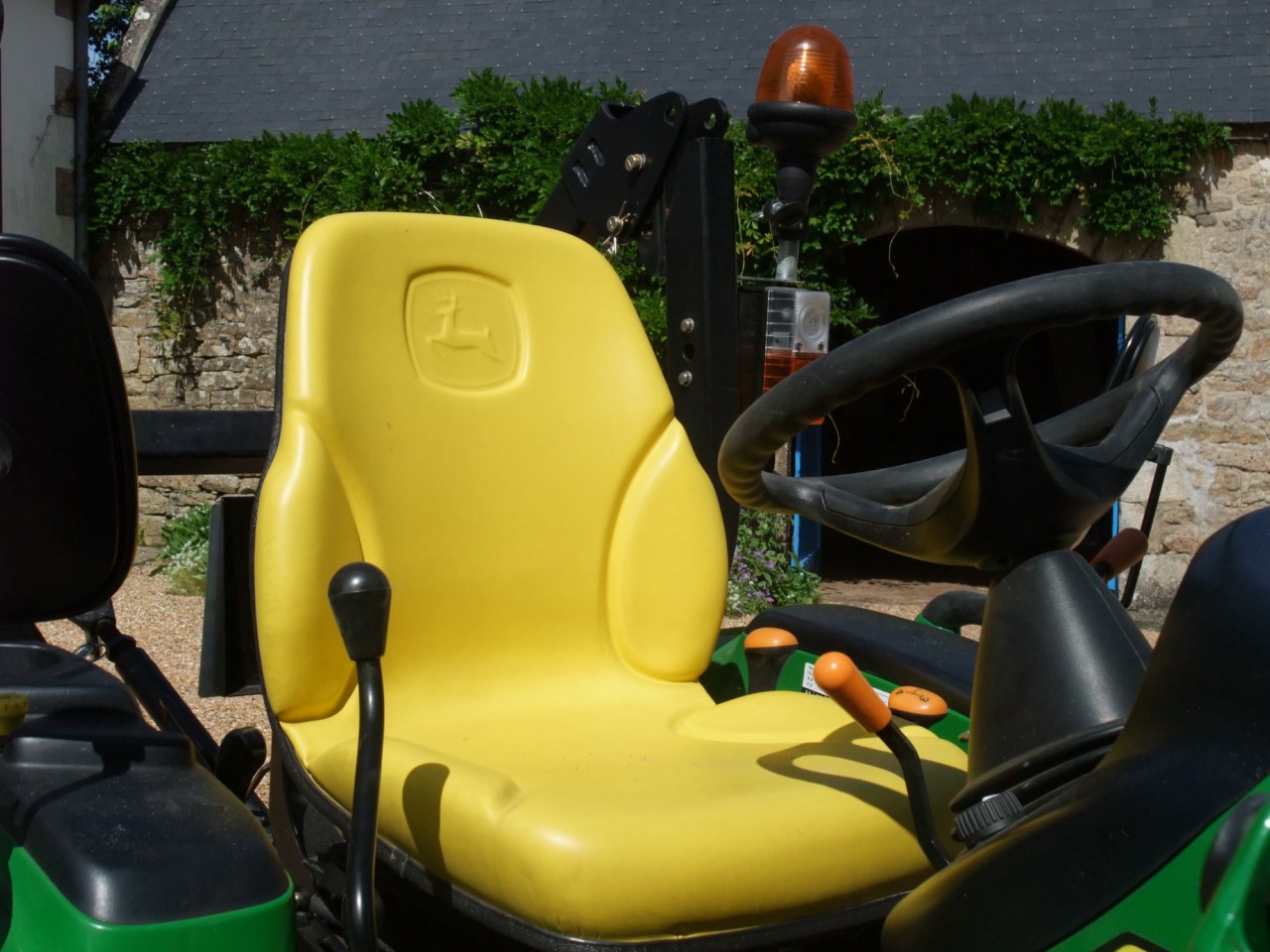

John Deere tractors come from the dealer with amber strobes in this country as they are compulsory on the highway. My 3520 has the strobe on a JD bracket which does not interfere with folding the ROPS. The same bracket would certainly fit your bigger machine.
Thanks for the photos! This is exactly what I am looking for. I intended to fabricate one out of square or round tubing and mount a strobe to it in the same location as yours. I have a spare strobe light, I just need the bracket.

The bracket even uses the original bolt and is held firmly by the structure carrying the lights. It has a central connector protected by a rubber cap when not in use so that the strobe can be taken off and put back on very easily. That's precious as it tends to get caught in bushes and trees more than any other part of the tractor. Even without the strobe in place, I manage to get the tubing entangled in branches quite often. So if you build one, make it strong !
