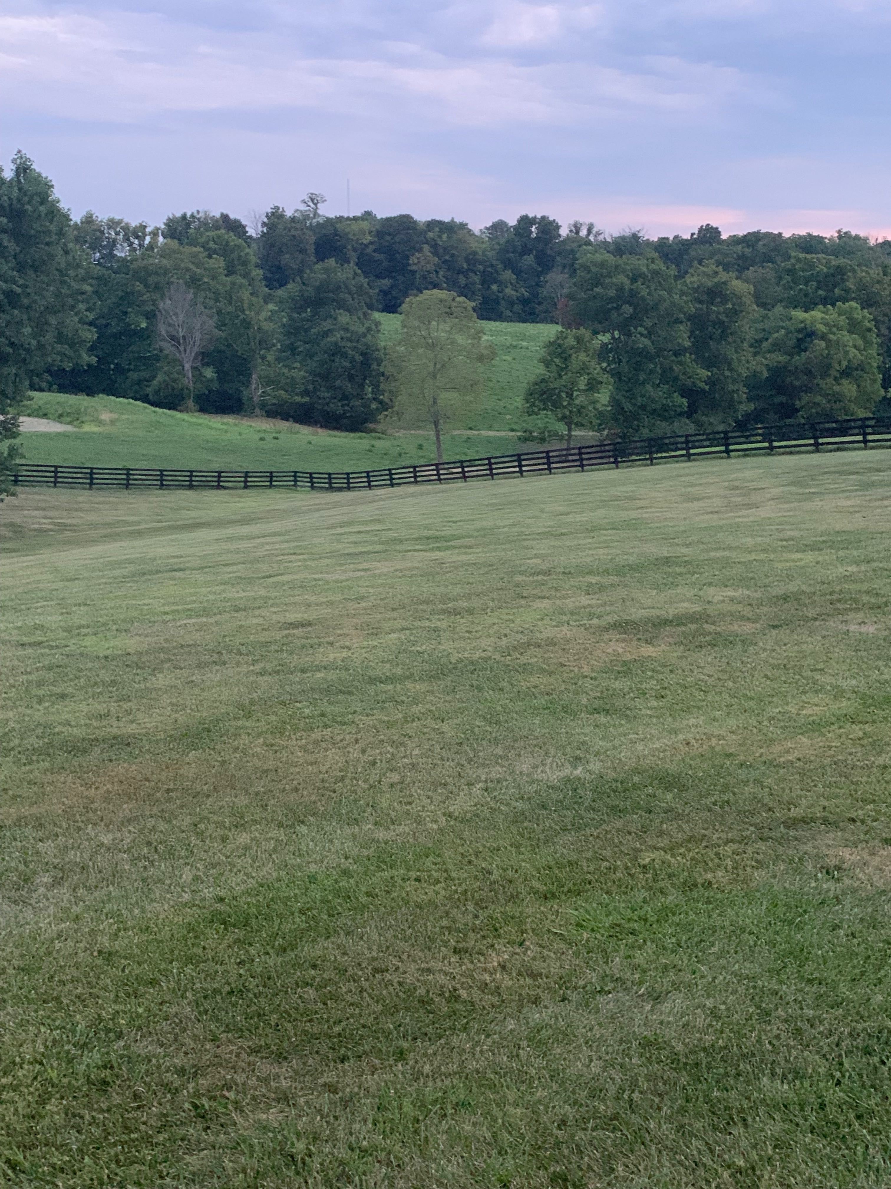

Just some early pictures. I will load a video soon. This machine is a great machine and worth the money. 28, 1.75-pound hammers spinning at 2200 RPM will absolutely destroy about anything you run over, leaving nothing but finely mulched debris.
My principal purpose for this machine is to trim around the hayfields and ponds on the property. What I have found is its a better machine to move close-in to the fence rows compared to the other mower I have been using. Keeping 5 miles of Ky Blackboard fence trimmed takes some work!
Speaking of fences, while cleaning up adjacent to a deeply enshroud woven fence, the unit grabbed some fencing material that was apparently just left adjacent to the fence and wrapped the barbed wires nice and tight around the spindle. Wire cutters could not cut these wires, but the grinder sure could. Cut the wires, sharpened a couple of hammers while at it, and went back to work.
I have been clearing some areas with heavy brush and saplings and this tool absolutely impresses me. I don't want to sound over-zealous, but seriously, compared to other models available on the market, the extra cost was worth it.
