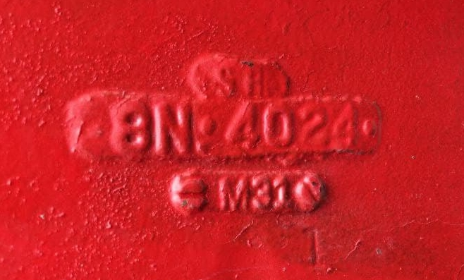

Won't run well since moving from 8000' altitude to 1000' here in Central Texas. In fact it won't even crank now due to dead battery. And it's still 6v, so my first step is to order up a 12v conversion kit. I'm not about to pay good money for a 6v battery.
Is this the serial number? 8N 4024
What do y'all recommend for a 12v conversion kit? I spotted this one but my small engine guy thinks it is spendy:
Ford 8N 12 Volt Conversion Kit, Front Mount Distributor
What would you recommend as the next mods to do? The carb looks new but given the symptoms the seller described, I suspect that it's at fault. Spitting back, rough running, trouble starting. Of course I remember what my HS Auto Shop teacher said in the 60s:
"If it's not running well, check the ignition system. That will solve 90% of your problems. For the other 10%, check the ignition system."

We used to put 8v batteries on all our 6v systems. It made them much more reliable and no conversion kit needed.

TSC sells 6V batteries every day of the week....for about $100....a bit less than 12V cost.
The conversion kit you reference states: for "front mount Distributor".
My 1951 late model 8N, has a side mount distributor.
I added a Petronix CD ignition kit, and do recommend it.
I have had my 1951 6V 8N for 49 years, with only 4 (?) different batteries. (I do use a battery "maintainer")
No problems with 6V at all!

You probably have more humidity where you are now. Yes, check cap/rotor/wires/points. I have heard that some crappy condensers have been sold in kits too.

That is not the serial number, the serial number is hand stamped on a flat place on the back left corner of the block. They can sometimes be hard to impossible to read. Use a wire brush (brass) on a dermel works good for cleaning off the numbers often making them easier to read.
