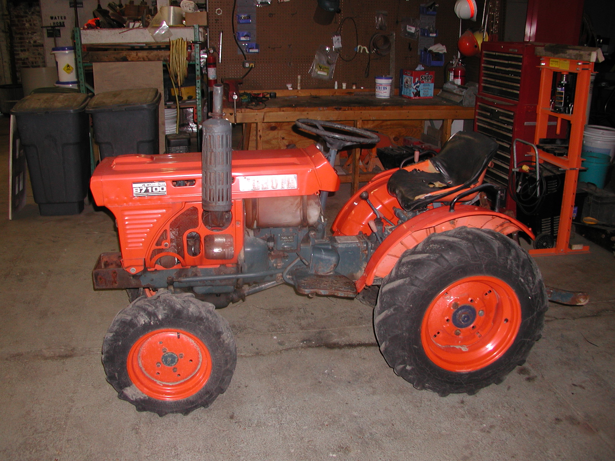

Hello,
What a great website. I found it by doing research on the Kubota 7100 that I just purchased. I'm sure I'll be asking plenty of questions as this old 7100 is going to need some TLC (and transmission work!) do bring her back to good working order. So whomever reads or responds to my questions, please be patient. I'll do my best to keep questions to a minimum. I'll take pictures and post them here as I go through the restoration/repair work.
The 7100D I purchased was an ebay deal for $1500.00. The engine runs fairly well, but there appears to be plenty of other "issues" to deal with, the most serious appears to be a transmission/PTO gear knock in low range PTO, low range 1st gear, and also high range 4th gear. I believe that it's the same gear causing the "knock" in all three positions and I'm pretty certain that it is a chipped tooth(s) on one of the gears. I also have sticky brakes, worn tires, a right rear hub thats wobbles around on the axle, sticky throttle controls, rusted decompression cable, electrical wire disconnected and a clutch that just about throws me off the tractor! The list goes on and on and on... What could be more fun? It always seems like I go for these old restoration projects instead of just going out and buying a new one. At any rate I ordered a service manual and a parts manual and will get started here in the coming weeks. Any advice on restoring this great old tractor will be appreciated. I thought I would start with the transmission/rear end rebuild then move forward through the tractor correcting problems as I go along. Should be fun, at least I hope so....

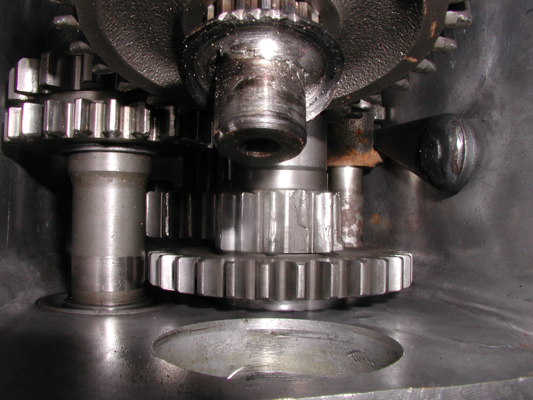

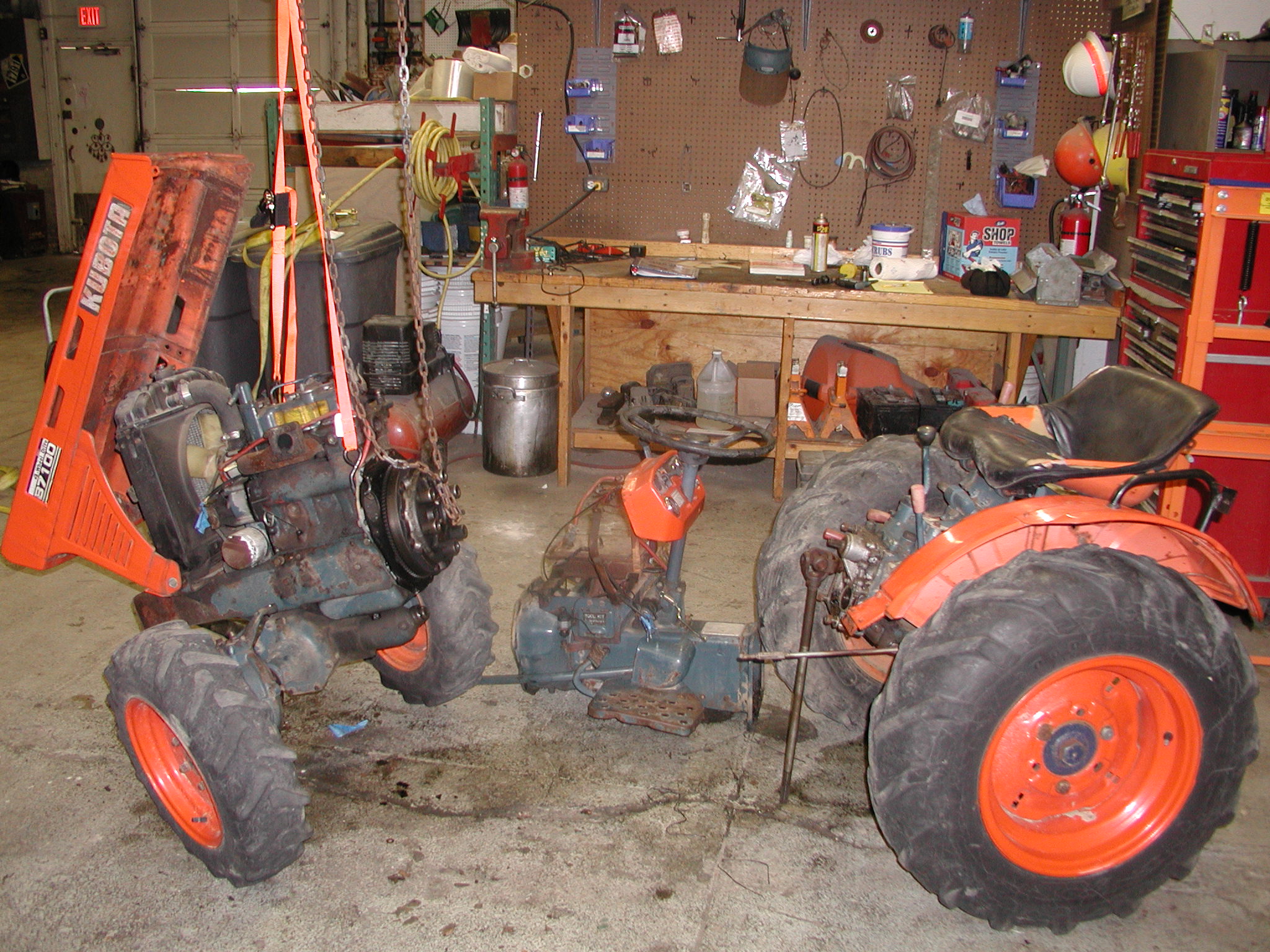

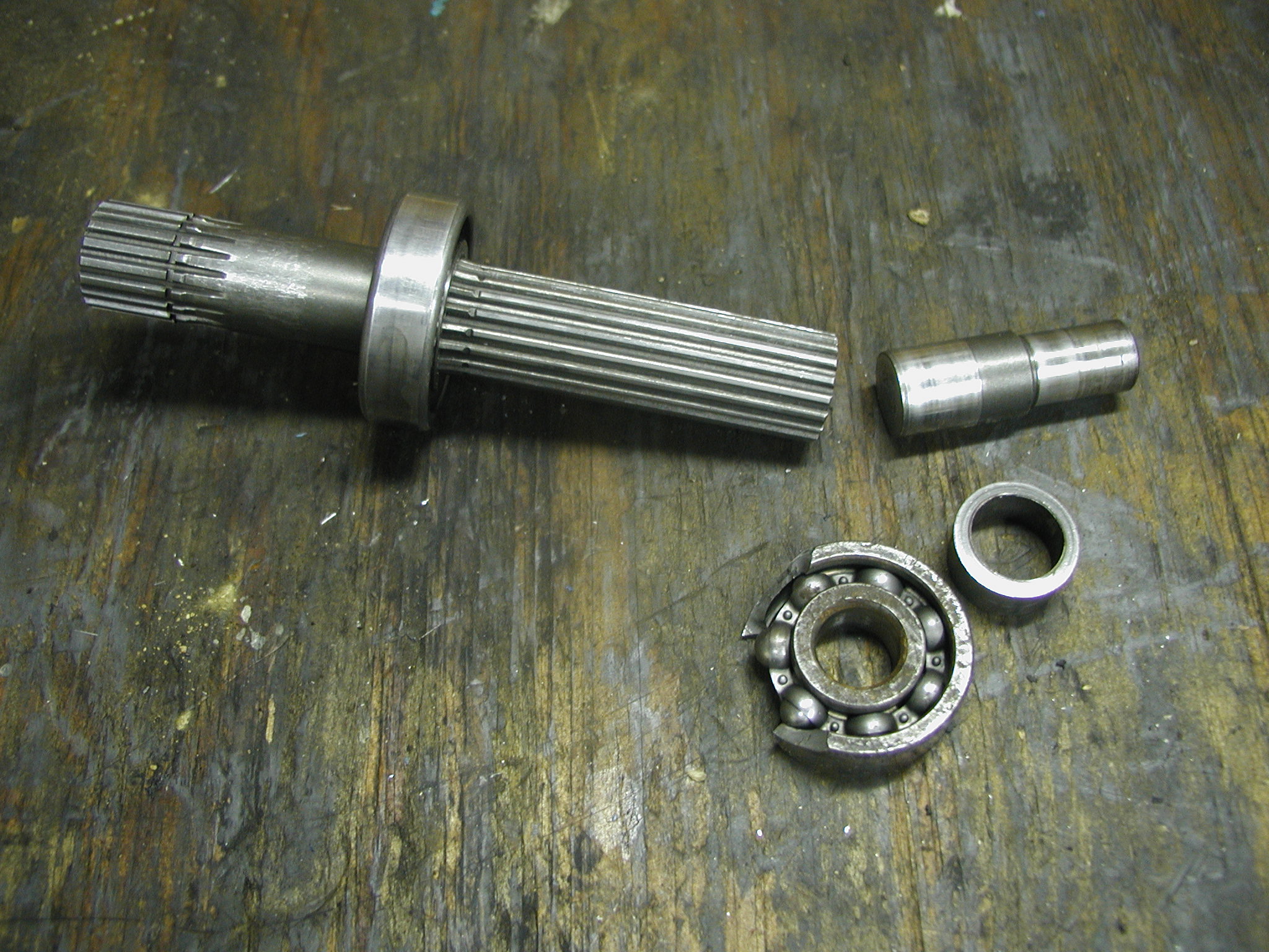

Just thought I'd follow up to my post on my new, used B7100. I split the tractor and dis-assembled the transmission to find the source of the noise. Boy was I suprised! It's a wonder the tractor continued to move! There are gears with missing teeth, most bearings are worn or completely burned. Some of the needle bearings had even melted and welded themselves to the input of the #1 shaft. The PTO shaft (shaft 3) was broken in two pieces near the front of the shaft. It's amazing that the PTO continued to spin. At any rate I put together a parts list and am currently getting prices on the parts to put the transmission back in good order. I'll post again when I find out the financial damage...
