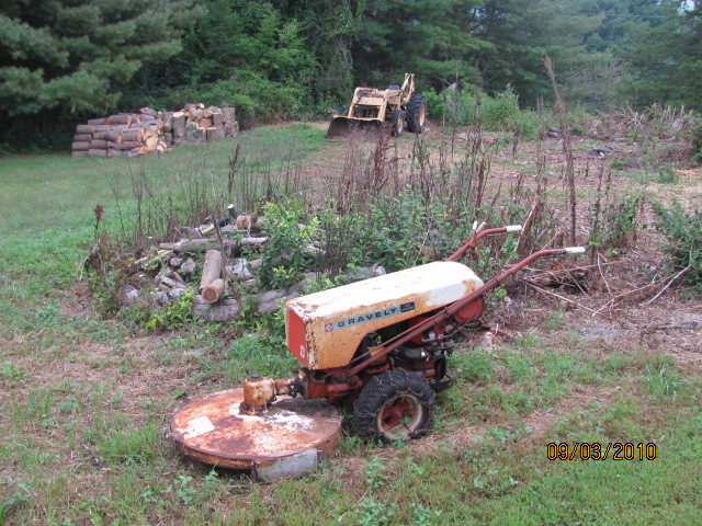

I looked at a new DR but got serious sticker shock. Instead I got an old 1960-something Gravley L8 Super Convertable for brush mowing. They are still out there for about $500 with a brush mower deck. It's a beast, virtually indestructable but it is very heavy and can be stubborn. Sometimes it goes the direction it wants and it's tough to wrestle it around, it has no steering or brakes. If you lose your grip on it or trip and fall, it will just keep going without you, mowing whatever is in it's path. If you have it in reverse and trip on a stump, get up quickly because it's coming for you, lol! It will go as fast as I want, I'd have to jog behind it if I have it in high gear. It is also devoid of any safety devices as it was built before the age of frivilous lawsuits, love that!
The Gravely is probably not the ideal solution for you if you can afford a new machine that is easier to use but for anyone else who is looking for a cheap option, look for an old Gravely, they are addicting (get the L8 with the hi/lo tranny). Here's a pic with my old Massey Fergusson T/L/B in the background. Both machines are in really good shape, they just need a little paint.
