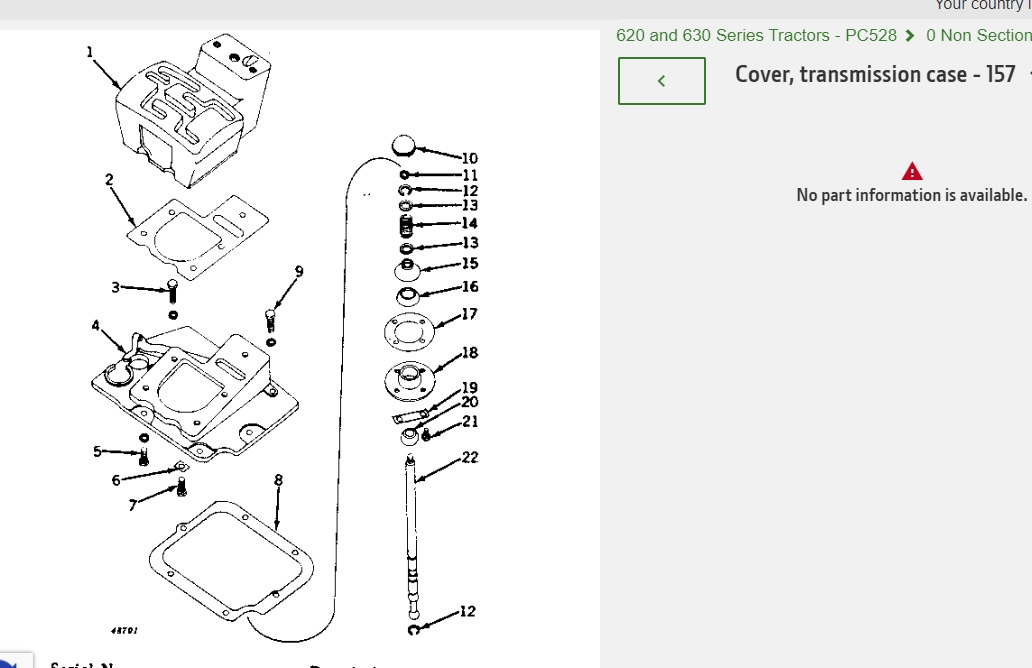

   / Just got a 630 #3
It has been a lot of years since worked on an Johnny popper but I do recall some models had problems with the end of shift rod wearing and would occasionally not shift gears properly. From memory is was just a few bolts and the shifter lifts off and you have access to all the internal linkage. Would suggest getting service manual since my memory ain’t what it used to be.
is yours a gas or diesel. Our old 720 diesel had the pony motor so no help on how it should turn over.
   / Just got a 630 #4

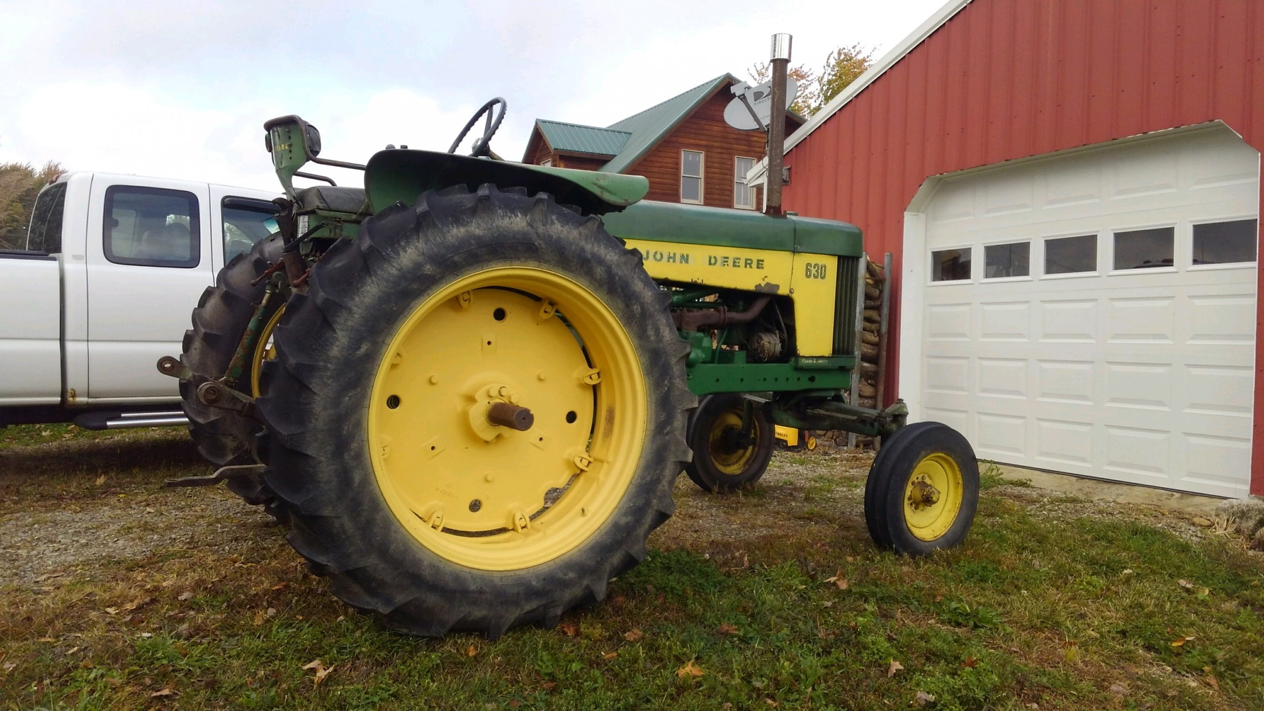

   / Just got a 630
Here is a couple of pics of the 630, I will post more as I fix things up.

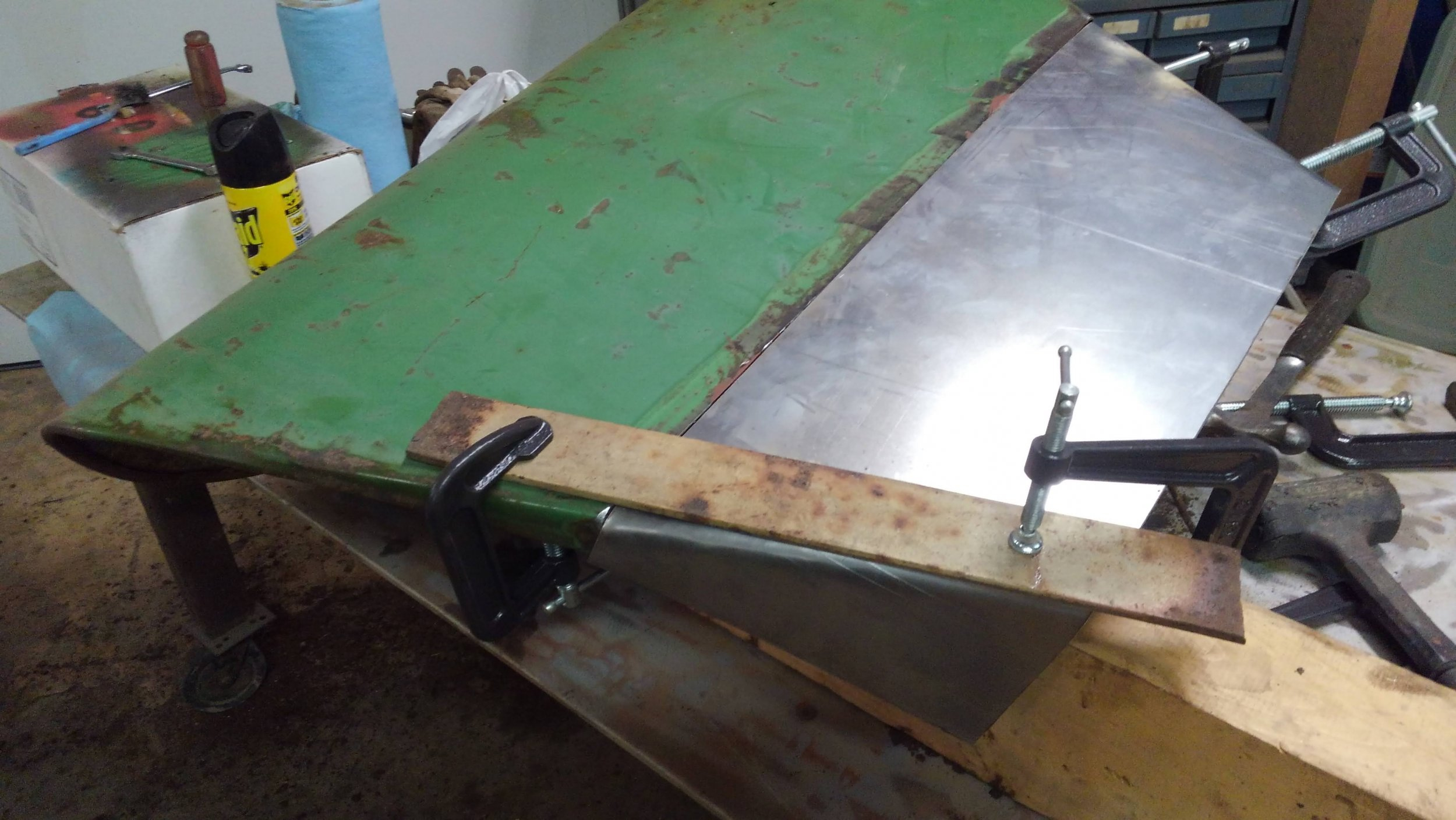

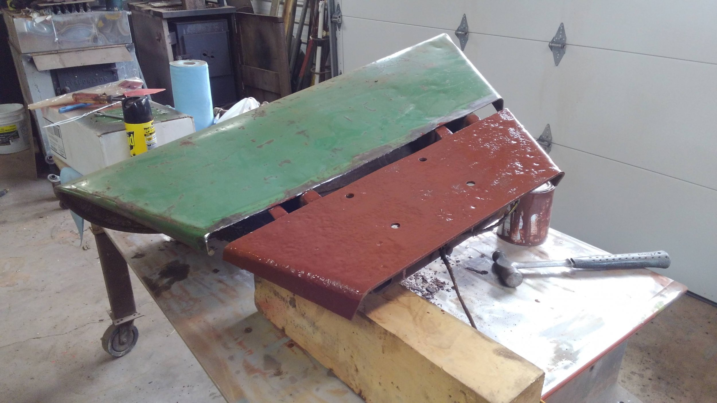

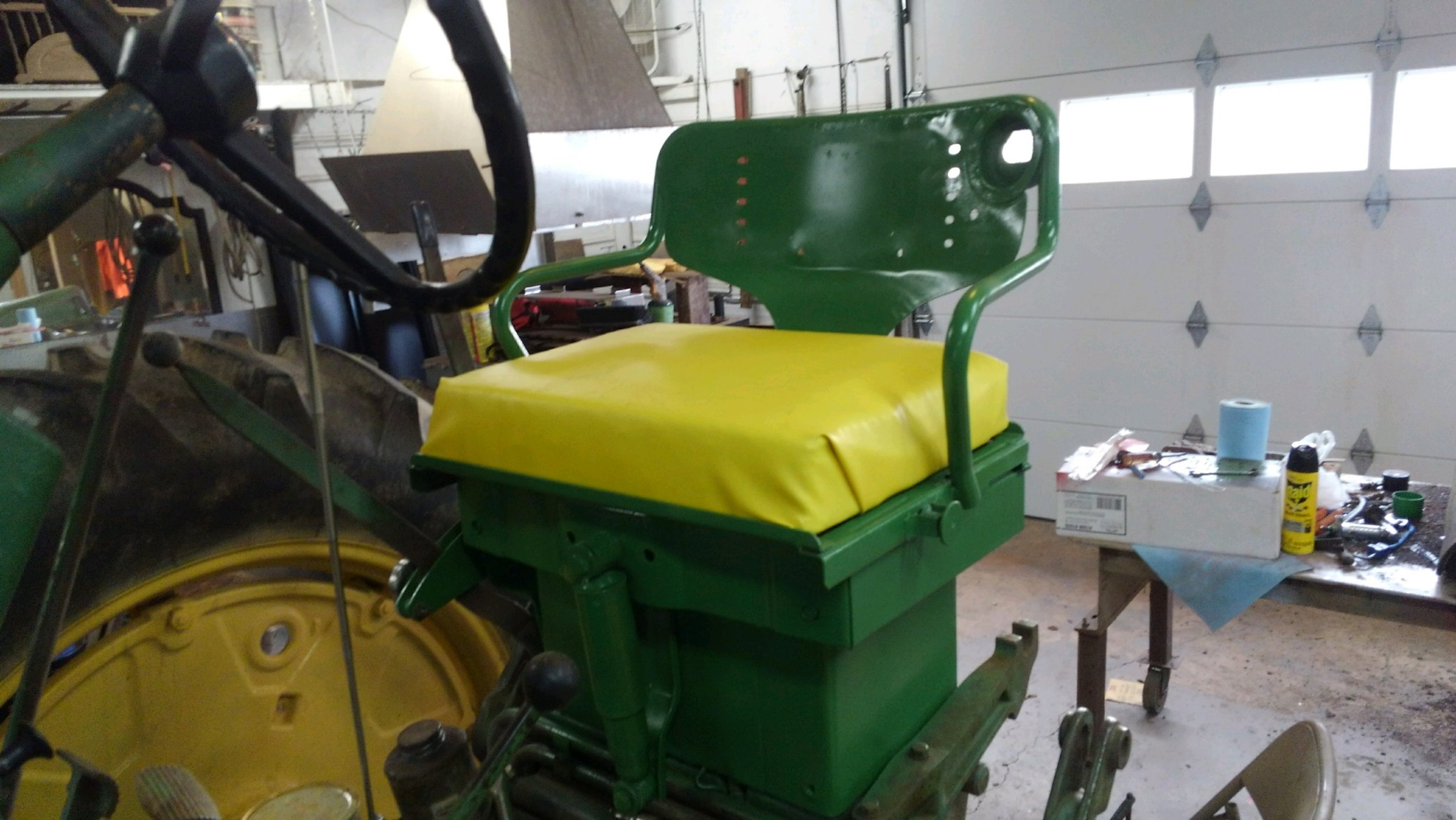

   / Just got a 630
#9

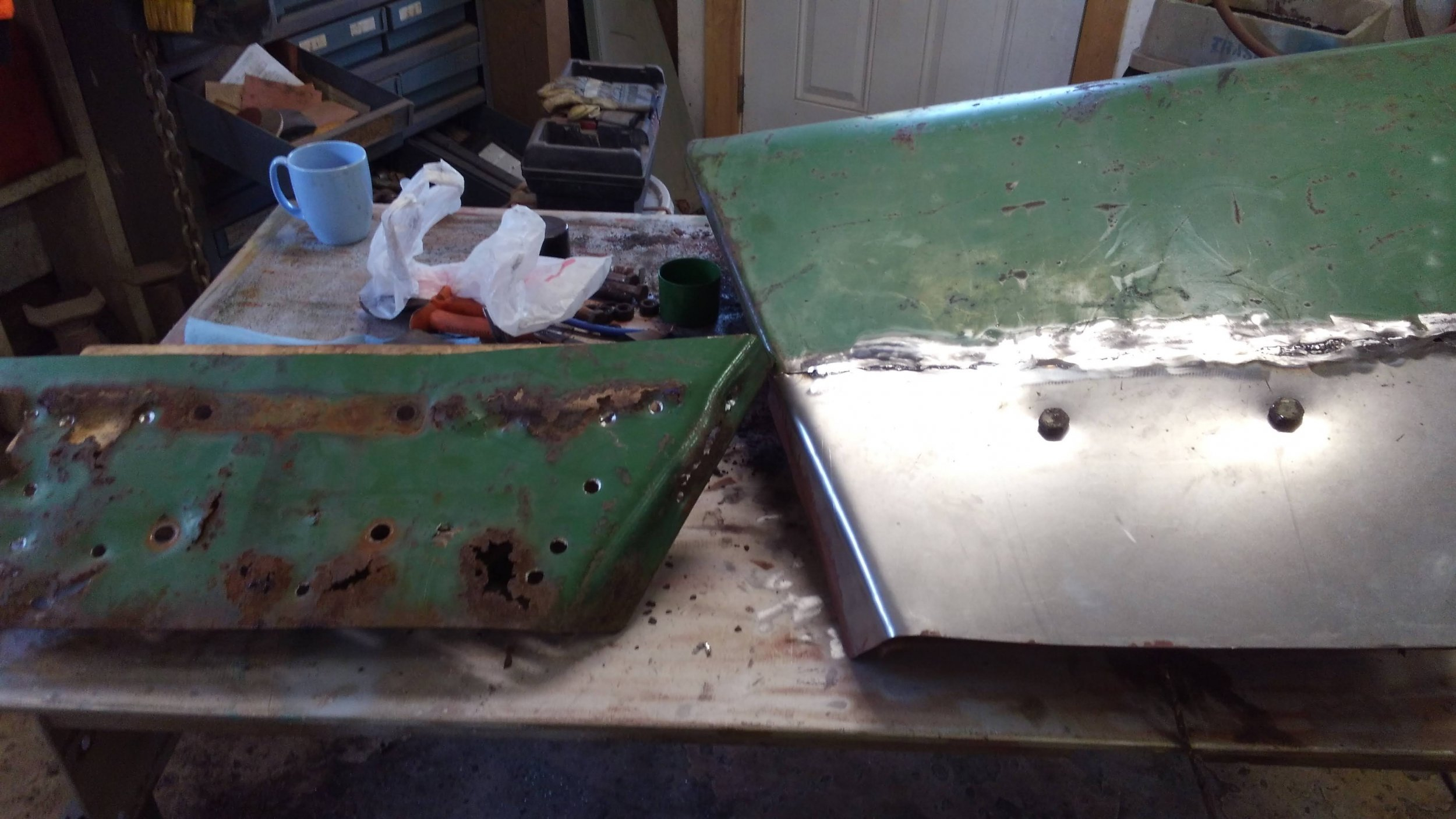

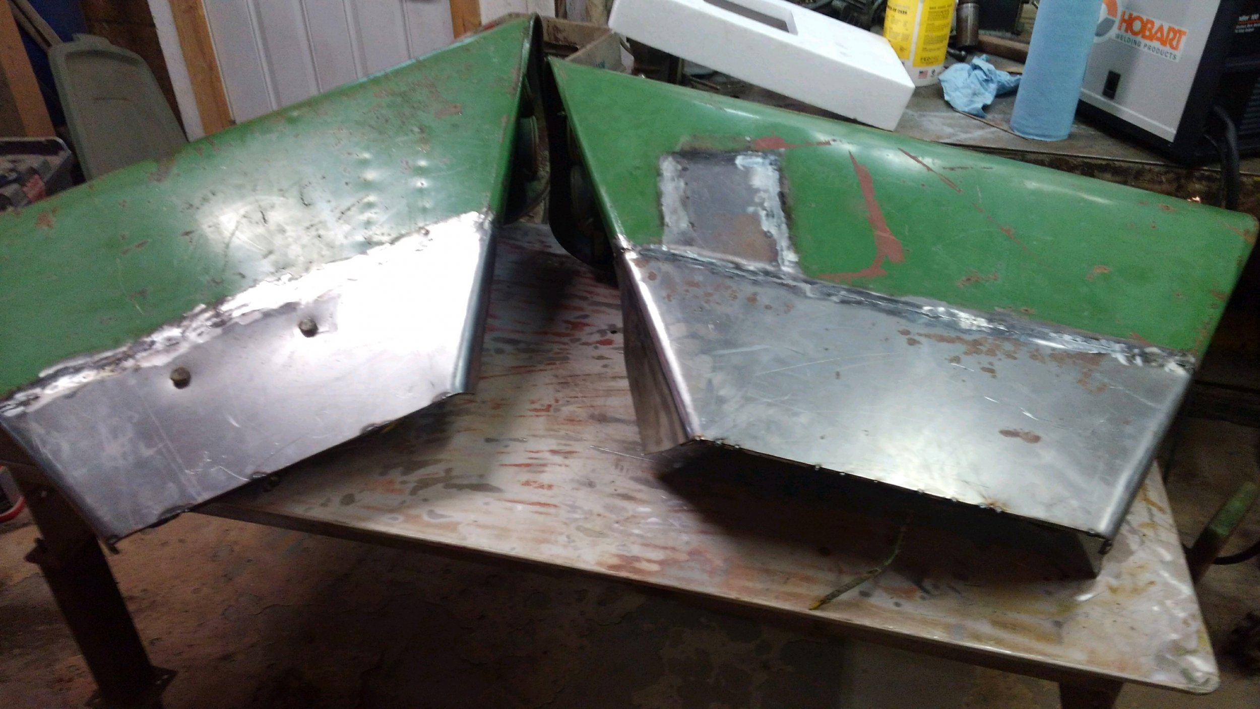

I have repaired the battery box and re-covered the seat bottom. And am working on
fixing rusty fenders, will take a little time but I will get it.
