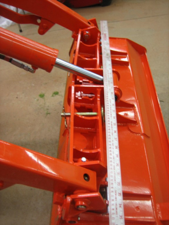

I assume Axlehub is working with the manufacturer to make a version for the DL95. I recently had a quote of $799+shipping for a DL100 version. A DL95 version should be the same price once designed.
There are not a lot of these out there. I contact a couple of member who have them on Kubota BX machines. They both say good things about the quality and ease of the tach-n-go. However, one person reported bending on the tach-n-go with heavy work, and showed me the pictures to prove it. That person had been working with Jery at Mytractortools, and some additional bracing was going to be added, hopefully that was added permanently to the design.
I would not worry so much about the strength of the tach-n-go on a machine with double cylinders...when using a bucket, forks, or grapple for example, as the forces are right at the end of the loader arms, not out in the middle like on a machine with a single cylinder design such as the Kubota BX machines. However, I would be cautious about using something like the ripper tooth shown on the website, which puts all the forces right in the middle of the tach-n-go.
