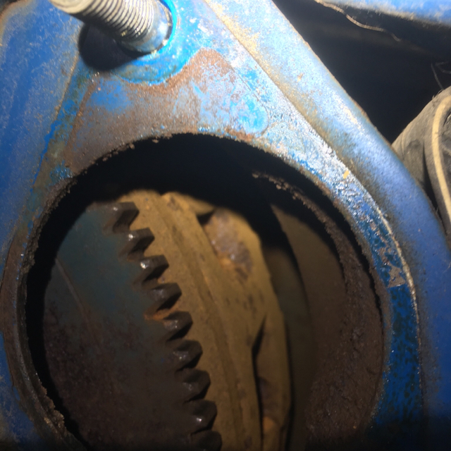

Your throw-out bearing is probably gone. Take the inspection cover off and see if you find any balls.

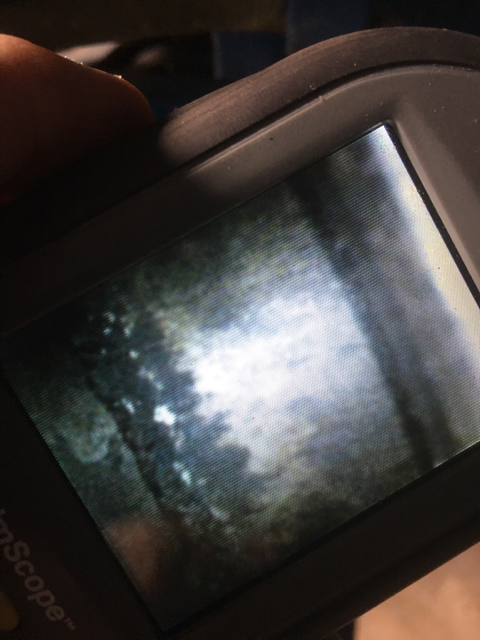

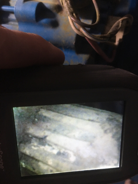

Now that i found the app for my phone this looks like it will be easy lol hopefully pics coming. What I think happened is the previous owner jammed in the clutch pedal and may have shear the pins for the fork took a quick look with bore cam and saw the throw out bearing and its close to the clutch fingers but nothing pushes against them i did see the bearing holder/ fork move on shaft so i think the pins are sheared IMG_5402.JPGIMG_5408.JPGIMG_5413.JPGIMG_5414.JPG
I have figured out the mounts for the fel are covering the inspection holes will have to get it removed for a better look
