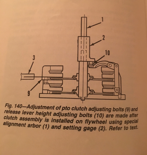

You can make a wooden dowel clutch alignment tool. Some clutches actually are supplied with the alignment tool.
The one i saw in the generic service manual had a thing you slipped over the shaft i thing for setting the fingers maybe. I'll have to look it up and post a picture of it
   / Just got this 1990 1920 with fel and back hoe (2003)
#24
This is what i was talking about. My buddy says we can take a measurement off the fly wheel with a depth gauge. And from what i have read on line these are just about impossible to get a hold of
   / Just got this 1990 1920 with fel and back hoe (2003) #25
   / Just got this 1990 1920 with fel and back hoe (2003) #26
View attachment 494626View attachment 494627View attachment 494626
You aren't going to be doing any of this. Relax. Split the tractor, get the parts and give it a go. Get the disk aligned the best you can and try to push things together. if not, try again and maybe use a screwdriver to line things up. It will go together just fine.
