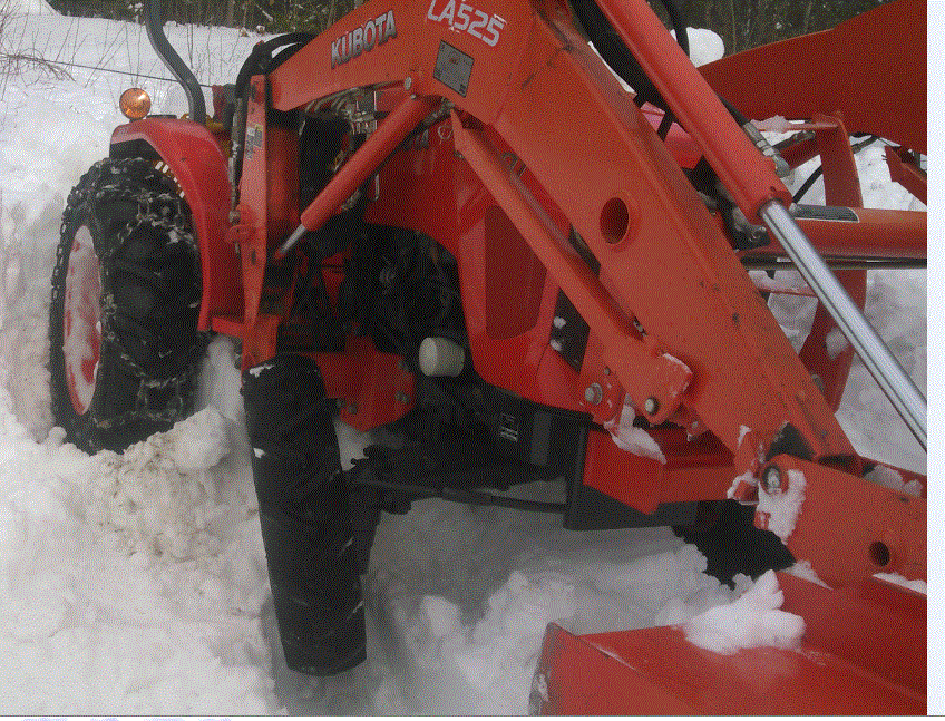

You can do as well if not better with a chain running from a center bucket hook to a tree, then curling the bucket. That isn't much help if you can't go forward but I try not to get into that type of situation. Of course there's always that one time... as shown in this pic which I posted last winter. That day I was shoveling... despite having the bucket on front and winch on back I was stuck between the snow bank and my shed. :shocked:
