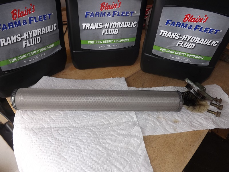

I just changed mine recently. The YM2610 took 19-quarts! It has the reusable screen olefin filter on a stainless steel cylinder. To clean it, Hoye recommends diesel with a tooth brush and then rinse with brake cleaner.
