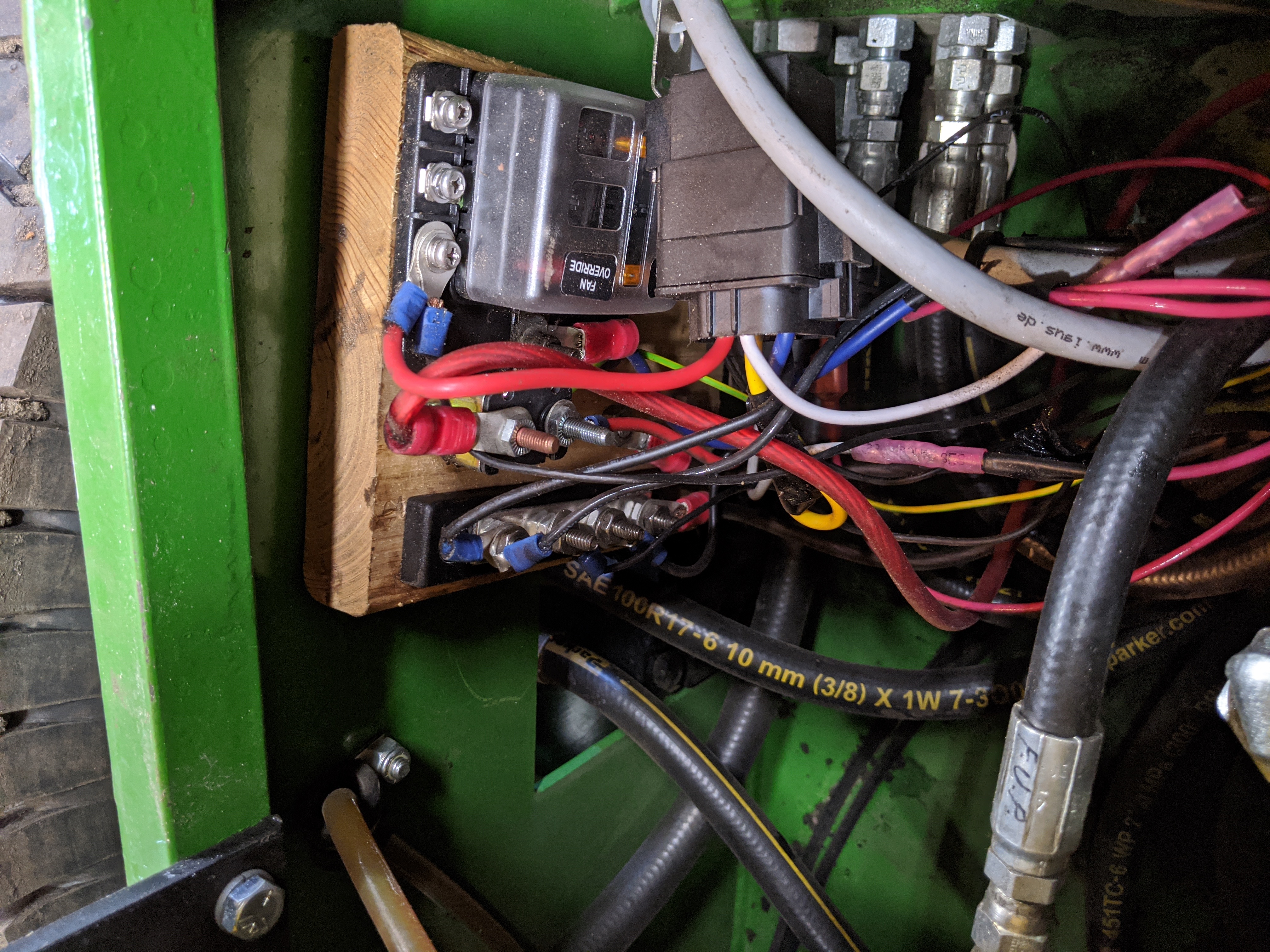

Spent most of the day yesterday adding a bunch of electrical stuff. I will take some pictures and post later.
I decided to just do it right the first time and I added a small fuse box, a relay on the +12V key power (feeding fuse box). Then wired some headlights, a fan, and the oil pressure light.
Fan and Lights have their own switches and also power down when key is off. I found a stubbed out key power wire in the back(yellow), next to oil pressure wire(grey). So didn't have to cut any of the existing wire at all.

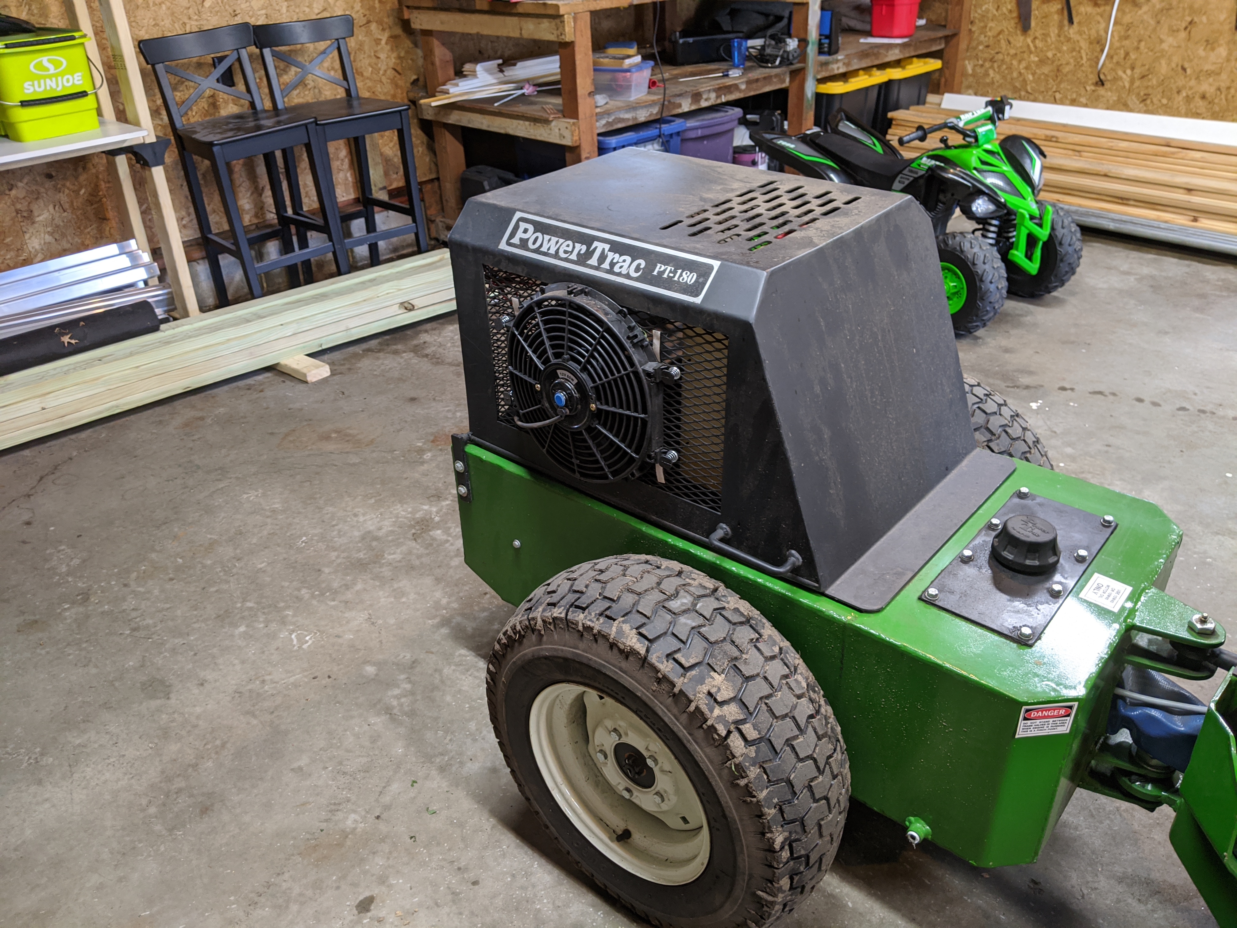

I zip-tied the fan onto the right side, pushing into the motor (had to swap blade and swap + and - wires), and across the exhaust.
Also did the first filter change. Besides getting oil everywhere, it was pretty easy.
It's still heats up pretty good after an hour or so, but the fan is definitely helping delay that.

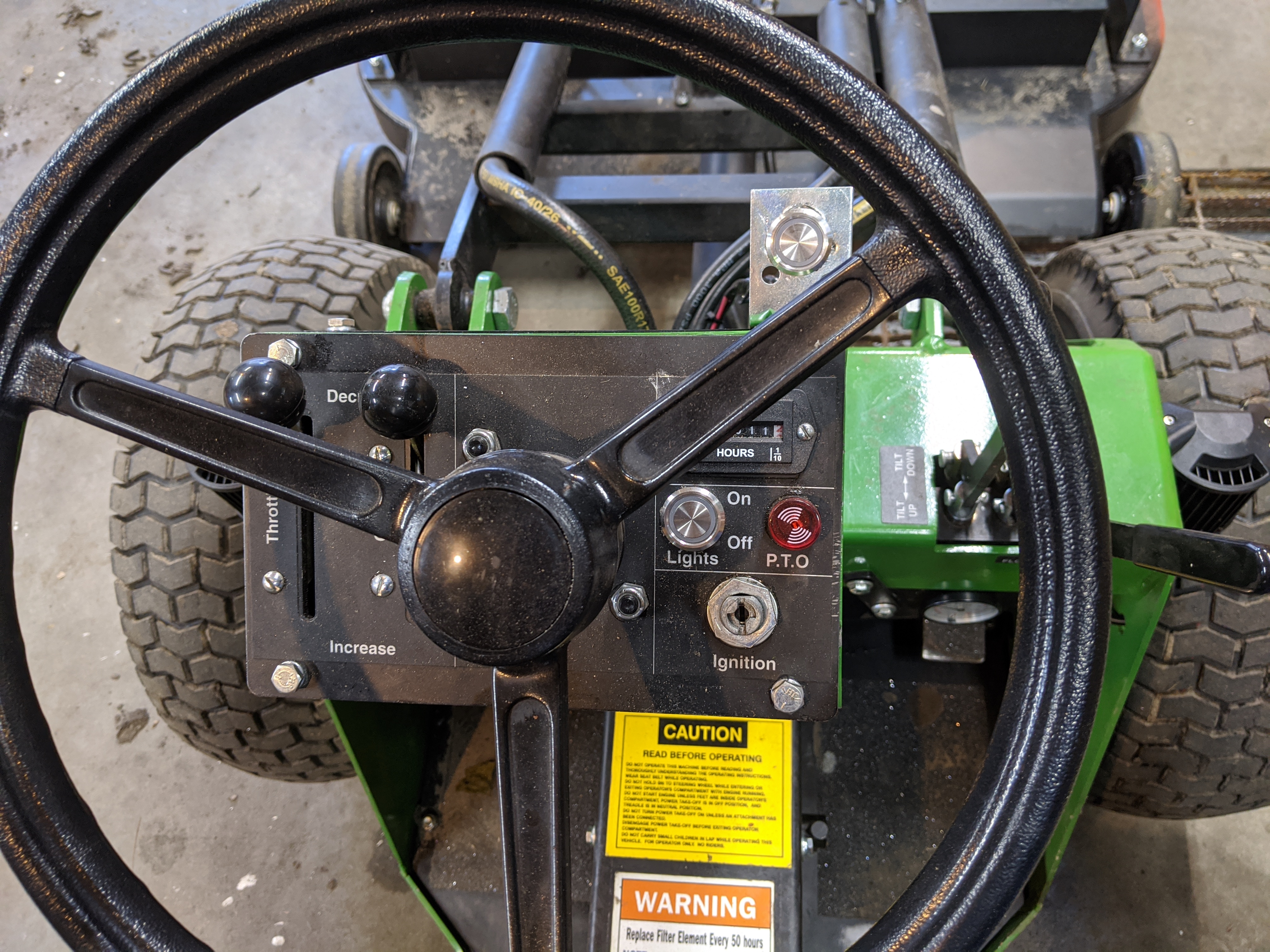

Pictures of the electronics work. Not the prettiest, but all functional. I drilled out the PTO and Light hole on the console, but other than that nothing modified, just added.
