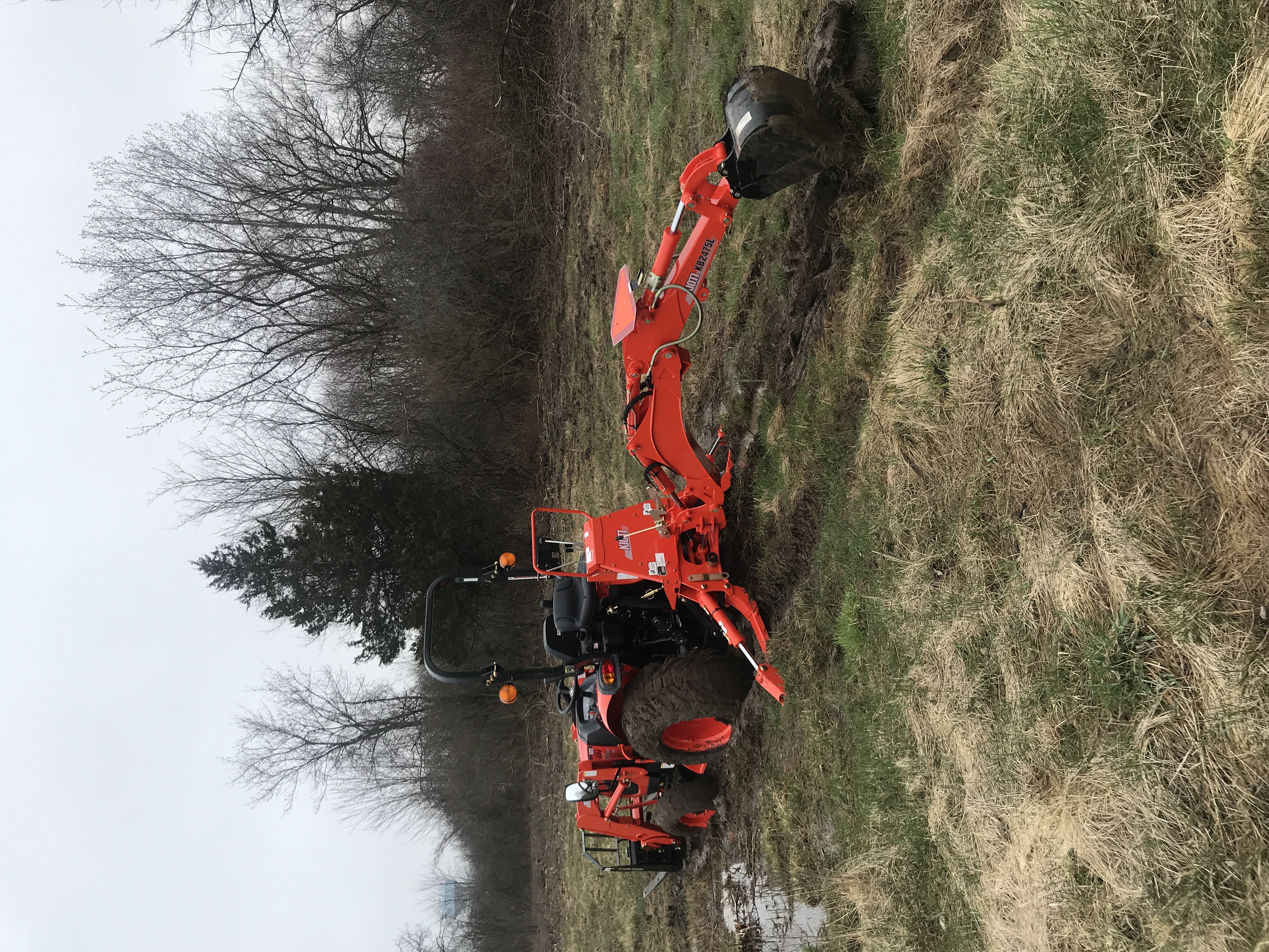

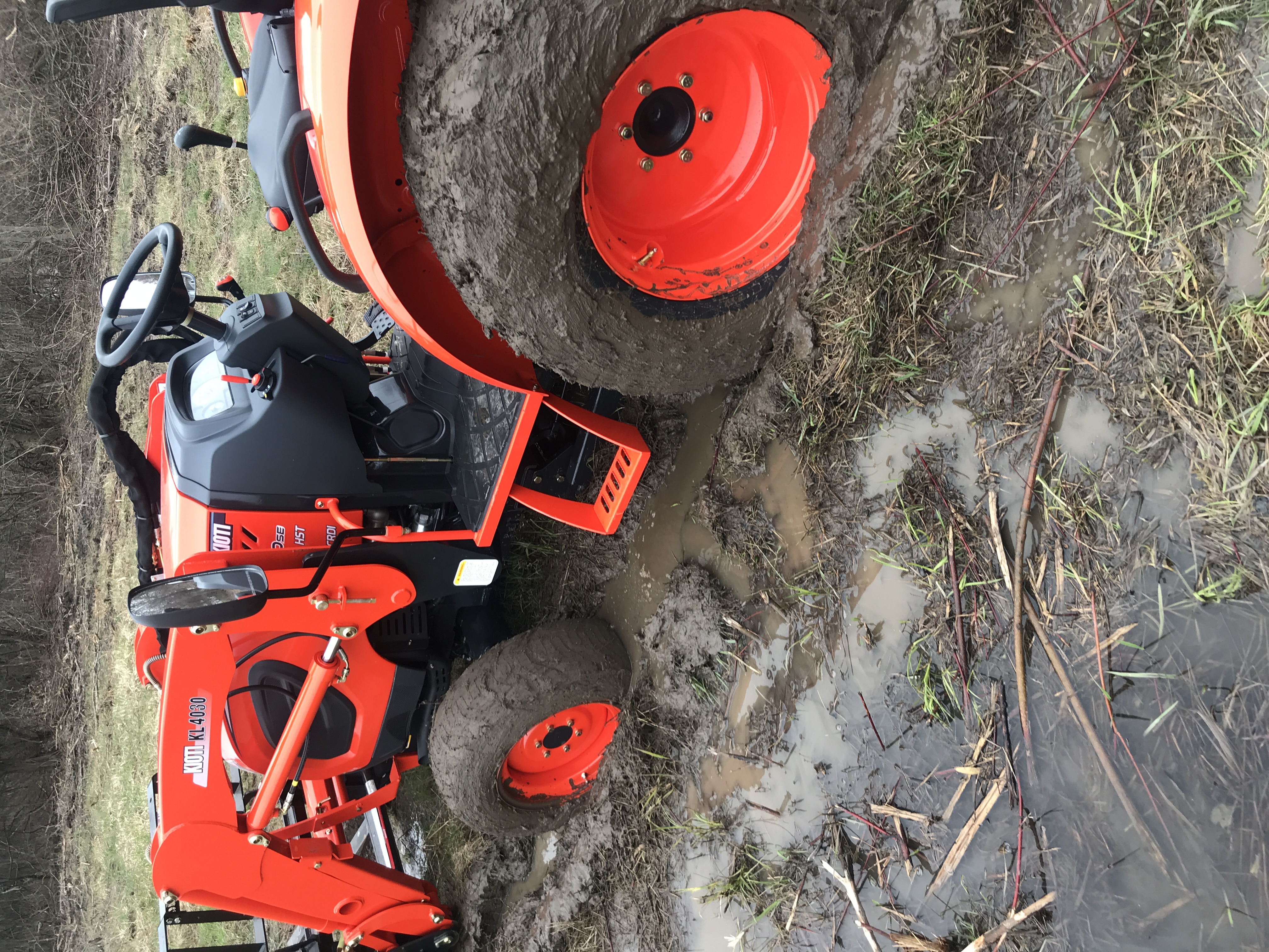

Soooooo, I received my tractor this morning (not sure how to download pictures to the forum) and I went out to my field and immediatly got stuck!!! My property was very wet and very soft (clayish) and now I need to get it unstuck. It is supposed to rain pretty much all week. So, I can't even get unstuck without immediatly getting stuck again. :confused: I am totally open for suggestions. I have the back hoe on and the forks.

57720349804__4D300F08-9053-4CB8-AB51-ABFA5EEC54C5.JPG57720349804__4D300F08-9053-4CB8-AB51-ABFA5EEC54C5.JPG57720349804__4D300F08-9053-4CB8-AB51-ABFA5EEC54C5.JPG

57720351361__32B9755D-C2B0-4202-9079-4362379CE760.JPG57720351361__32B9755D-C2B0-4202-9079-4362379CE760.JPG

I see some quality time with a pressure washer in your near future!
   / Just ordered my Kioti CK3510 #29
Raise the outriggers - won't go anywhere with them down like that! :dance1:
Seriously......if you can't "pull" yourself back a little at a time with the BH, 4WD + Diff Lock won't get you out of the soup, a real long chain/towstrap (28 lbs. Capacity 2 in. x 2 ft. Heavy Duty Tow Strap) to a truck in 4-low will do wonders. I've unstuck mine a few times with just a bunch of chains daisy-chained together then my F150 in 4-low. Just at idle, the F150 is enough extra in combination with the tractor to get it going.
Just don't get your truck stuck too and have two things to recover :)

Thank you for the advice. It rained all day today and it looks like rain for the next several days. I will let it quit raining and dry up a little before I try to get it out and get some work done. I really can't get my truck back there without certainly getting it stuck also. It is very wet, I should not have brought the tractor back there. Hopefully, I will get some pictures of the Kioti when its free at last.
