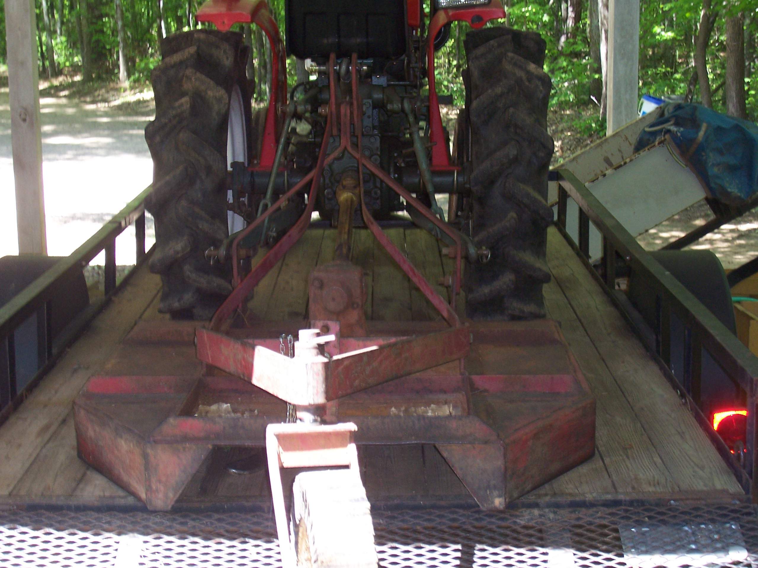

I can honestly say I have never used 2nd, gear PTO. with my BH.. I have 3. Owned it for Yrs.. It's 4' which I believe is a old International ? I call it the "Beast" which it's ruthless on my wooded property. I stay around 1500 Eng. Rpms. 1st Gear. Don't make them like it now. Many Hrs. using a 7' Frontier. I only use it once or twice a Yr.. Mostly Spring and maybe Fall storms to clean up. Never mowed grass or high weeds so I don't know how it does. Extreme leaves and branches and it's almost comical how easily it works.
