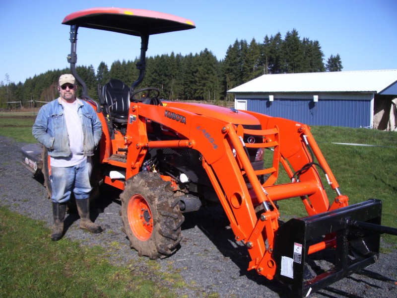

Traded my B7800 for a used L5740 with 204 hrs on the meter :D. I am feeding Haylage to my livestock now - the B7800 was not quite enough tractor to handle them. Got the L5740 with 204 hrs for same price as new L4240. Put hay spear on the front QA and was able to pickup the 1200lb round haylage bales with no issues. I have not had time to make a proper counter-weight for the 3 Pt yet, so hooked up to my 60" bushhog for weight on the back. I was able to raise the bale about a foot off the ground, cut the plastic of and pull the strings, then lift up and dump into the feeder. No more having to take a side off the feeder to load. My question is this - to handle the 1200lb round bales, what would be an adequate counter-weight to use. I plan on filling a 55-gallon drum with concrete to get proper weight, then cutting it down to proper height. Any feedback would be appreciated.

If you're picking up 1200 lbs with the loader, you should have about that weight in the rear for ballast.

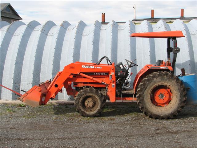

I have a 55 gallon drum filled to the top with concrete with a slot grooved out for the top link. I also have my tires filled as well. When I am carrying 1200 lbs of haylage on uneven ground it is what's required. The pic shows the spear on the bucket. I now use a quick attach and still need the weight for safety.
