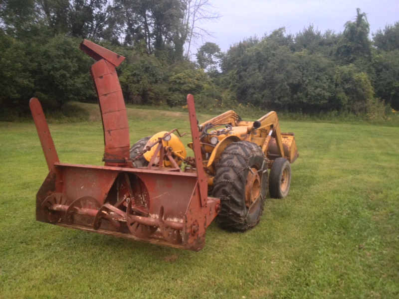

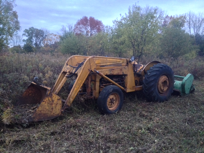

You've got yourself a good machine. The 202 is the industrial variant of the MF35. Thick, strong front axle, proper power steering (rather than steering assist), generally has 14.9x24 rear tires on it. There are other differences as well, but they're a true workhorse. I have a MF 35 Utility, which is basically a 202 that looks like a 35.
First and foremost, check the fluid level. There is a large o-ring at the bottom of the reservoir that can dry out and leak. If you find that to be the problem, send me a private message, I have a whole pack of them, I'll send ya one for free. That was the issue with mine, I'd put fluid in, and it would run right out the bottom of the reservoir.
I use Traveller's brand Universal Trans/Hydraulic fluid in the power steering, loader, and in the transmission/rear end of my machine. I like to keep the number of fluids I have onhand at a minimum, Congrats on a sweet purchase! Post up some pictures when you get it. Here's mine:

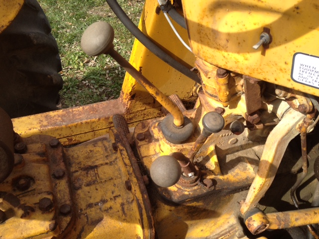

Is my Massey 202 normal.....??? I have 3 levers for the tranny. One is high range, low range. One is 1st, 2nd 3rd ... and says shuttle shift. And the third is forward, reverse.

Yep, well, you're lucky! Mine has the same setup. You will never need to put the gearshift in reverse. The shuttle shift is for reversing direction.
So a normal transmission will have hi/lo, 1,2,3 gears. You're limited ONLY to the reverse gear ratio with a normal trans.
With the shuttle shift, you can leave it in say 3rd gear low, drive the loader into a pile of dirt, press the clutch, flip the shuttle lever to reverse, and you'll be in 3rd low reverse. It's much faster for loader work or tight areas.
My 35 utility has shuttle shift, my cousin's 202 does not. The shuttle is much faster and easier.
Lastly, the levers on your trans are:
Gear shift (R,1,2,3)
Hi/lo range
Shuttle shift (basically a geared reverser)

My gear shift only has 1,2 & 3. No reverse. The forward and reverse is in the shuttle lever.

Same premise applies, you'll have 3 reverse gears in high range, and 3 reverse gears in low range. Much easier, much faster, overall better than a machine without shuttle shift.
Sounds like you're off to a good start!
Edit: I've added a pic of my shifters. Mine has R-1-2-3 in an H pattern, plus the two other shifters (hi/lo, and shuttle F/R) The shuttle shifter is supposed to be attached via linkage that goes up to the left side of the steering wheel, but mine's long gone and has a small shifter in it's place.
