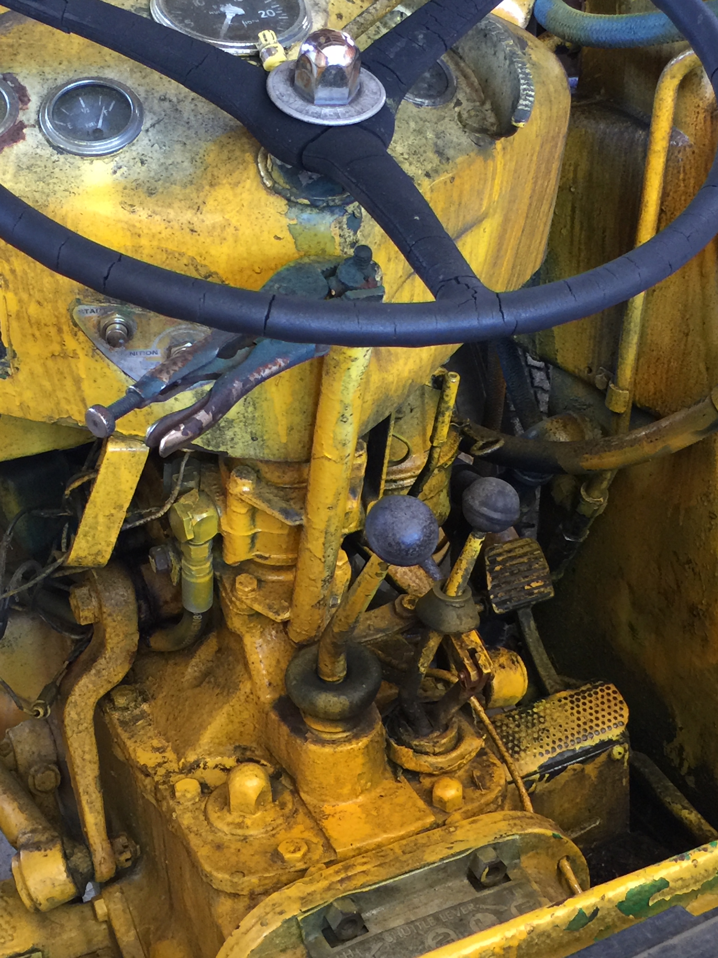

You're getting along just fine, nice work. I have a manual around somewhere, but I do know it should be 12v negative ground. Weird that it's not set up that way.
You're lucky, you've still got the shifter linkage for the shuttle under the steering wheel, mine's gone, hence the three shift knobs on the transmission on my 35.

I have looked into purchasing the 2 new boots. But each boot is different. The one on the left side is for the speed range and is readily available as it covers only one lever.
The right side boot needs to cover two levers which is the shuttle lever and the high / low range lever. I can not find this boot.

I will look when I get home, I have the part number for the boot you're looking for. It's expensive but well with it.
   / Just purchased a 1963 Massey Ferguson 202 with... #31
Here ya go:
190697M1
I got mine from my local AGCO dealer, but if you put that part number into google there are a number of different places you can get it. Tip- a touch of grease on the shifters helps install the boots easier.
