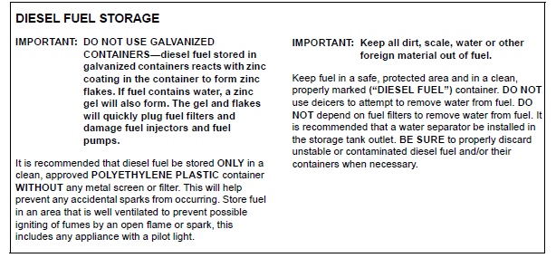

I thought you could not use a galvanized can to store diesel fuel in?
   / Justrite 5gal cans for $46 on Amazon #3
   / Justrite 5gal cans for $46 on Amazon #4
Where did you get that idea?
Galvanizing done with zinc, diesel has sulfur in it, sulfur reacts with zinc, banned in California, zinc sulfide labeled a carcinogen if you drink 2 gals or more a day of diesel fuel while taking anti-acids. Next question ?

Actually the diesel dissolves the zinc coating, and it ends up clogging fuel filters and trashing your injectors. I do use a galvanized funnel just to pour the diesel into the tractors, but I would not store diesel in a galvanized tank or can. My new favorites are the NoSpill cans with push button control. I have seen them in red, blue, and yellow.

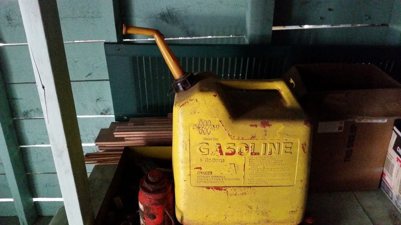

I like the longevity of these cheapo gas cans with nothing to break off. I had and still have about 8 of them for 30 years and are still going strong. Anything with fancy nozzles that I owned last about a year and then can't get the nozzles. The only thing that breaks on these is the plastic tab that hold the tip to the spout, but a hose clamp keeps them attached nicely.

From my JD manual:
