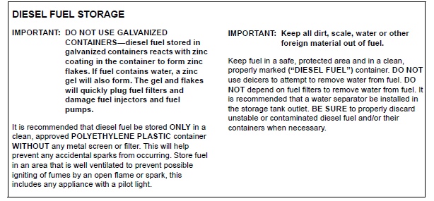

In california they are snowflakes. Everywhere else but Florida they are zinc flakes. There they are called sink flakes.
   / Justrite 5gal cans for $46 on Amazon #13
I also ran into problems in the mid 80s with the first introduction of E10 gasoline. I was repairing Volvo automobiles for a living back then and they had galvanized gas tanks. The ethanol was dissolving the galvanized coating and clogging the filters and injectors. I began draining every fuel filter I removed during a tune up to check for the use of E10. The fuel would come out of the filter silver in color and after sitting a few hours it would settle out as clear gas on top with the dissolved coating in the bottom.

Actually the diesel dissolves the zinc coating, and it ends up clogging fuel filters and trashing your injectors. I do use a galvanized funnel just to pour the diesel into the tractors, but I would not store diesel in a galvanized tank or can. My new favorites are the NoSpill cans with push button control. I have seen them in red, blue, and yellow.
