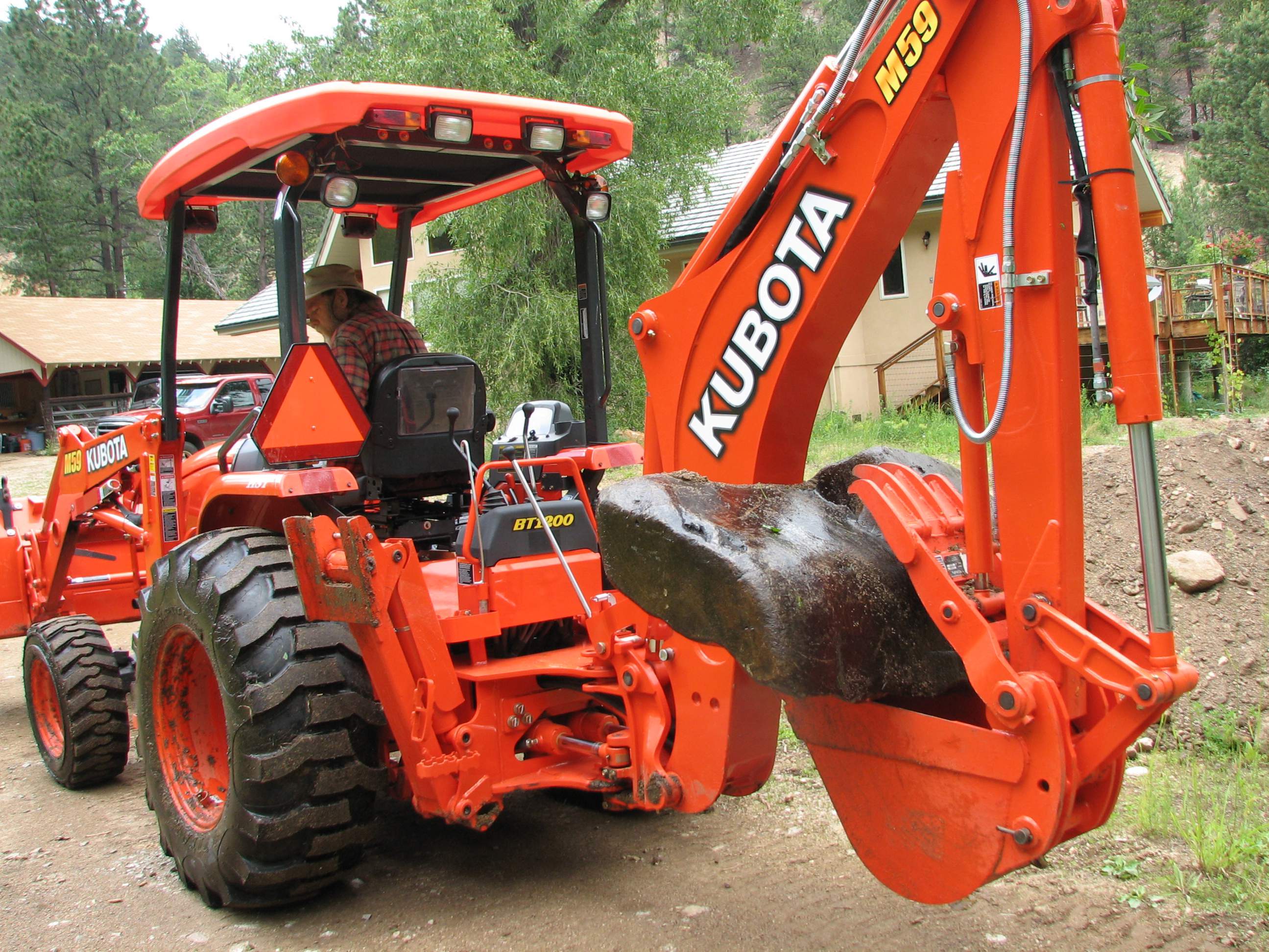

As I read the specs versus the BH77 Kubota backhoe it seems to me that the Woods comes out a little better all around.....but of course it isn't really matched to any one tractor. Grandad4 has a good thought....the only way you will really know is to try them both - or at least look at them in the flesh. And all we can do here on line is compare specs and point out things to look for. Things like frame-mounting pins versus bolts, QA versus solid mount buckets. And the all-important thumb.
When I was looking at several makes of new tractor/loader/backhoe combos we tried everything in a 100 mile radius. It took all summer. The decision when we made it was based on things I would have never thought of nor seen in the specs. There was a major difference in the feel of the controls, getting on & off the tractor, and the seating position while using the backhoe. Other things that made a difference were how it balanced and drove with the loader bucket full & empty and also with a load in the BH bucket. All in all, I think what finally sold me was Kubota's seating and delicate controls.....not at all what I expected going in and just about impossible to compare without being on the machine.
luck, rScotty
