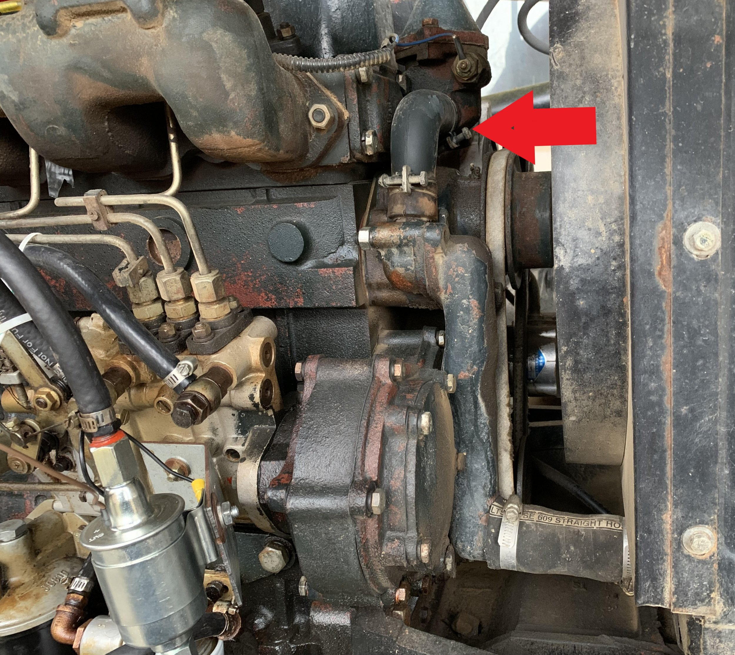

   / KAMA 454 block heater
Bob,
From RonMar I found on Tractorbynet;
"Because of the space limitations on the lower radiator hose this might be easier to install. It looks like it could be connected between the block drain on the left rear of the engine block and a "T" placed in the small recirc hose line that runs between the waterpump intake and the bottom of the thermostat housing. This would circulate warm water through the engine block. I used one on a 4 cylinder Toyota in Alaska. I think it was 450 Watt and it would warm up the engine fairly quickly. They are also not very expensive."
The photo is my KAMA. My lower radiator hose is about level with the block drain. I read that for these circulating heaters to work, they need a low an high attachments. Do you think where the red arrow would work as the high point using the "Tee" adapter?
The KAMA does not have glow plugs.
in the lower left, you can see the new electric fuel pump
   / KAMA 454 block heater #7
I'm skeptical of where that red arrow points to. I think it would basically just heat the radiator after the thermostat opens, bypassing the engine altogether. It should still work going to the block drain even though the difference is slight. Looks like there is room in the lower hose for that tap, although you may have to move the radiator to install it. I would still consider installing one of those manifold heaters over using a propane torch.
Nice job on the electric fuel pump!
