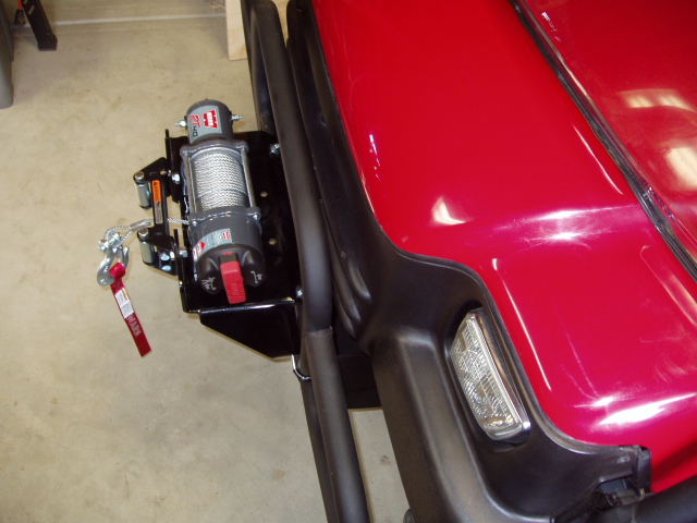

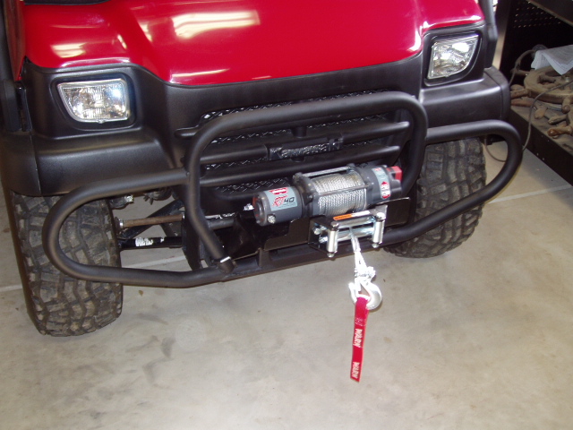

I hope my winch plate setup works better than that as it gives full working exposure to the Warn RT40. In the photos, the winch and fairlead are bolted in place but with no wiring, etc.
Can you tell me where your remote control plug-in is mounted (I have a couple of areas on the winch plate to do this but none are drilled and will require a 3/4" hole-thinking maybe some other place on the body?), where your contactor is mounted and how did you route the whole wiring harness?

We are a Kawasaki dealer; on the 3010 we mount the contactor under the seat near the battery and route the wiring along the centre of the unit. There is a checkerplate plate that can be easily removed from the floor of the unit to route the wire (we run it from the winch to the contactor in plastic loom) Kawasaki offers a bracket to mount the toggle switch on the steering colum and we like to mount the recepticle for the remote control in the left "Glove box". We put the remote control in the glovebox and yes you may have to remove something from the glove box to use the remote but we find most of our customers use the toggle more than the remote and this puts the plug out of the weather and mud. Hope it helps.

What weight wire do you run from the battery to the winch? Thanks
