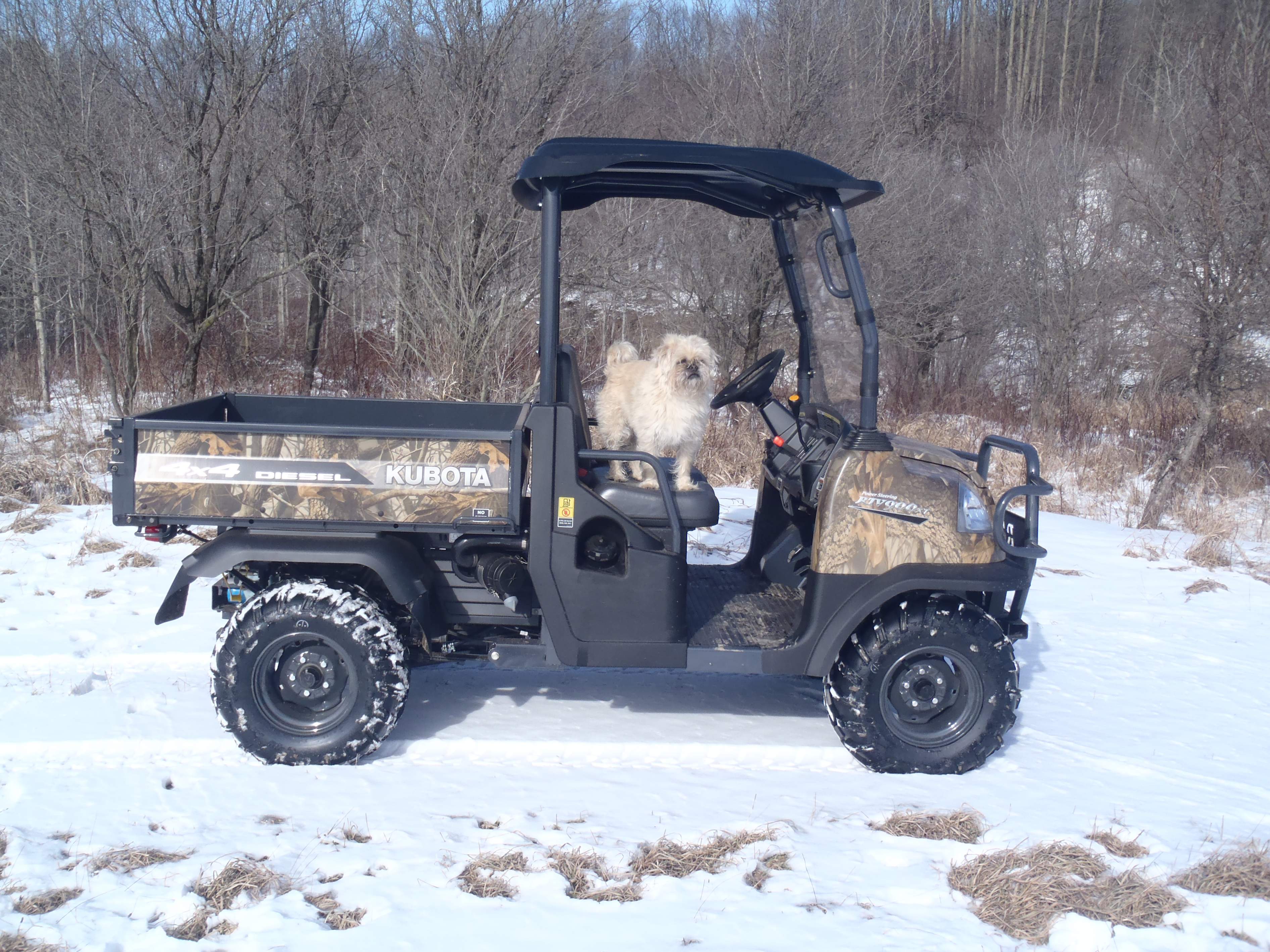

My new RTV900XT arrived Monday. I love the thing, but have one complaint, too much noise! Is their any way to reduce the sound level? I did install a heavy rubber mat in the box, but little improvement.
