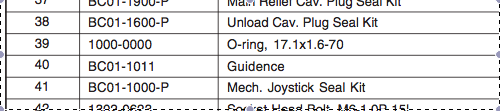

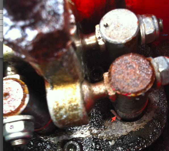

After not using my backhoe for the past year, this week I was ready to start a major trenching project. Finally, got the hoe mounted and about the 3rd attempt to scoop some dirt all H broke loose - hydraulic fluid.
Appears that some sort of plastic/nylon piece broke in the Boom portion of the control valve. You can see it at end of red arrow.

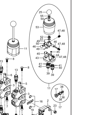

Judging from the exploded parts manual, I'm guessing it is item #40 - Guidence. So I have ordered replacement and new O rings.
If any words of wisdom out there, I'd be appreciative. I haven't disassembled anything yet, most likely Sunday.

That nylon ring is a support for the rubber o-ring seal which apparently cracked and let the seal go and the fluid fly. A few years ago, I had to completely remove the entire valve unit from the bh and then split the six blocks apart to replace one of the center blocks that worked a stabilyzer. My replacement was each individual part to make up the complete block. Not that bad once you see what's all there. You should be able to replace the seals without removing the entire valve unit but you may be a little cramped for room. You'll have to remove the hand control that works those two end valves by removing the two nuts and then the studs from the tops of the spools. Then the top plate held on by those allen head bolts which will give you access to the seals which sit in a counterbore in the valve. By the picture, it appears that rust on the spool was the cause of the seals letting lose. I would remove the spool and clean all the rust off the top. Polish it with some fine, 600 or finer grit, emery cloth or wet sandpaper for vehicle paint sanding works good also. You might be able to clean the top of the spool without removing it, just make sure you keep everything clean. If the spool has larger rust pits in it, you'll probably need a new one because it either won't seal good or will tear up the new seals after some use. To get the spool out, if needed, you will have to take off the 1" x 1 1/2" or so matching cap/cup off the bottom of the valve block to release the spool from the valve block. It's not that complicated and rather a simple design once you see things. Just remember to keep things as clean as possible.

The spool is the same diameter its entire length except for the grooves that regulate the fluid flow and it could come out either end. What holds it in place is a spring, washer, and small bolt in it's bottom end which are all contained in the aluminum cup at the bottom of the valve block. This spring is what returns the spool to it's center position. If you wanted to remove the spool, you have to remove the cup. By that point, it's easier to just let it drop through the bottom. If you wanted it to come out the top, you'd have to find a way to hold the spool from turning while you removed the bolt along with the spring. I'd just let it drop down through and reinstall from the bottom. With all the hoses connected, finding room for the hands will be a pita. You might have to remove a few to get some working room.
The spool should have been sitting in its neutral or center position when it became a little rusted. When working the control, the spool is either pulled up through the block a little or pushed farther down into the block. I'd bet the rust was right up to the seal and when you made the spool go farther into the block, it tore up the seal. Wait until you see how small the seals are and you'll see why they need the nylon ring as a back up and wiper ring. It wouldn't take to much to damage them and the 2000+psi hyd fluid would just blow the nylon ring out as you see in your picture.

The spool actually looks pretty good, just some rust on the top, unpolished area. I do have some 1500 cloth I will clean it with. Parts should arrive sometime tomorrow so maybe I'll drop the cup and pull the spool to be ready. I didn't want to do it to far ahead.
David
/ KB2375 control valve
#14
Wow, maybe 10 minutes to get the spool out, replace the seals and O ring and reassemble!!
