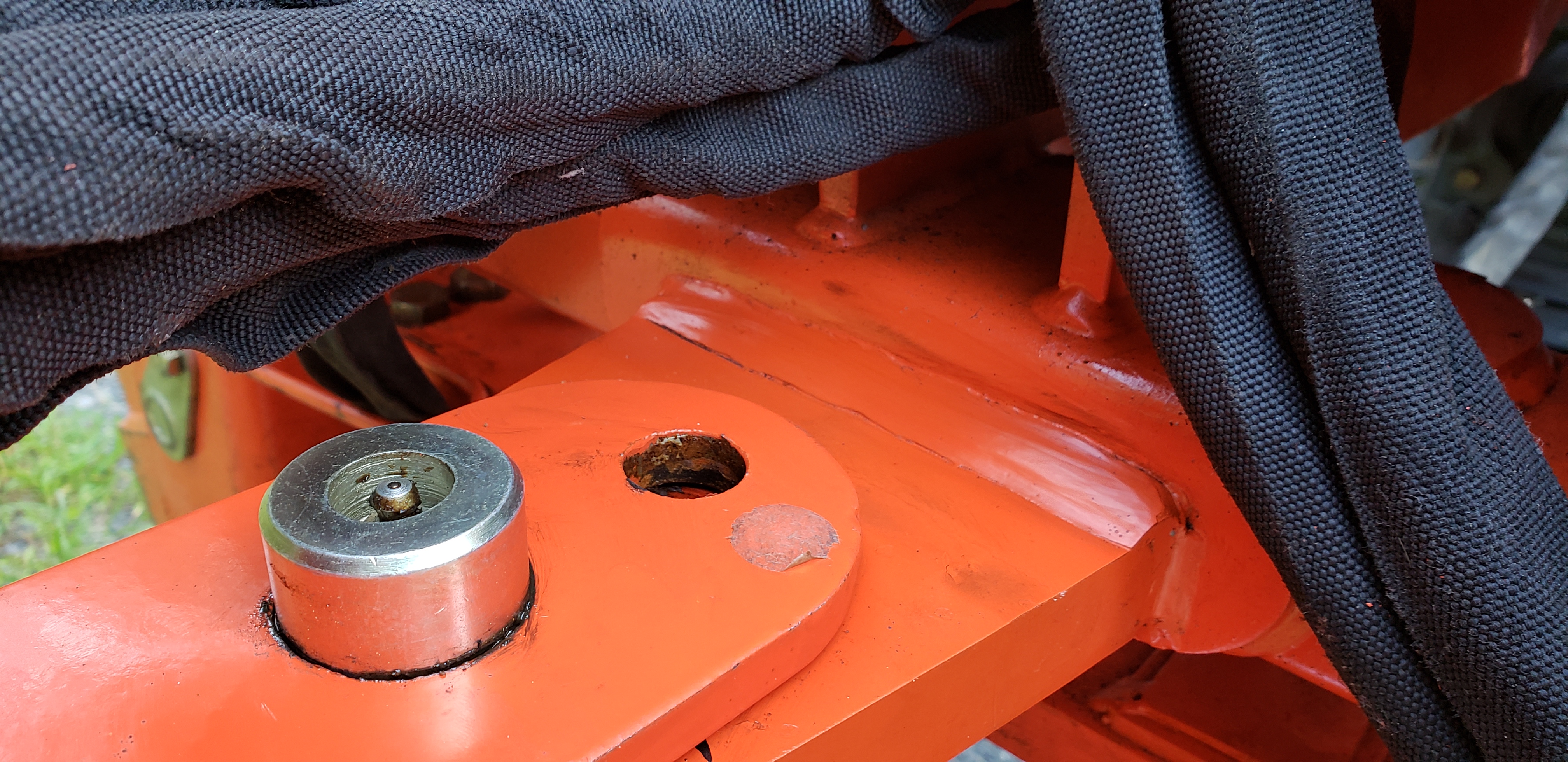

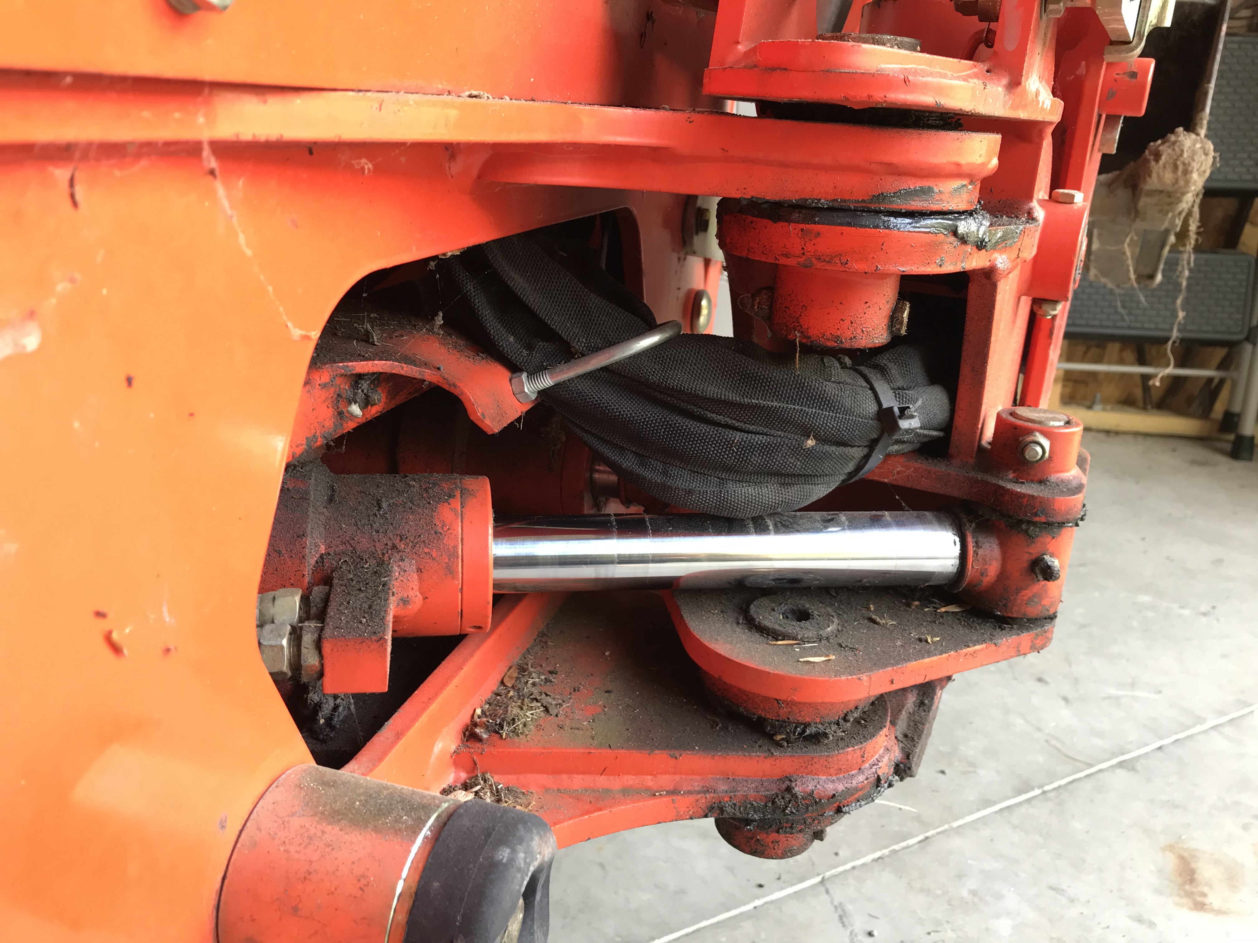

TD100 Hydraulic hoses are to the outside, the cylinder is the one with the welded collar and pivot studs. I pulled a pin and the boom rotates completely to the outrigger, pin still disconnected opposite swing piston fully extended only moves 20 degrees.

Whilst the rod is disconnected, extend the rod with hydraulics to full extension and take picture and measure full extension and full retraction. Do it where it is, as pictured now, just fully extend from there, leaving the boom where it is. Same for retract. Be careful, the boom will want to swing, especially as soon as the disconnected cylinder comes to its stop when retracted fully.
The specs I previously gave are for a later (revised) cylinder than yours, they may be the same, or not. It's just what is listed in the manual. From the picture it appears a stroke of ~9" would be sufficient, plus the rod eye to make it up to approx 11" from cylinder end to rod pin center. However if the rod can go back into the cylinder when disconnected another inch, it may not be enough stroke. Pics and measure will confirm.

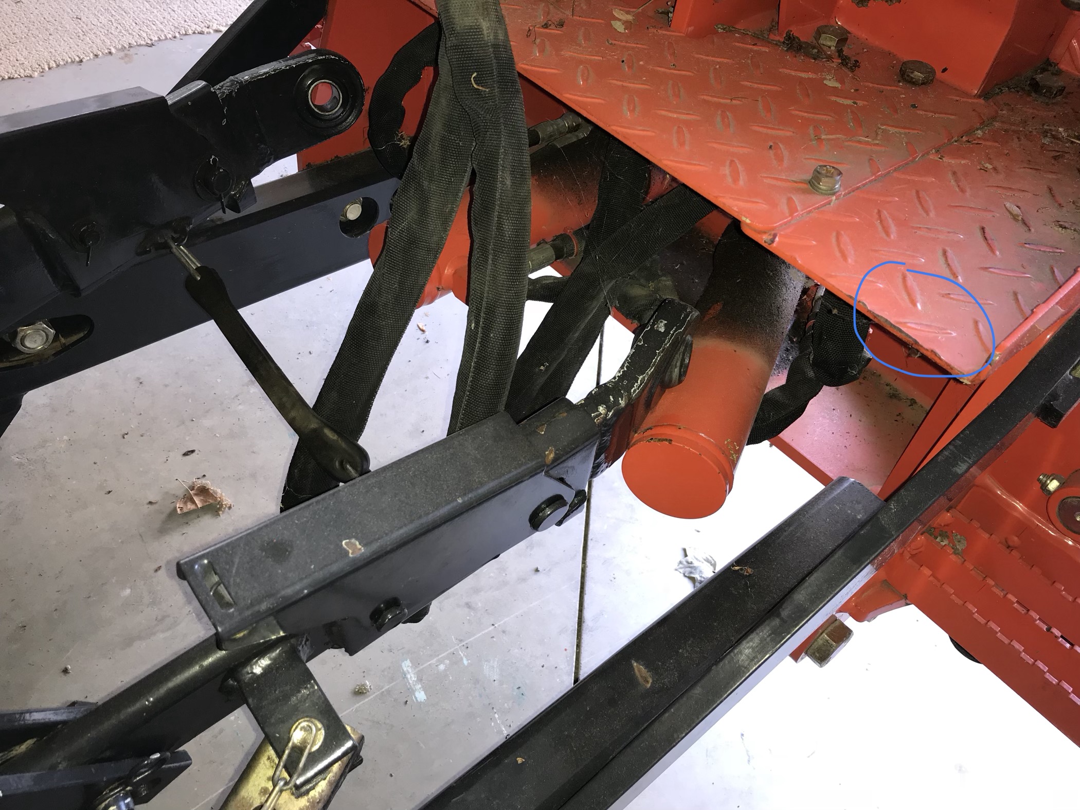

I have a KB2475 hoe. When I mount it, I usually land the 3pt on top of the platform in the blue circle, this time I didn’t. Following this thread I went out to look at my unit and noticed the back of the swing cylinder is hitting the 3pt arm. I raised the arms a little and locked out the MLS valve. All good now.
Make sure there isn’t anything hitting the back of the cylinder, stopping it from moving through its full intended arc.

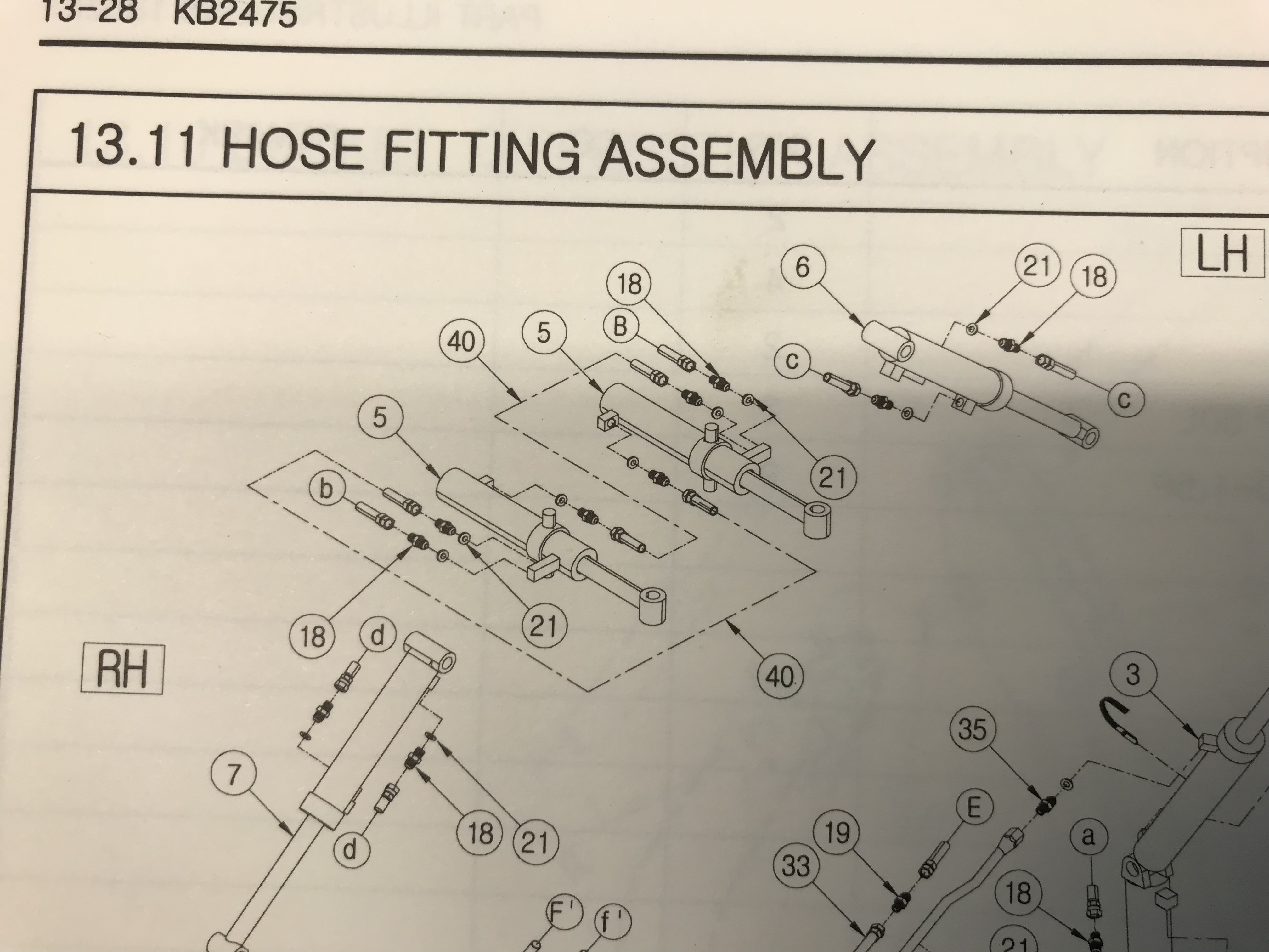

Are the cylinders plumbed correctly? I added a pic showing how the two cylinders should be plumbed.

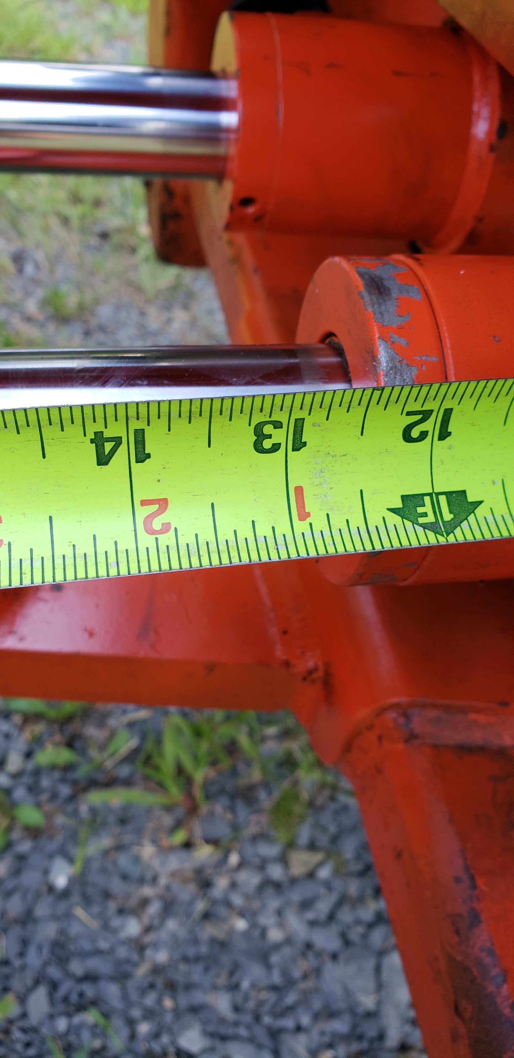

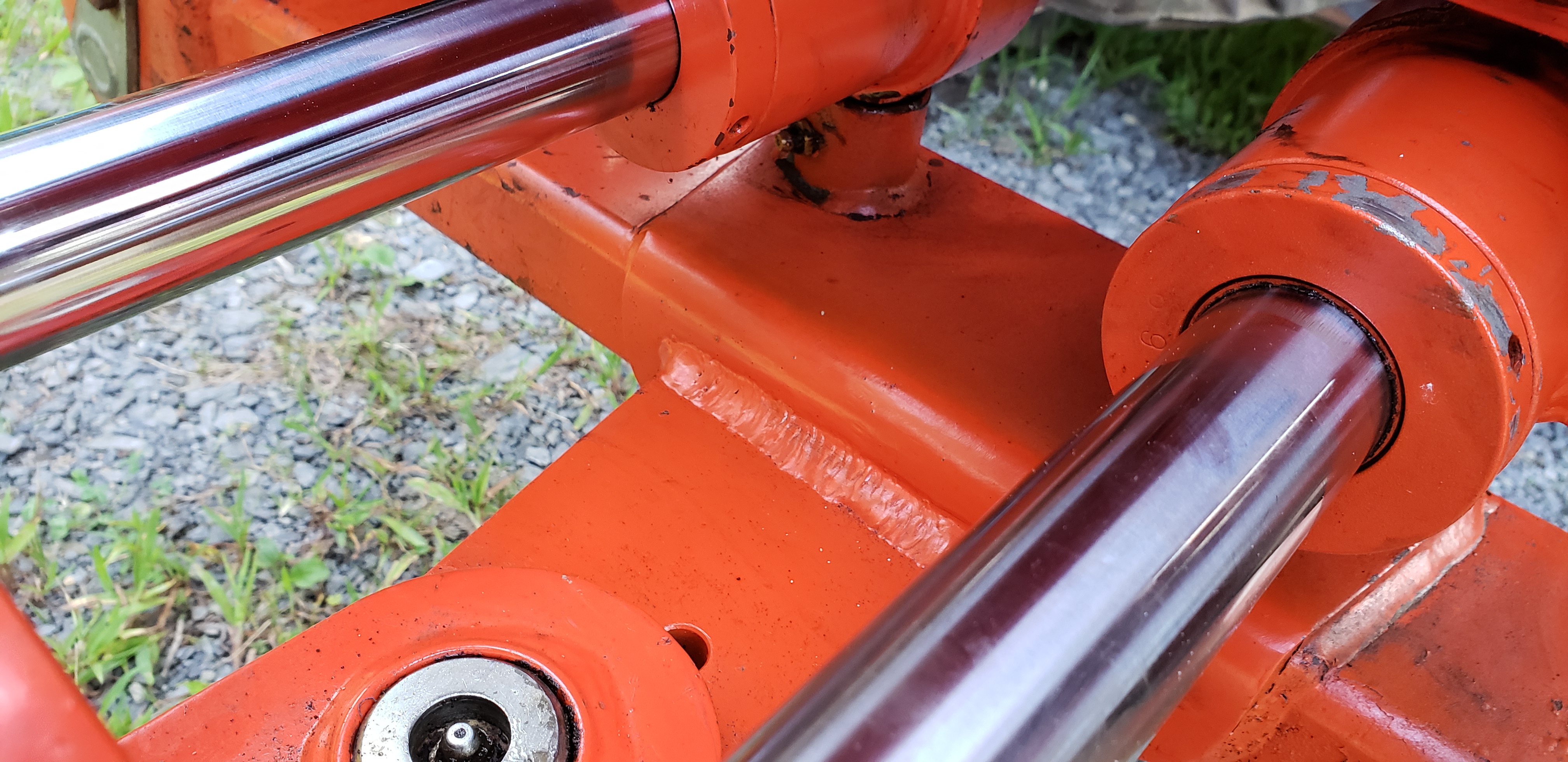

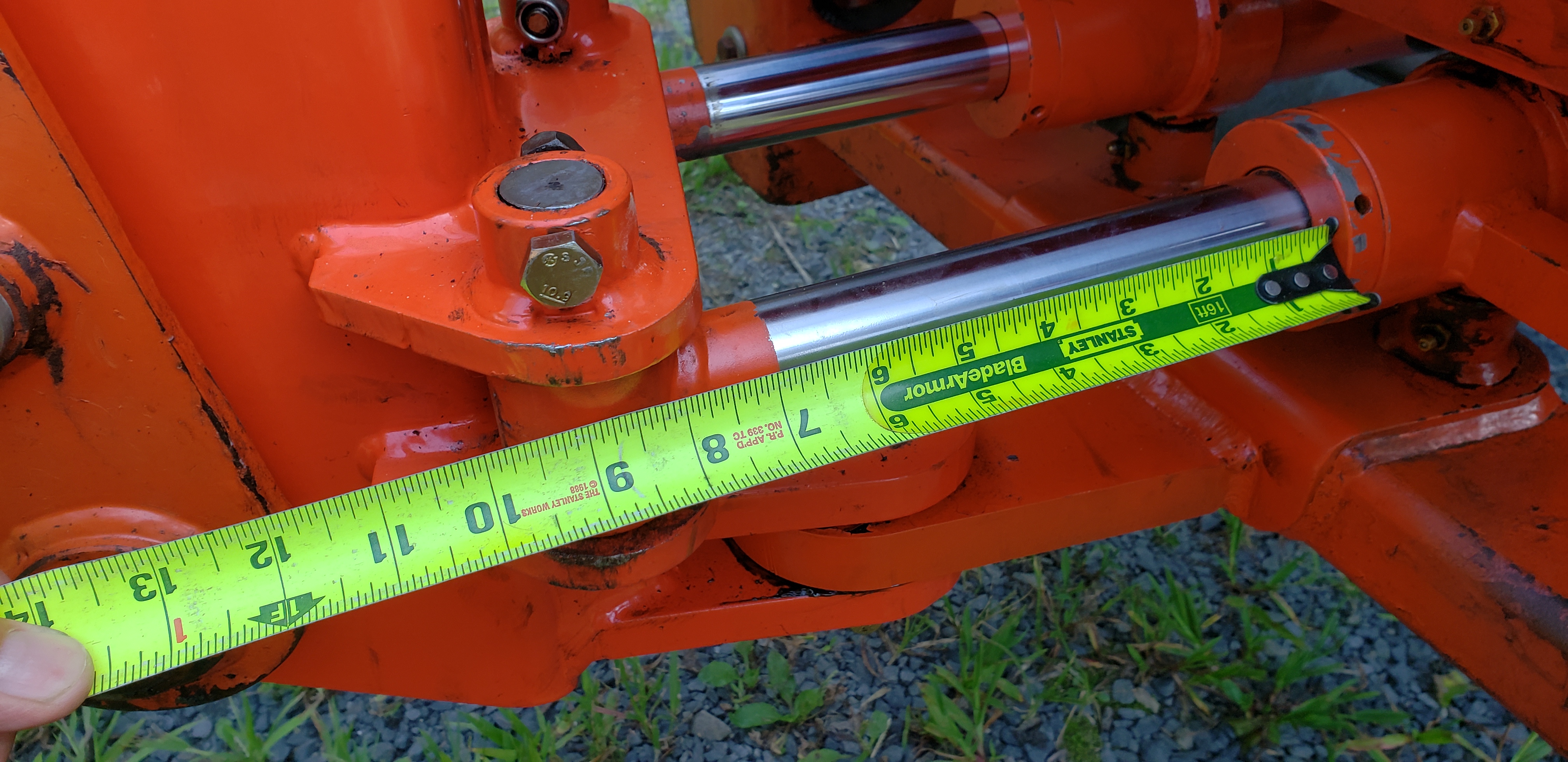

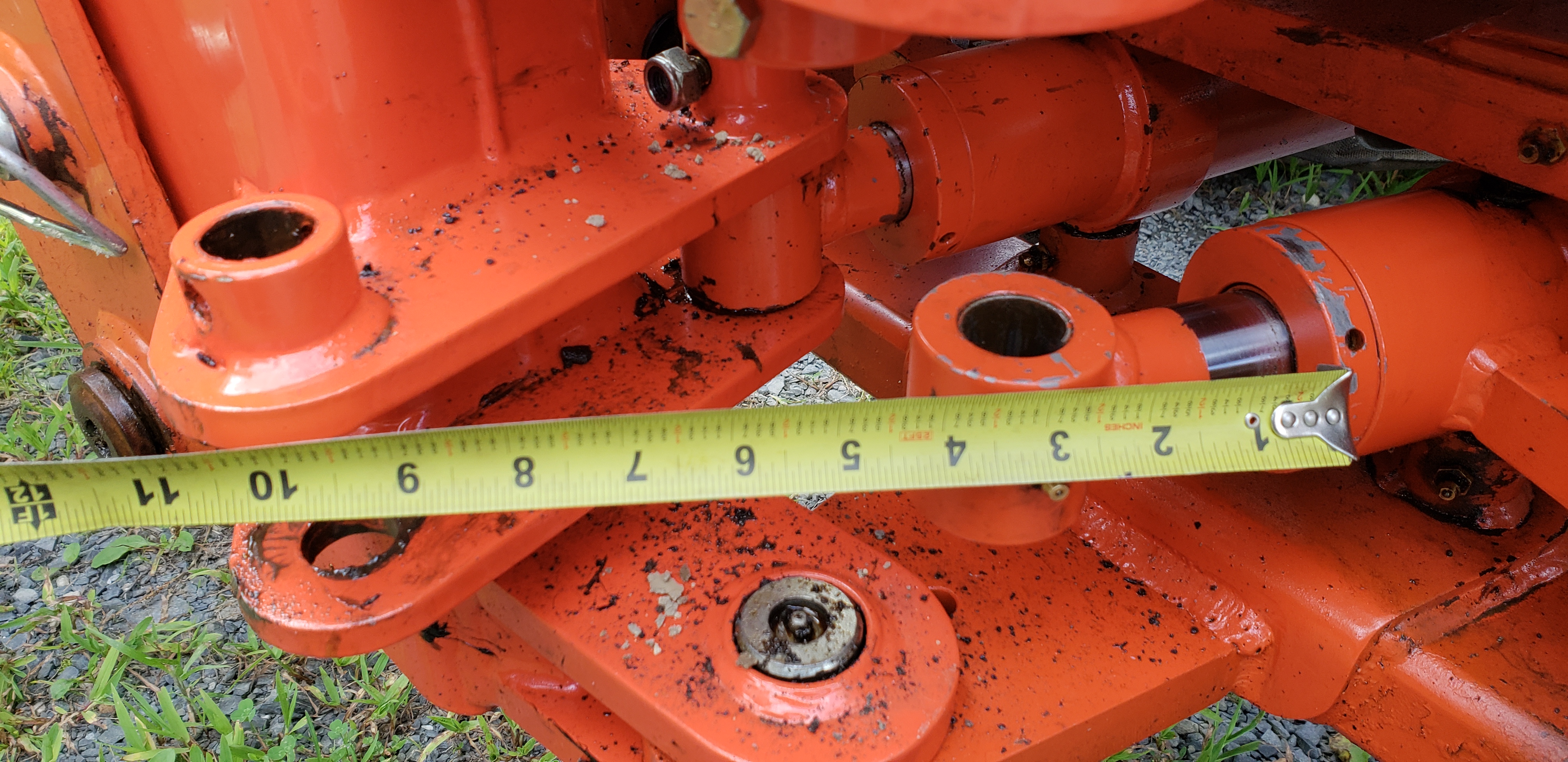

100td The pictures indicate the fully extended piston -same disconnected or not.please note the welds on the trunion pivot. these parts appear to be welded at the same time the trunion was replaced.The cylinder measures approx 12" any ideas?

It appears the trunion mounts are original, it appears the top swing pivot has been welded/ground, it appears the bottom swing pivot may be original?
What do you think from looking up close, is the bottom swing pivot original? Is it possible new swing pivit plates were installed and they were made a bit longer?
Measure the distance from the center of the swing pivot pin to the boss of the trunion mount, and see if Amncane can do the same.
12" cylinder with 2"end cap and 2" piston allows for maximum 8" stroke, what stroke length have you measured after pushing piston all the way back? I can see from the pic about 7" but haven't seen full retraction.
I think the critical measurement you need to confirm is the pivot point, but if that is correct, then cylinders are the issue.
