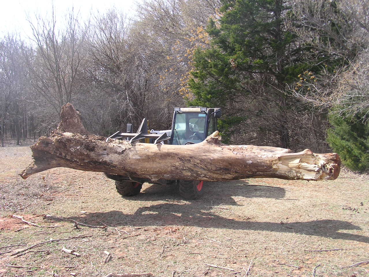

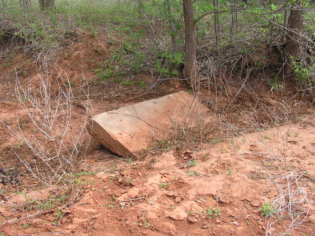

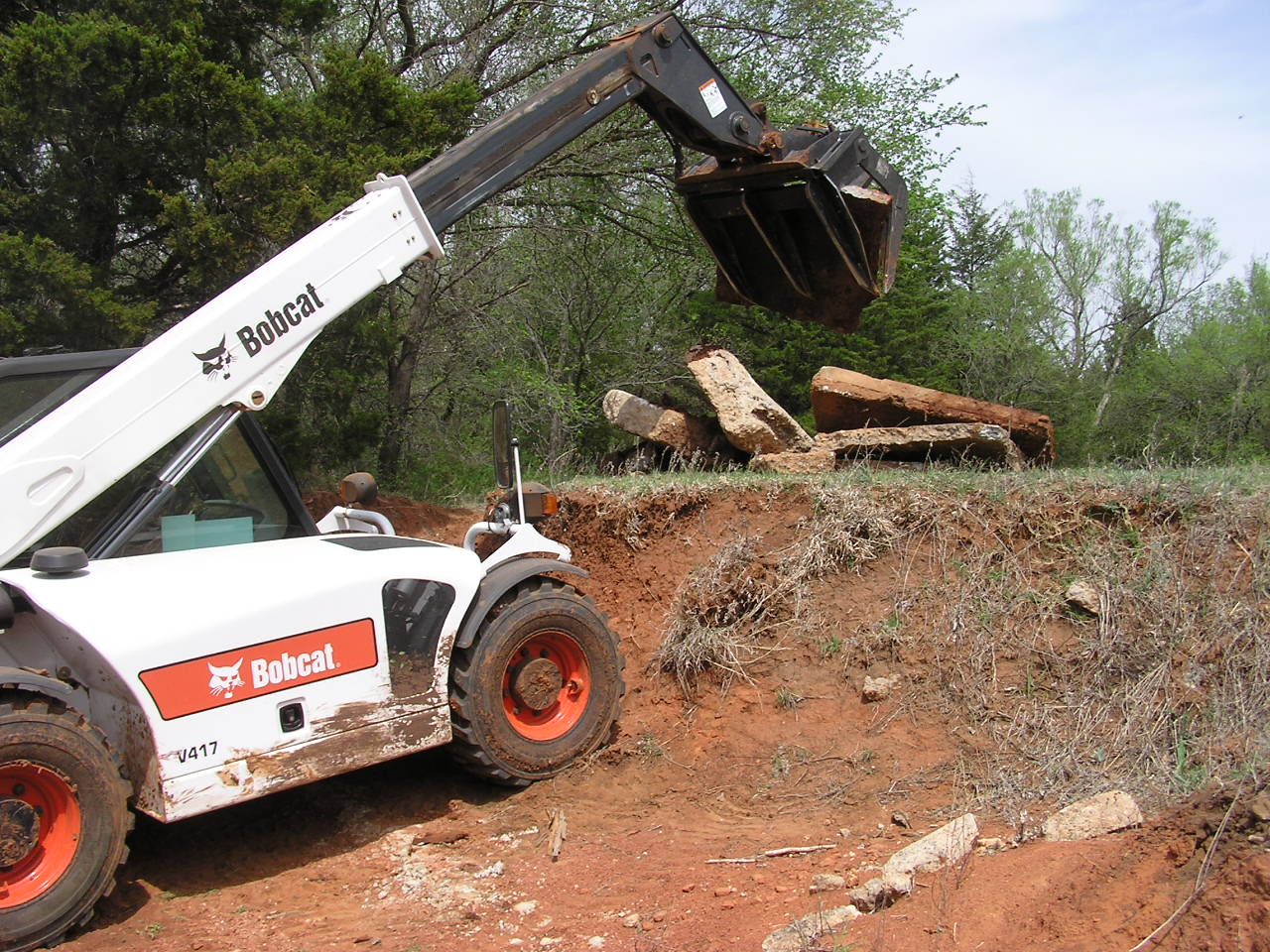

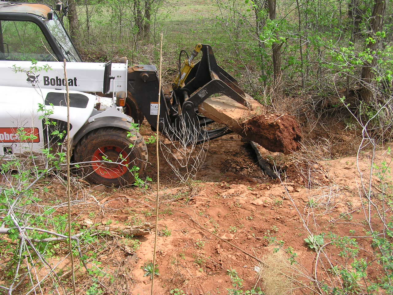

I think with two cylinders on the single lid, the force at the pins from the cylinders would be the same as if it had one cylinder. The cylinders are in parallel, so the pressure is the same in each one. Any force transferred back through the lid would still be the same in each cylinder.
I have had the Six Tine version since January 2011. It has pins with grease zerks, guess I need to check for slop. :eek:
It will break concrete! Squeezed too hard.
This is the other half, notice the fresh break.
Here is a lot of force on one upper tine.
It has never broken a pin.
