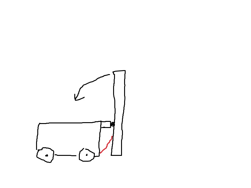

I spent a lot of time looking at this before I designed it and really the cylinder is in the only practical location. I might be able to change it up and get a few inches (maybe 4") shorter but nothing drastic.
   / Keeping a cylinder from bending
#12
Here is a rough sketch of the design.

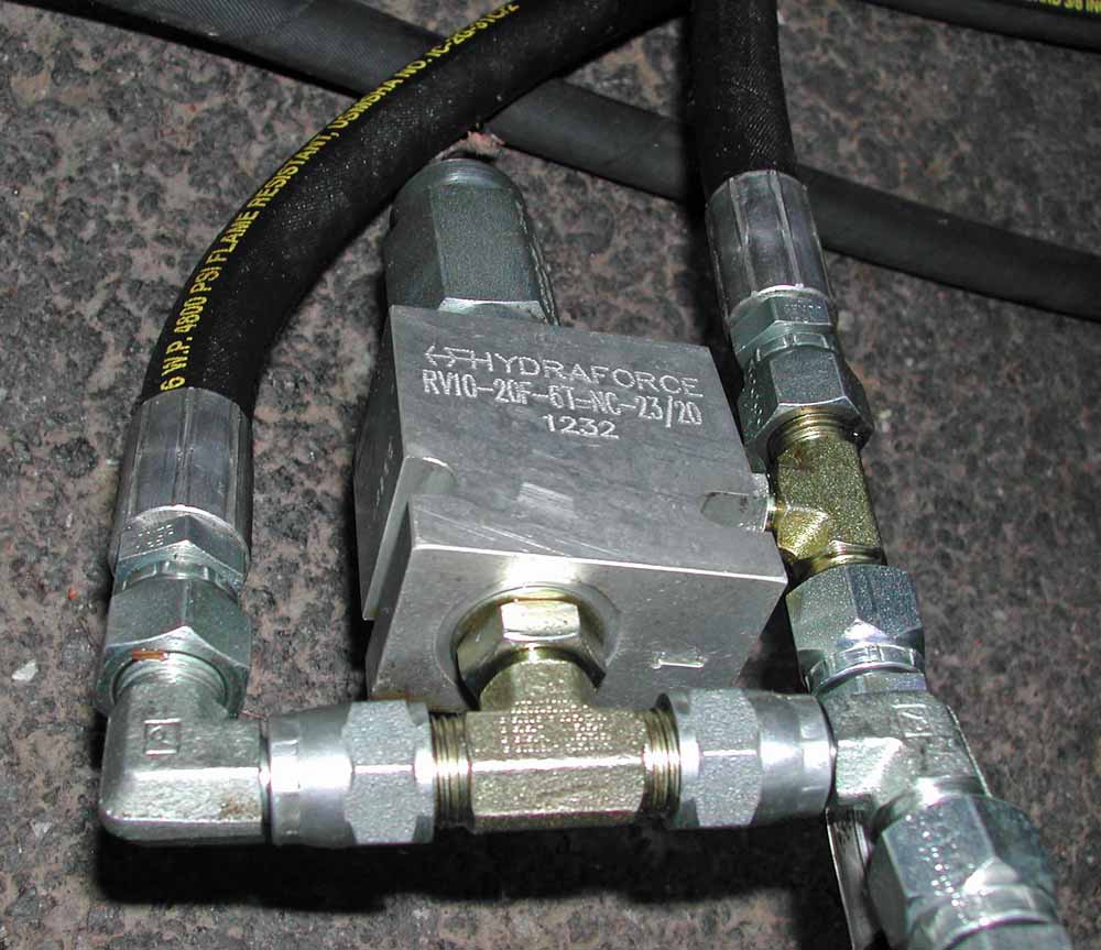

The cylinder did not contact anything. I am interested in regulating the pressure to this cylinder only, but not the main relief as I have other cylinders and motors that need full pressure.
Sounds like you need a pressure relief valve such as those found at: Surplus Center installed on just on that cylinder
Aaron Z
   / Keeping a cylinder from bending #14
If you install a pressure reg, I believe you will have to add a return line.
Pressure into the regulator, pressure out to the cylinder, and a return line to dump excessive pressure when the relief opens.

This may be problem. This is on a skid steer and I am not really sure where to connect the return line. I know return to "tank" but the skid steer does not have a tank connection that I am aware of. I am just working off the quick connects
   / Keeping a cylinder from bending #17
It depends on the valve. Assuming that this is a custom machine, I would install the valve right after the valve block and tee into the "tank" line for the return line from the valve (vs installing it right at the cylinder).
Edit:
Being as this is going on a skidsteer without a tank line, the following valves should work inline between the valve and the cylinder without needing a tank line.
HOWEVER, due to the difference in volume between the base and rod sides of the cylinder, they will be limited in their usefulness when your control valve is closed (ie: they should keep you from using the hydraulics to bend the rod, but wont do much to protect it from pressure spikes if it bounces around while traveling):
