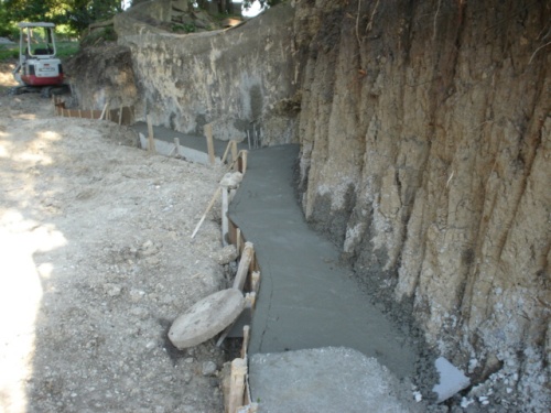

The rest of it went into beam.

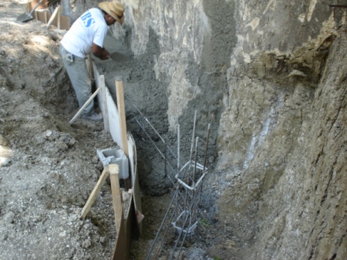

There's over four yards in this short section of beam by the old spillway.

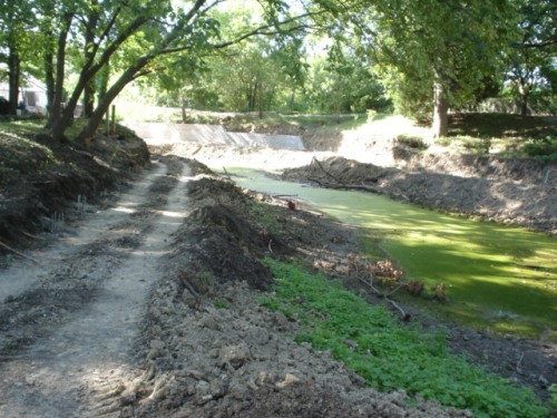

This is from the area of the new spillway looking back to where the emphasis of our work has been up to this time.
We have eighteen new piers in. There's an additional seventeen to go. The piers are in ten foot spacing.
First we cut the road. Then we're placing the piers. After that we're cutting in and pouring the beam. Once the beam's done then hopefully we'll build the cinder block wall.
The fancy rock work will go on the last two feet of the wall. Then there's four hundred feet or so of coping we have to place on top of the wall.
We're also facing the reality that our normal rains come in about three weeks. Once they're here the pond will fill up.
It could get interesting.

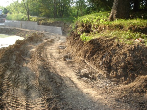

We've only got two more piers to drill that I know about at this time. Those are the ones for the landings or decks we want out over the water. Instead of using Bois d Arc posts for supporting the landings we're going to pour a pier and have a two foot concrete column.
There was a moment of excitement yesterday morning. I'd come up with an auger full of clay when the bank started to give. I froze. Iris did likewise.
We tied off to a tree and using a come along we assisted Iris in finding tierra a little more firma. This morning one of the things on my list is to rework the cut in some places because I have many more trips down the cut. And we don't want to have to call Betsy for help again.
Here's a shot of the cut and the bank wanting to sink.
