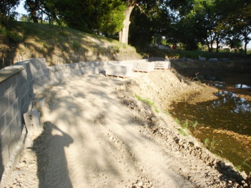

#301
The final four courses will be eights but for most of it we'll have five courses of twelves, darn, did I mention those puppies are heavy?

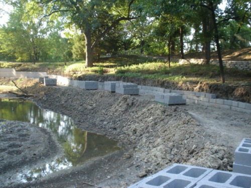

#302
What is interesting is spinning Iris around, doing a one eighty, on the trail. It's less disconcerting than backing out.

Yesterday we wheeled the wall and footer. Our perimeter is almost six hundred feet.
It is a large project when you stand back and try to take it all in. I look at it as a group of projects.
