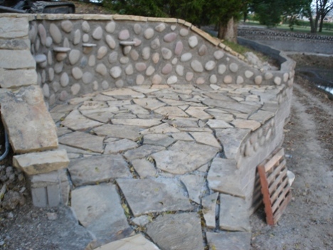

They finished laying the flagstone floor, well laying the flagstone, at the north side terrace-patio-grotto.
We'll mix a colored mortar to do all the coping and the deck in the north side whatever all at once. That way we can be assured of having a color match, hopefully.

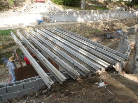

Here's a shot of the aluminum beams we'll be using to hold the rock deck.
This is definately one of those "use whatcha got" scenarios. Client had the I beams and volunteered to let me use them. I don't think he meant for me to use so many though. /forums/images/graemlins/grin.gif

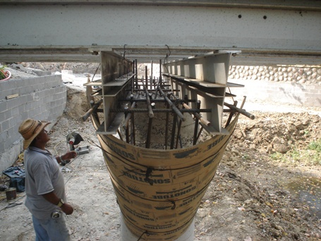

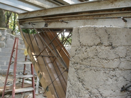

Here's a picture of the rebar work for the supports for the beams off of the column.

A more detailed view.

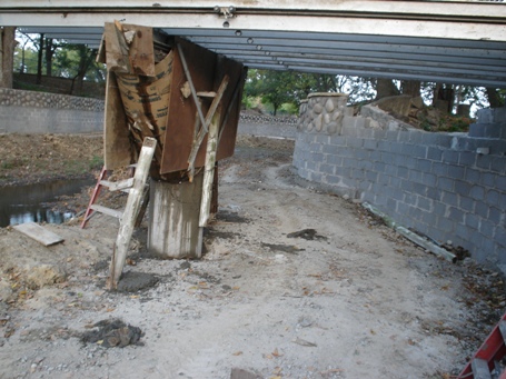

This is what it looked like after we poured.
It isn't pretty.
But beauty is only skin deep they say.
