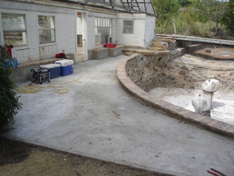

And no, the job isn't done. /forums/images/graemlins/blush.gif
But one of the last things we did last week was concrete in the old space between the greenhouse and the old wall.

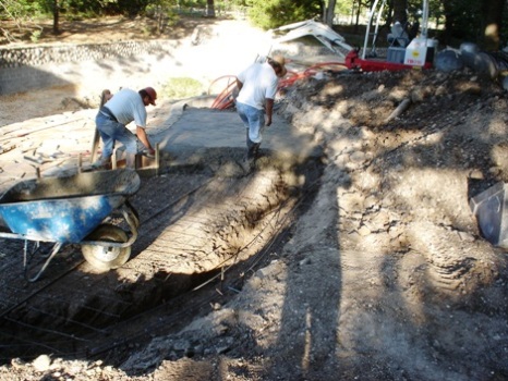

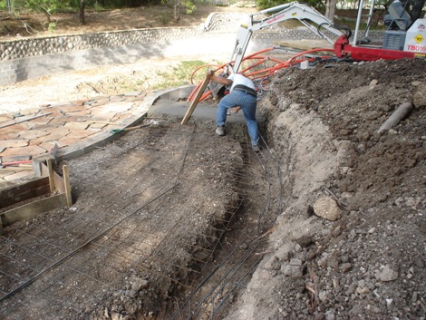

It was drizzling this morning when we started. But it turned out to be a great day for working. We decided to go ahead and excavate and pour the upper terrace of the double terrace on the south side.
   / Keeping character, or restoring a pond
#435
As you can see, we use entirely too much concrete. /forums/images/graemlins/blush.gif

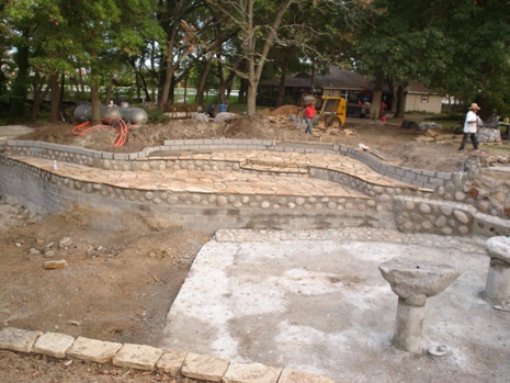

This started out as a single terrace or patio. Then it evolved into a double terrace-patio.
Circumstances requested a modification. She did it ever so politely, but firmly. Facing and either or we decided to accomodate her.
This will now become a tri-deckta.

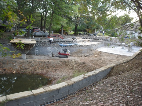

#439

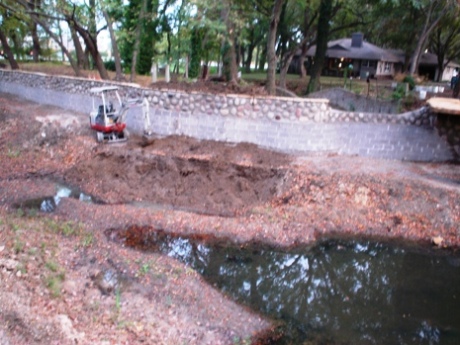

I know it seems a little lite in the britches for such a stretch but that Takeuchi with only sixteen horsepower does a fine job of transfering road tailings up and over the wall to become topsoil fill.
It is a fine tractor. It'll do a lot more than you'd think and moving it over uneven terrain is better than a shot in the dark for your blood pressure.

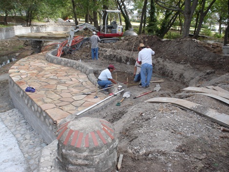

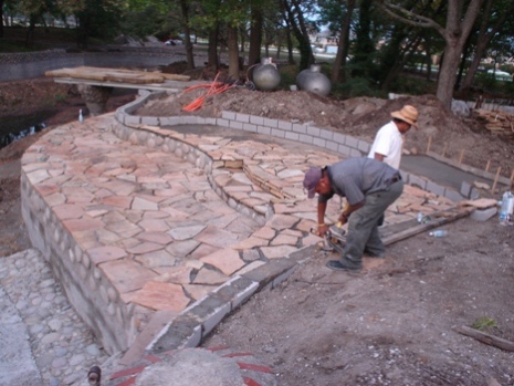

We got the third level of the tri-deckta poured this morning and laid the line of block behind it this afternoon.
As you can see it's coming right along.
