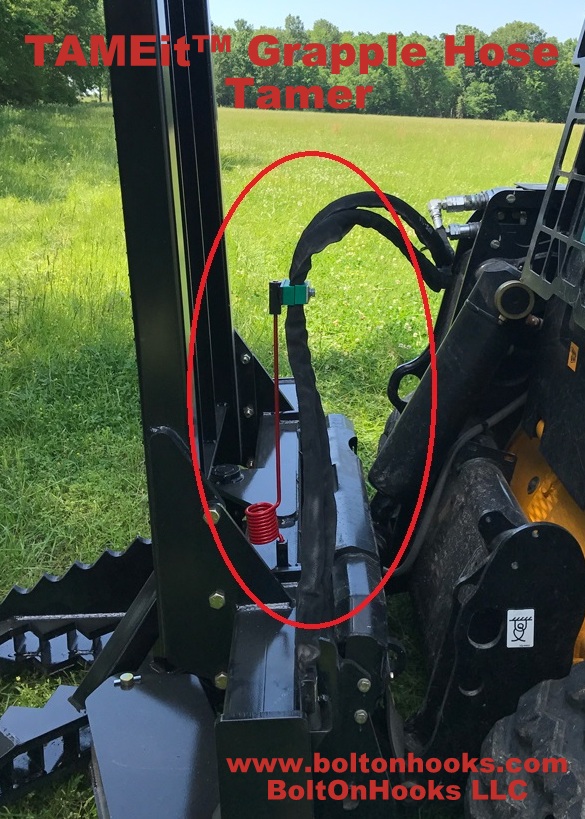

We sell the Hose Tamer on our website: Ken's Bolt on Grab Hooks <<Hydraulics>>
Thanks Ken! Yeah, $40 ain't steep t'all for something this nice.

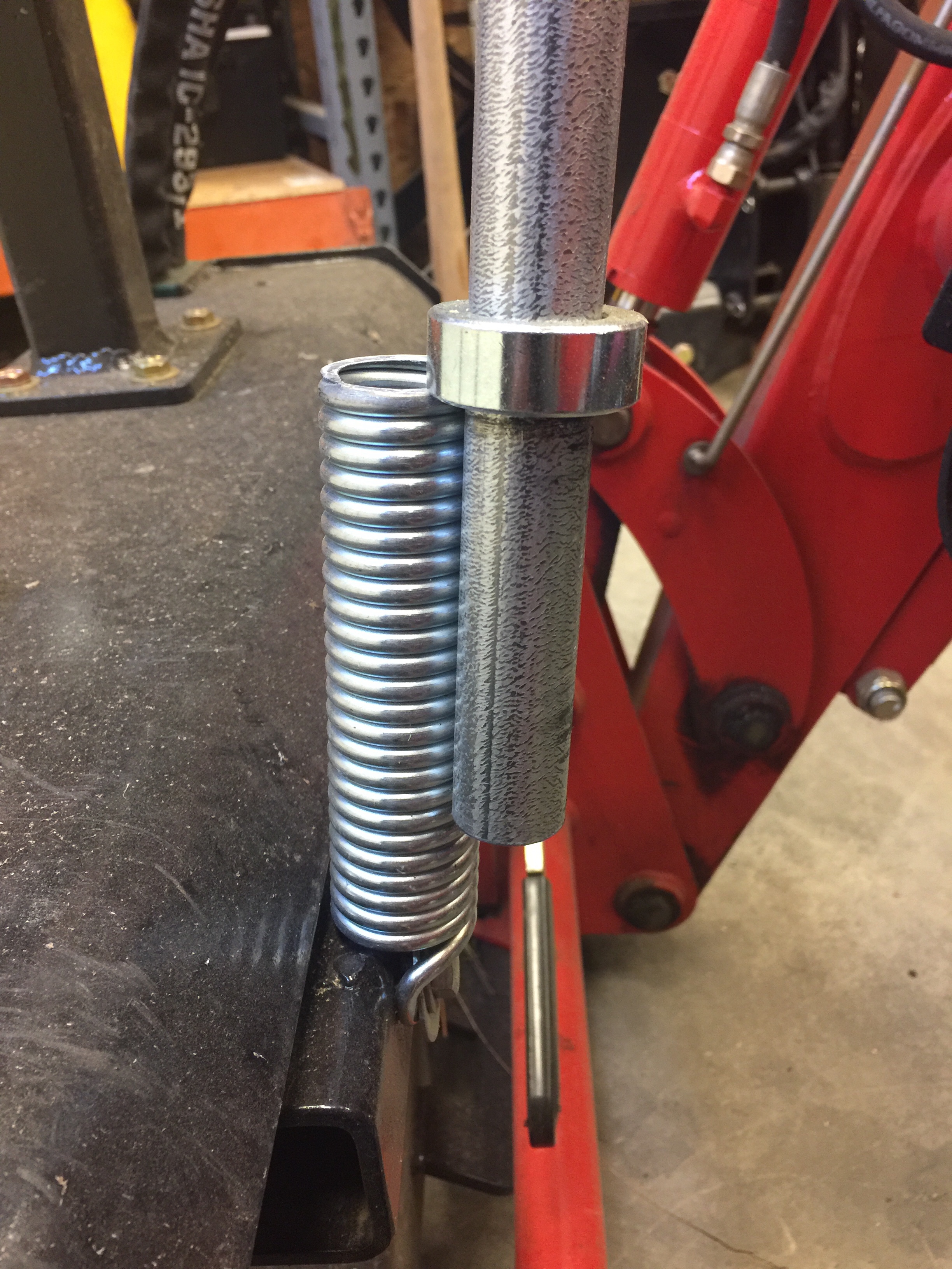

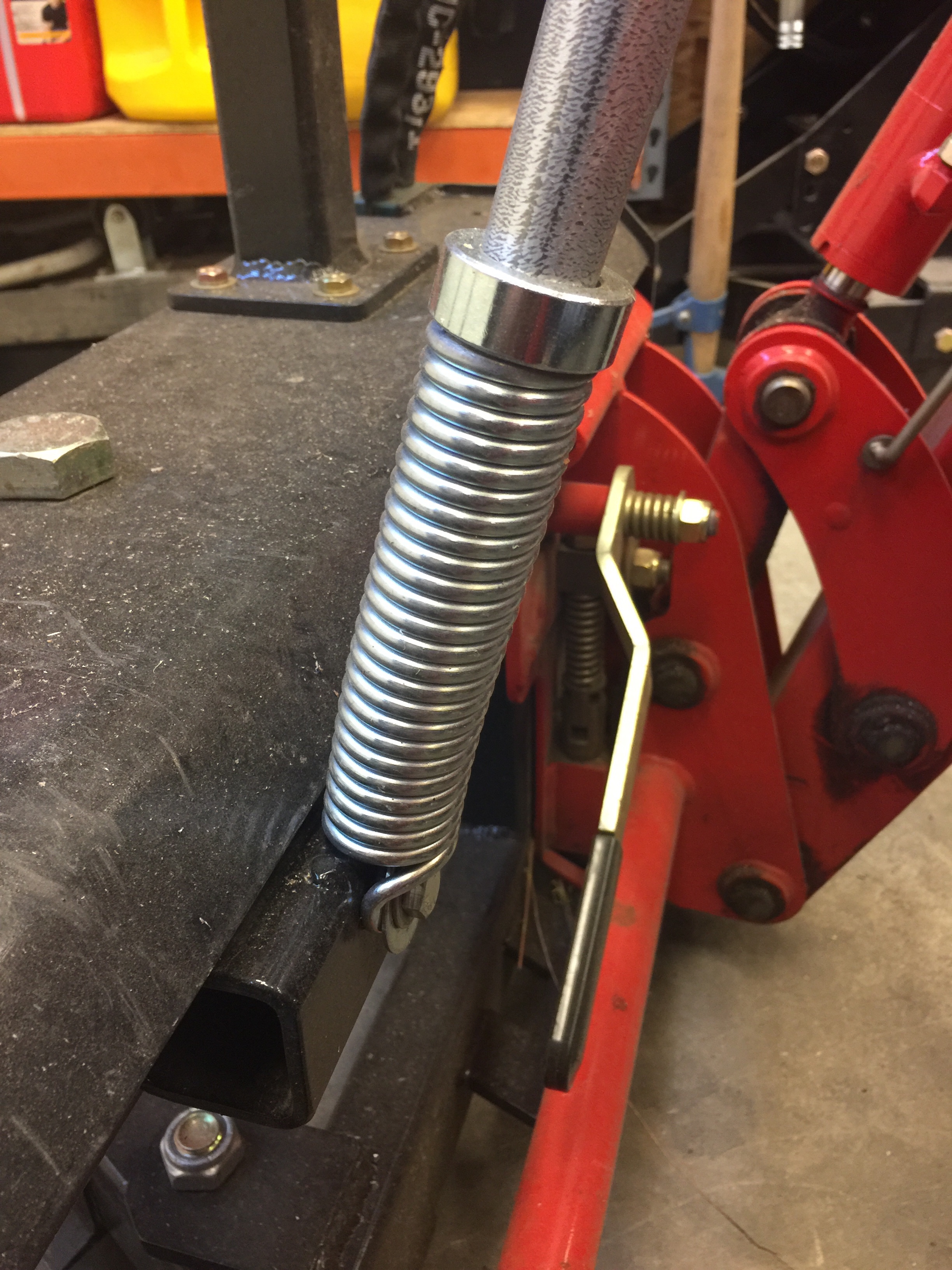

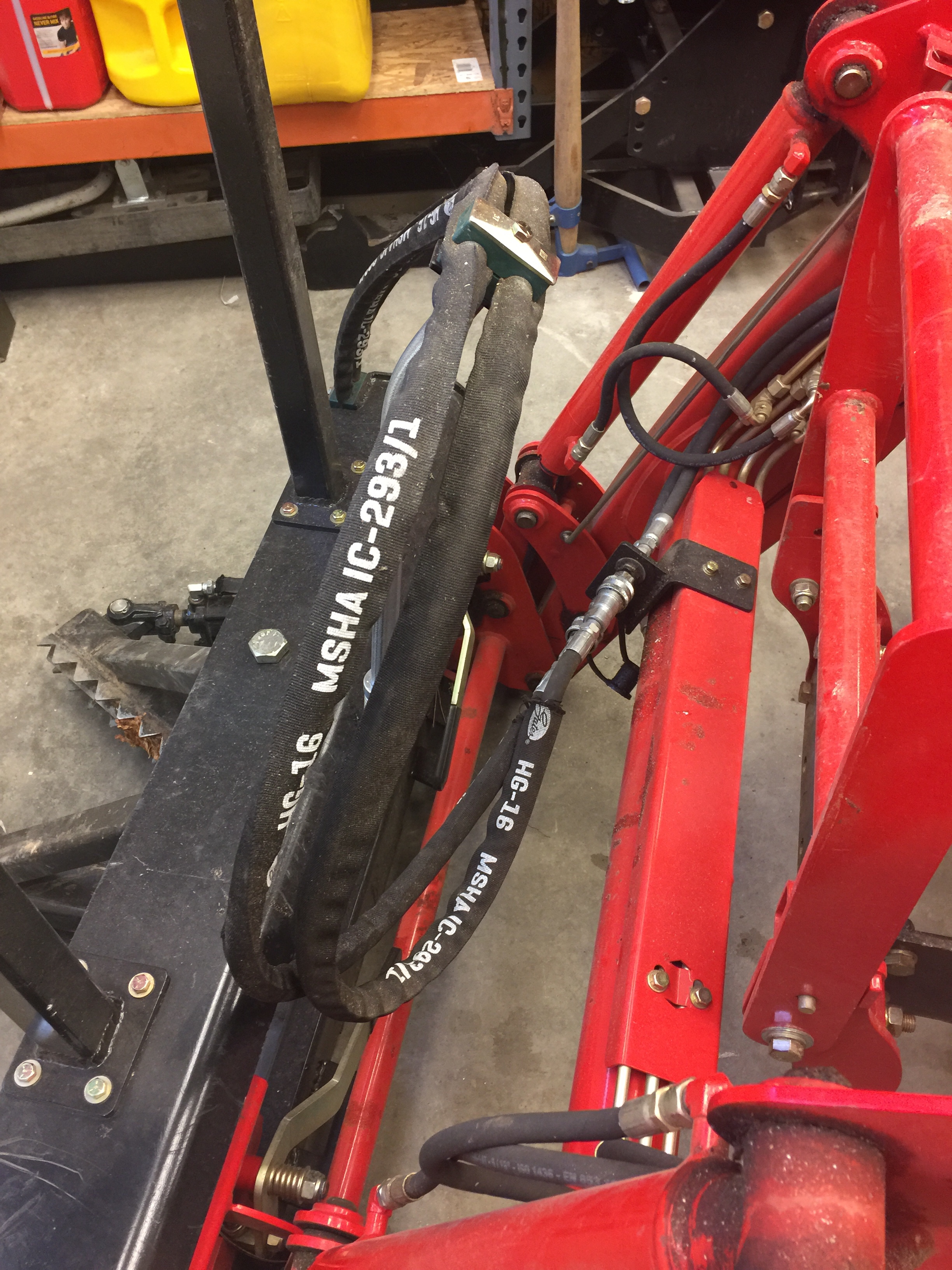

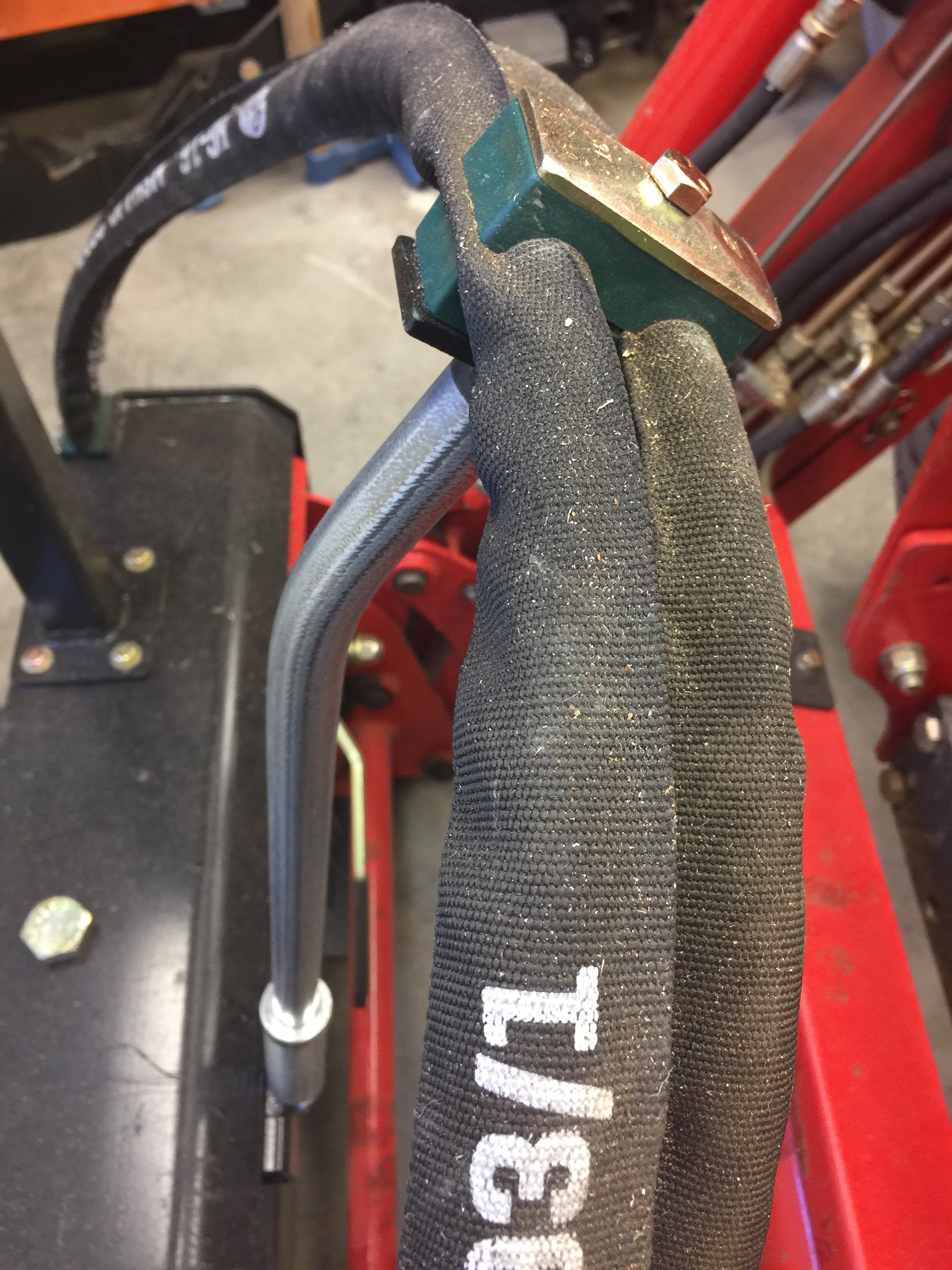

I’ve made my own with a spring from Ace hardware, dual hose clamps from the local hydraulic supply house, an electrical conduit pipe, a ring collar with set screw and a little welding to put this together. It sits in the spring holder loosely and doesn’t fall out unless it gets snagged so I consider that a plus. I built two, both stay on my grapple and the tree puller that I built.
Hose management for SSQA attachment w/ hydraulics. - YouTube
Video of a similar one on the grapple in operation...
ANBO grapple - hose setup - YouTube

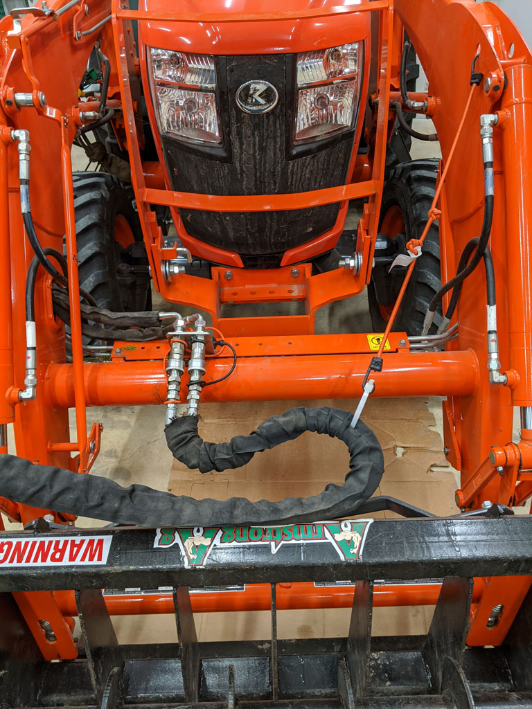

I have used a bungee cord on the grapple on my Mahindra for years with no problems. I recently got a grapple for my Kubota and have yet to figure out the perfect way to attach the hose with a bungee but will eventually find the right setup.

I had saw a post on here about using a bungee and figured I would do that until I got something better. Almost 60 hours later it is still there and not sure I will do anything different. My bungee was a bit longer than it needed to be and the next shorter I could find was to short so I just tied a couple of knots in it. Has been working well for me.

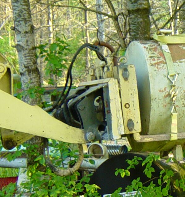

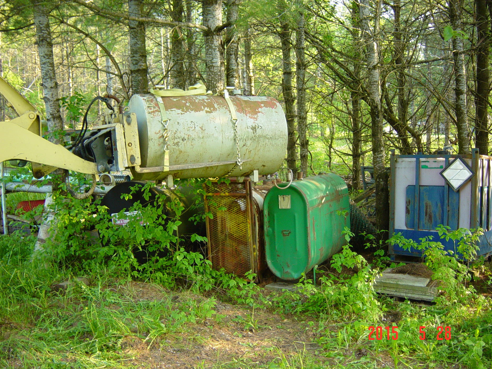

I just found a big ugly spring to use on my fork carrier to keep the hoses from getting crushed.
The hoses do drag on the bottom though, protected by loom.
I also made my AUX couplers of a breakaway design. Pipe nipples to the couplers held in a steel block. Worst case, the nipples get kinked and they are easly and quickly replaced.
