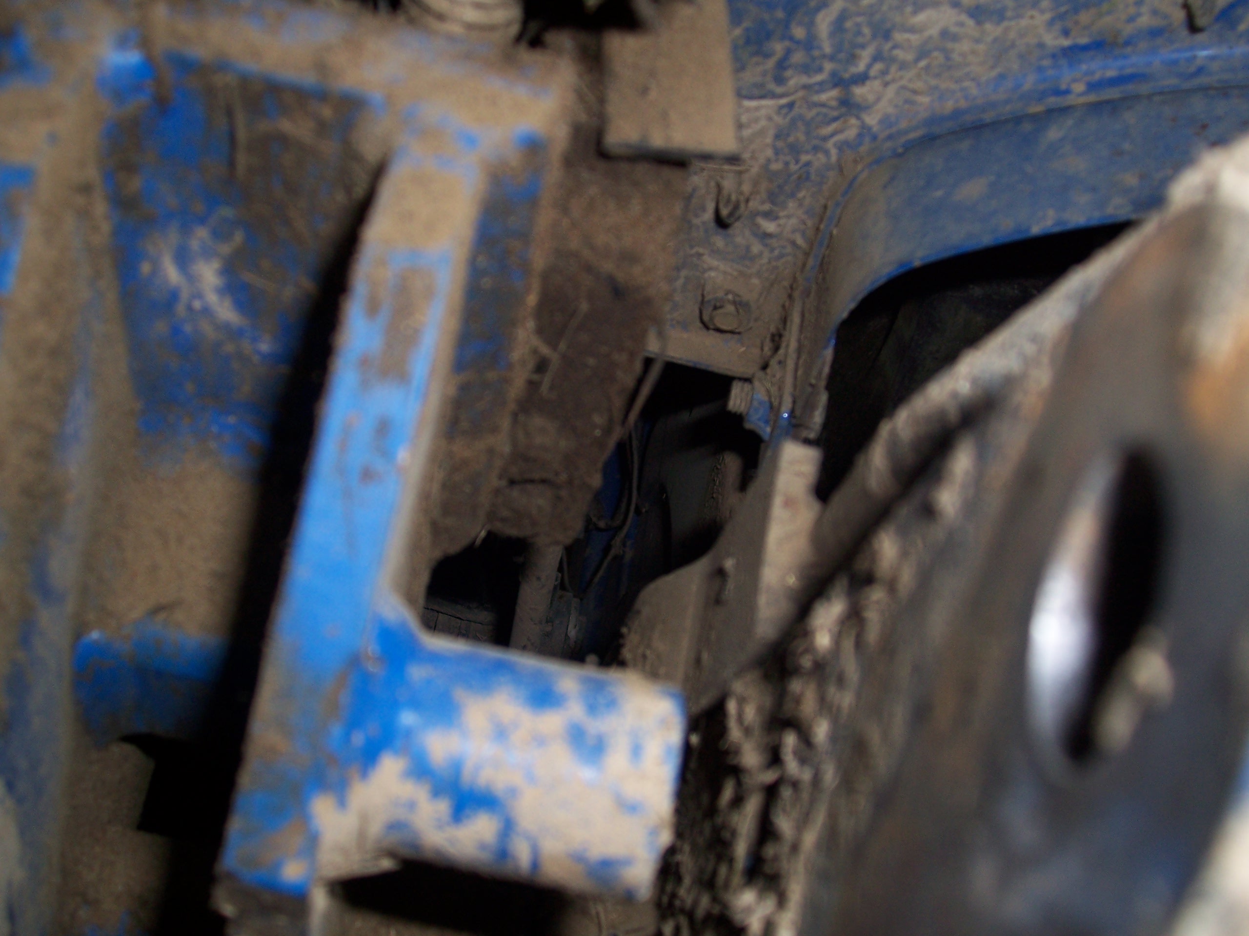

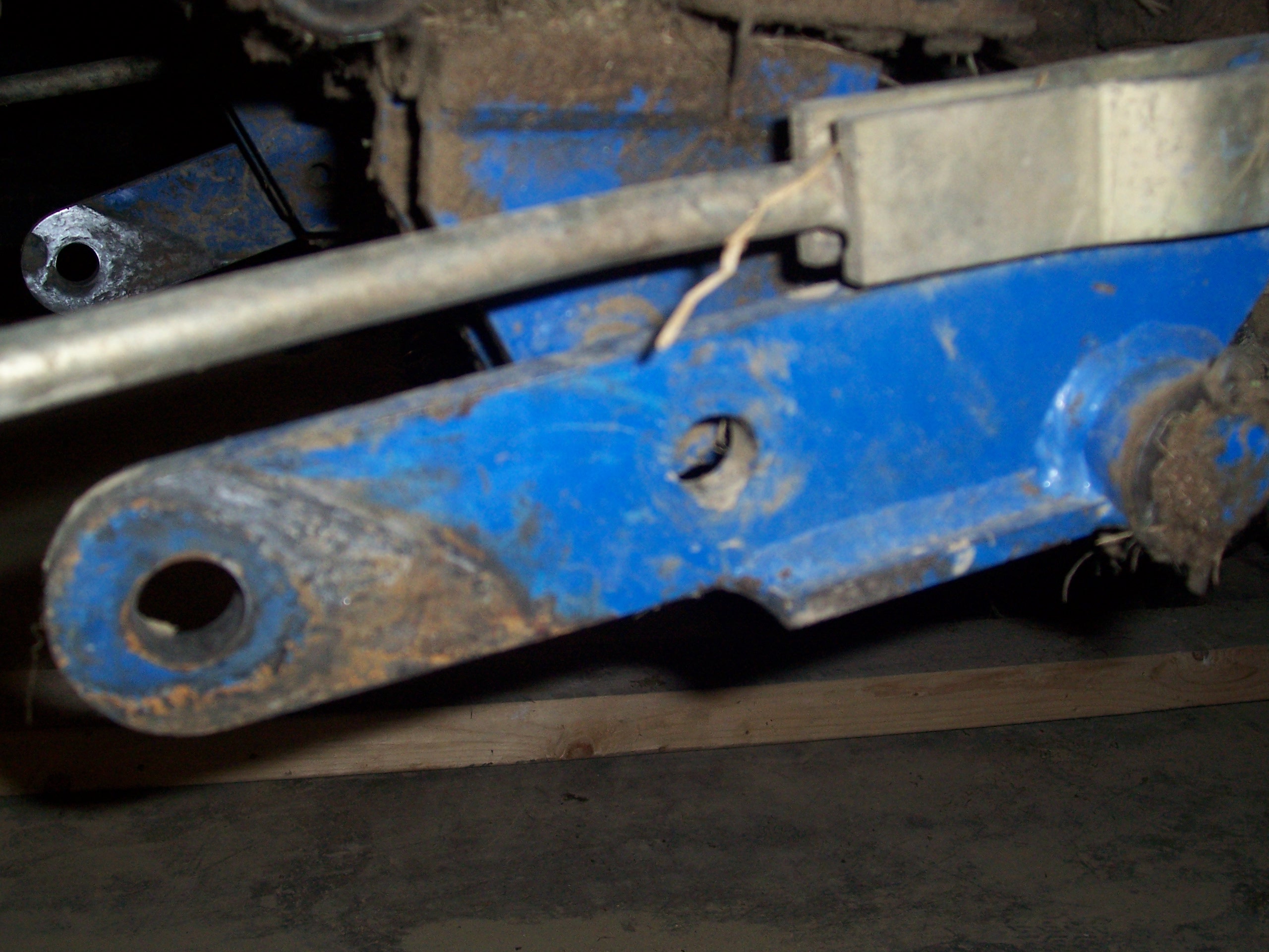

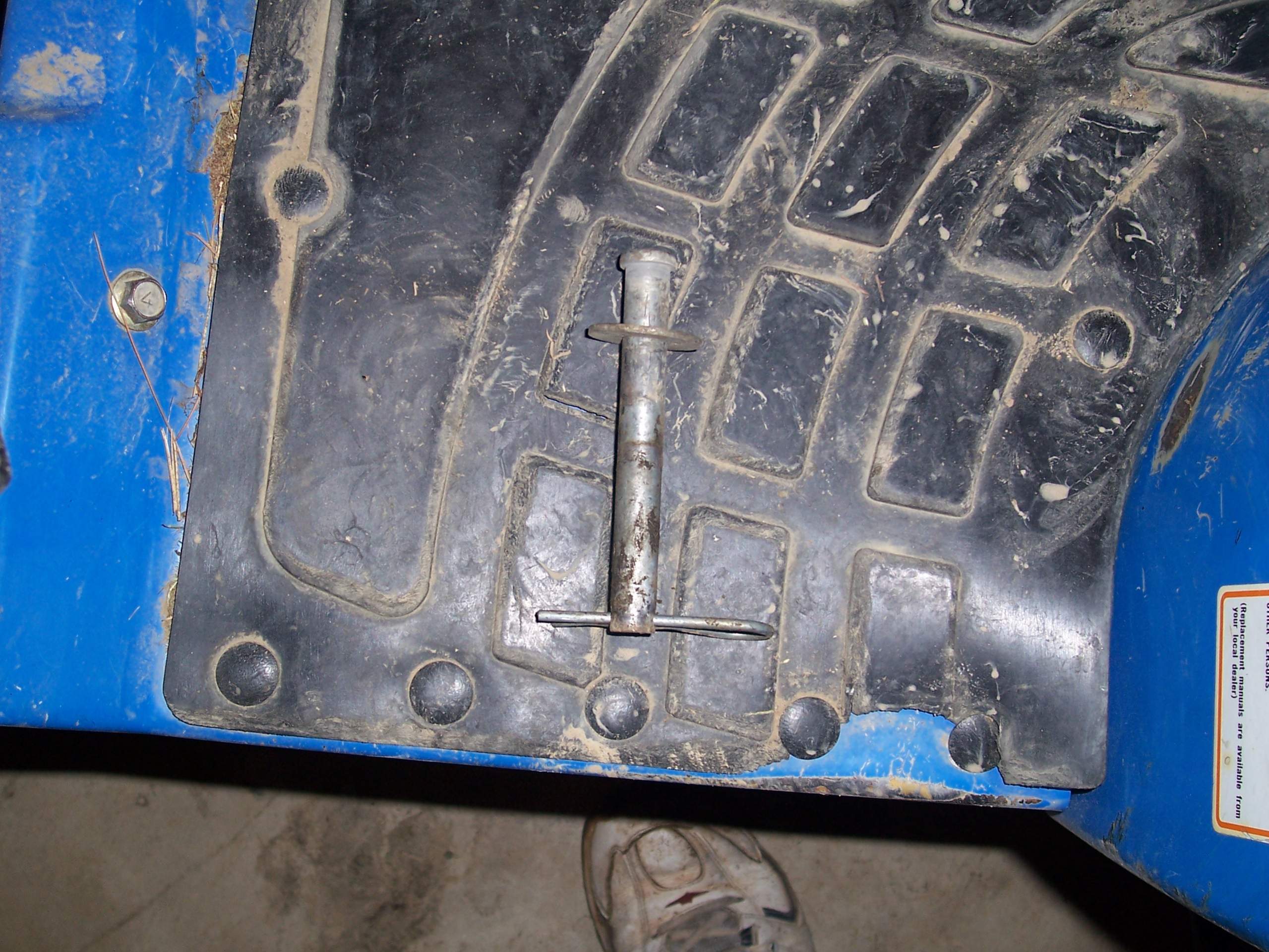

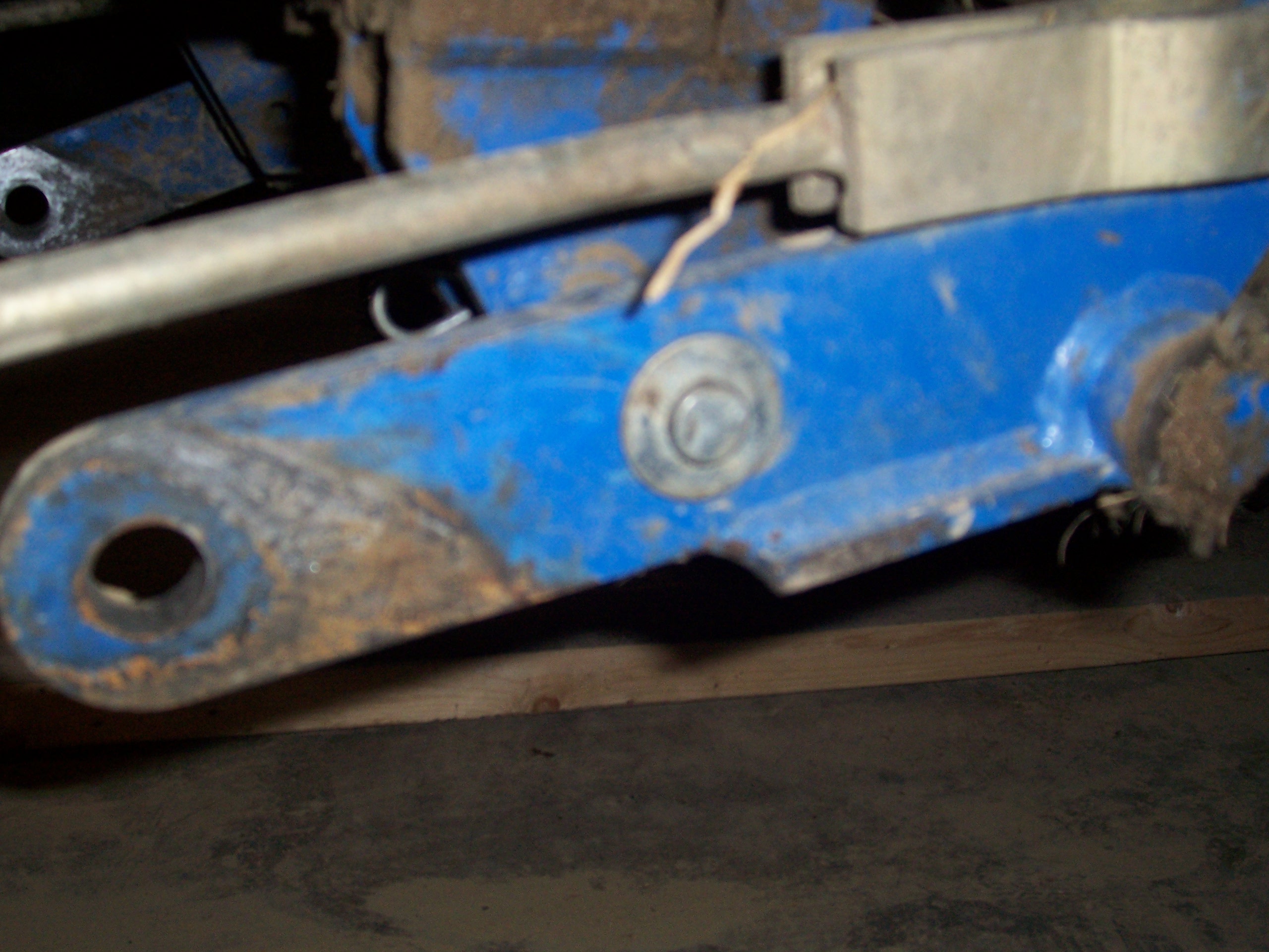

Sorry it took so long to get the pictures. But I finally got around to getting them tonight.:D
First pic you can see the hole that pin goes in on the right. Second pic you can see where the pin goes through everything. Third pic is the pin itself sitting on the footboard. Forth pic is the end of the pin in the hole. Last pic is of the pin through the hole with the hair pin to hold it in place.

Ok, Jim, thanks much!
It seems a bit odd to me that they'd have the pins not go through that second ear - the holes certainly go all the way through. Maybe that's for the "storage" option when you aren't using them.
I've since made up clevis pins from a couple of half-inch bolts that go all the way through, and they work just fine. it sure made it easier when we used the loader frame on the 3PH to load an 800 lb rock into my son's truck!
Since the pin goes through the sleeve and bracket, there's no need to make the pin long enough to go through both arms. Holds it up just fine.
