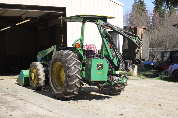

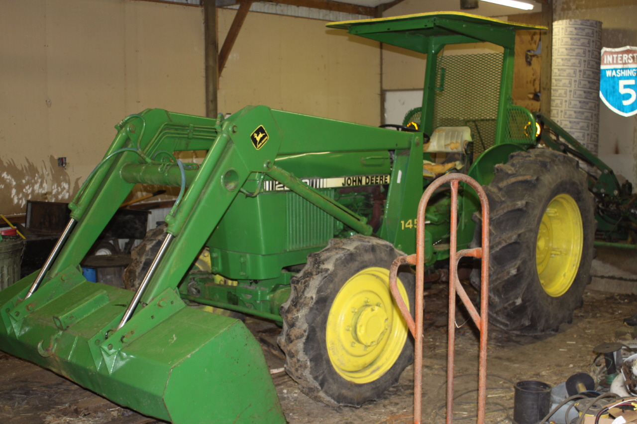

I'm not familiar with your tractor, but what you describe sounds similar to my JD 2240.

That's how mine is. My ROPS mounts to the rear axle. I'll be at the farm tomorrow. I'll try to remember to get some pix of how my ROPS attaches. Maybe it will help you to make some sense for how to attach one on yours.
