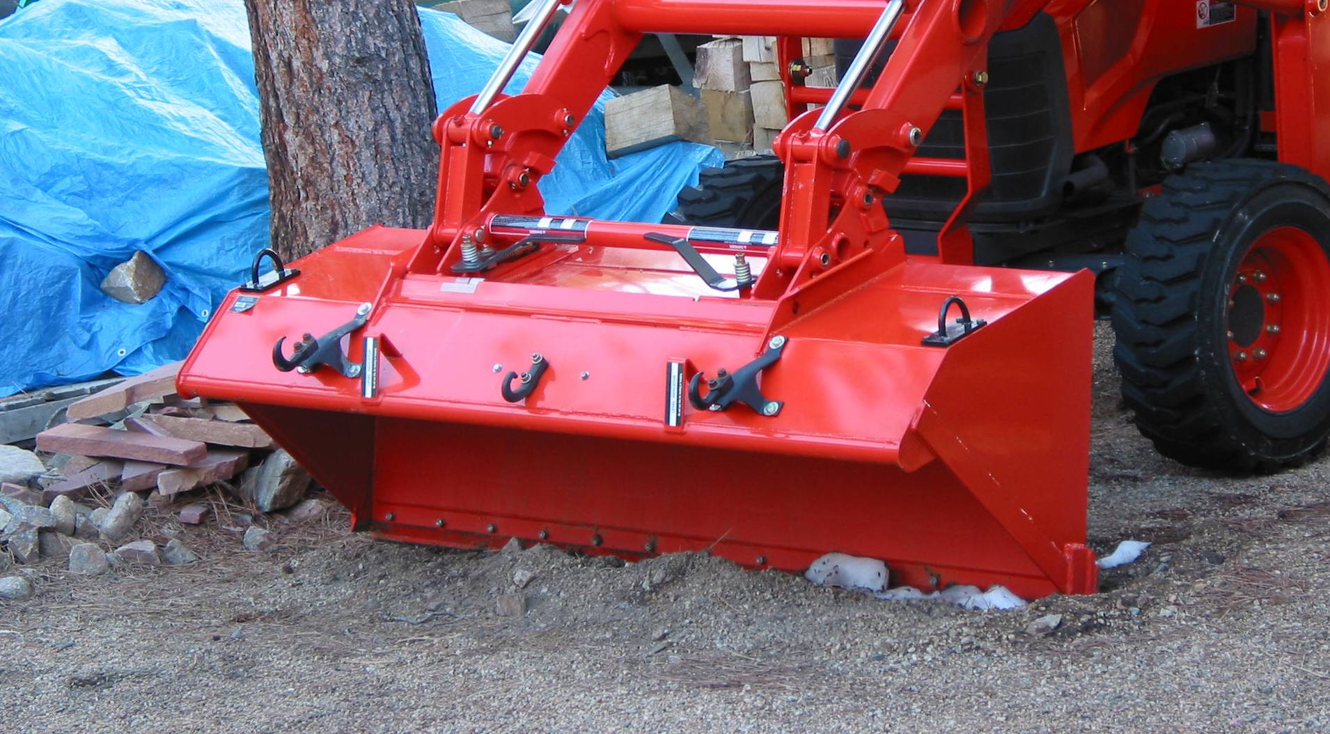

There was a time when just about every guy with a tractor was also a welder and metal fabricator. But things are different now and a lot of folks just don't have the time or learning or inclination anyway. It's a different world, appears to be getting better all the time, and I'm glad to see people like Ken stepping in to help out.
Here's what I put on my most recent machine:
The two large standoff hooks I believe are Toyota Land Cruiser front tow hooks - At the auto junkyard there is a 50 gallon drum with various tow hooks for ten bucks each. I couldn't resist these, and they hung on the wall of the workshop for a decade before I got around to buying them a tractor.
The center one really ought to be a grab style hook instead - but hidden away in one of dad's toolboxes I found this beautiful cast steel one. Looks kinda military, and must have lain there for years just hoping to get used. So I gave it the job.
The outer tie points are for when you want to rope or chain a large load into the bucket. Lots of things are too big to fit into the bucket, but easy enough to lift up and carry without damage if securely tied in. Our big old Craftsman table saw is the perfect example. These tie loops were fabbed out of 1/2" diameter mild steel rod fitted through holes drilled in their mounting plate and then welded to the the backside of that plate. Very handy.

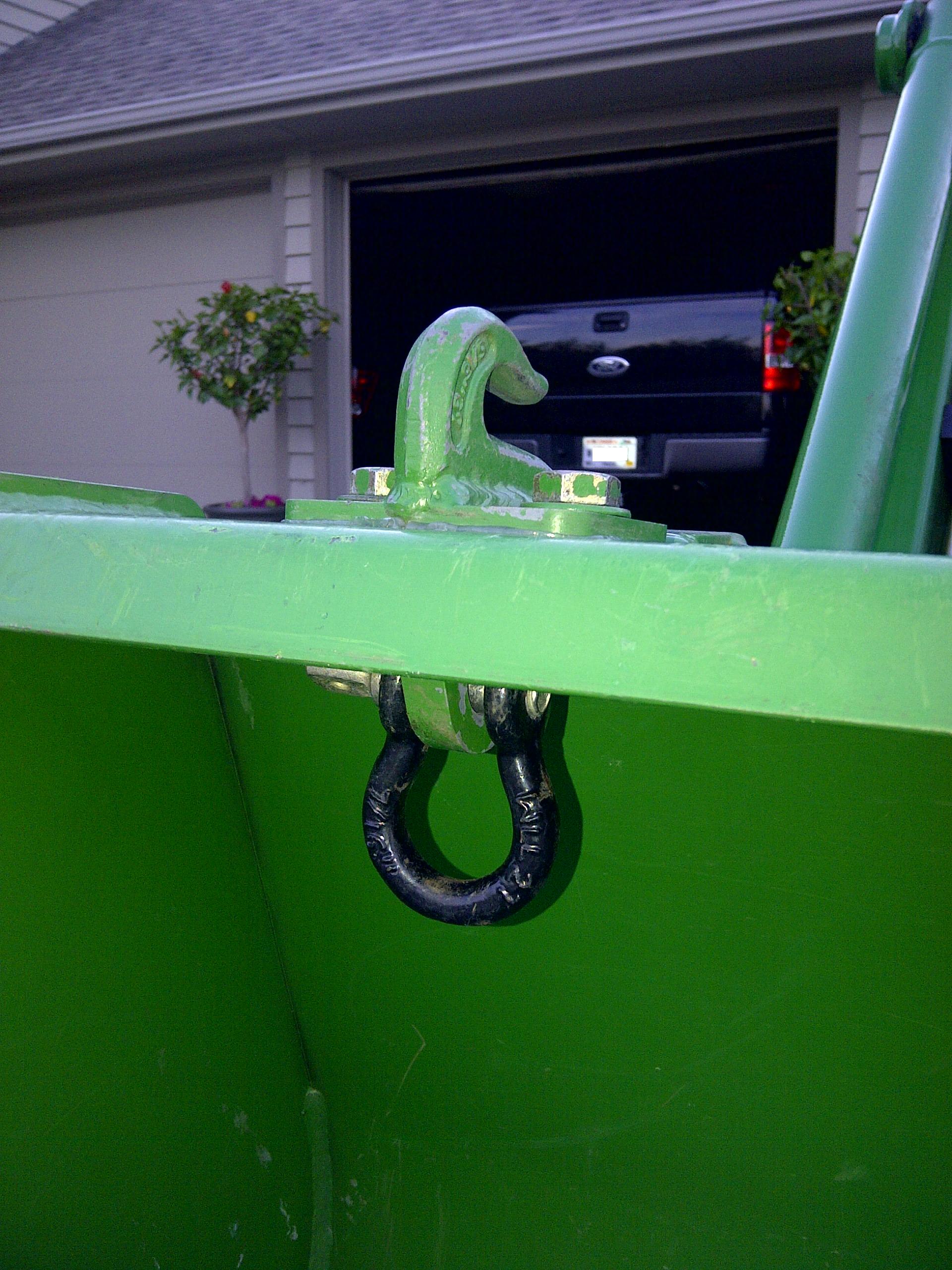

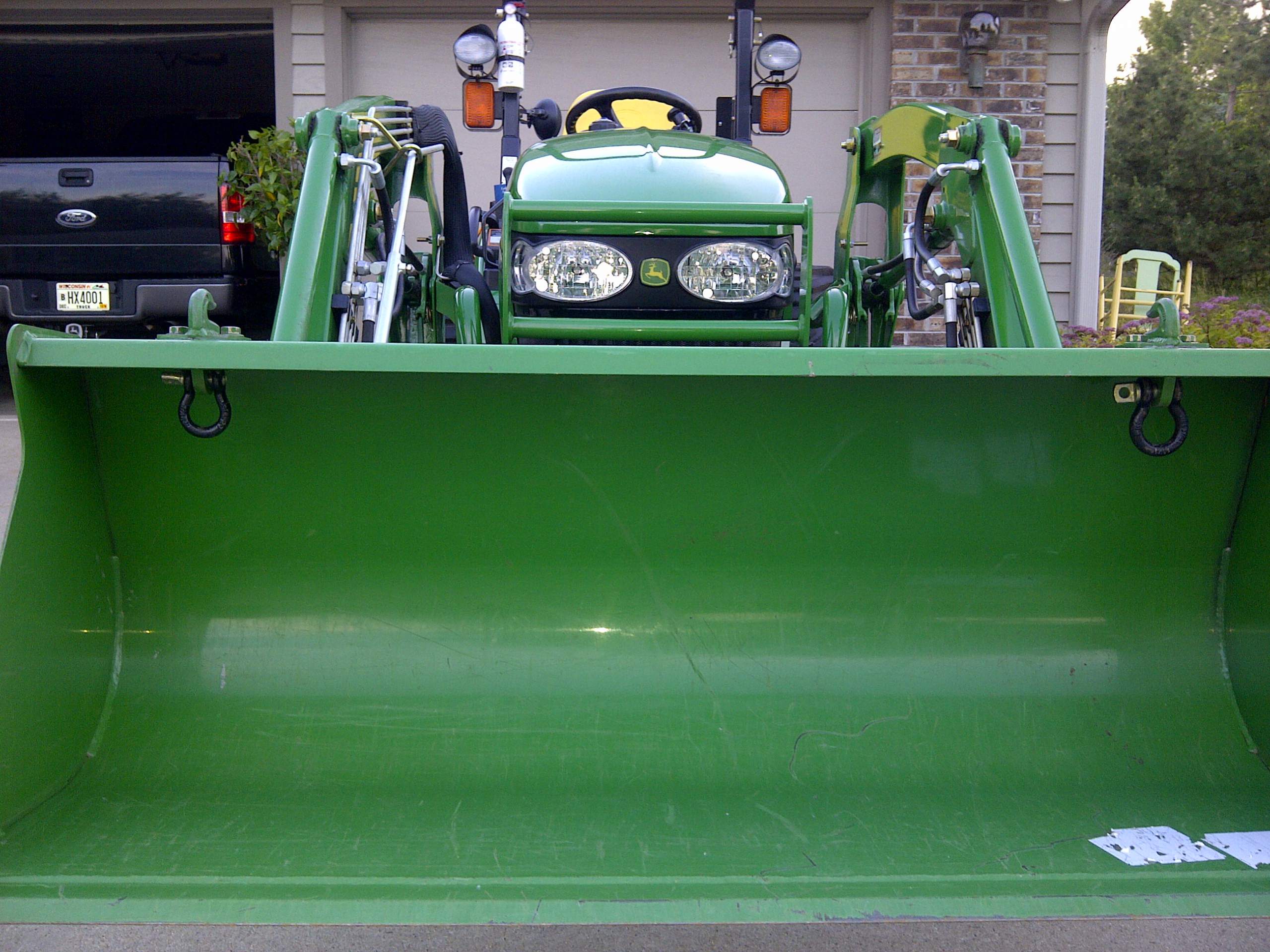

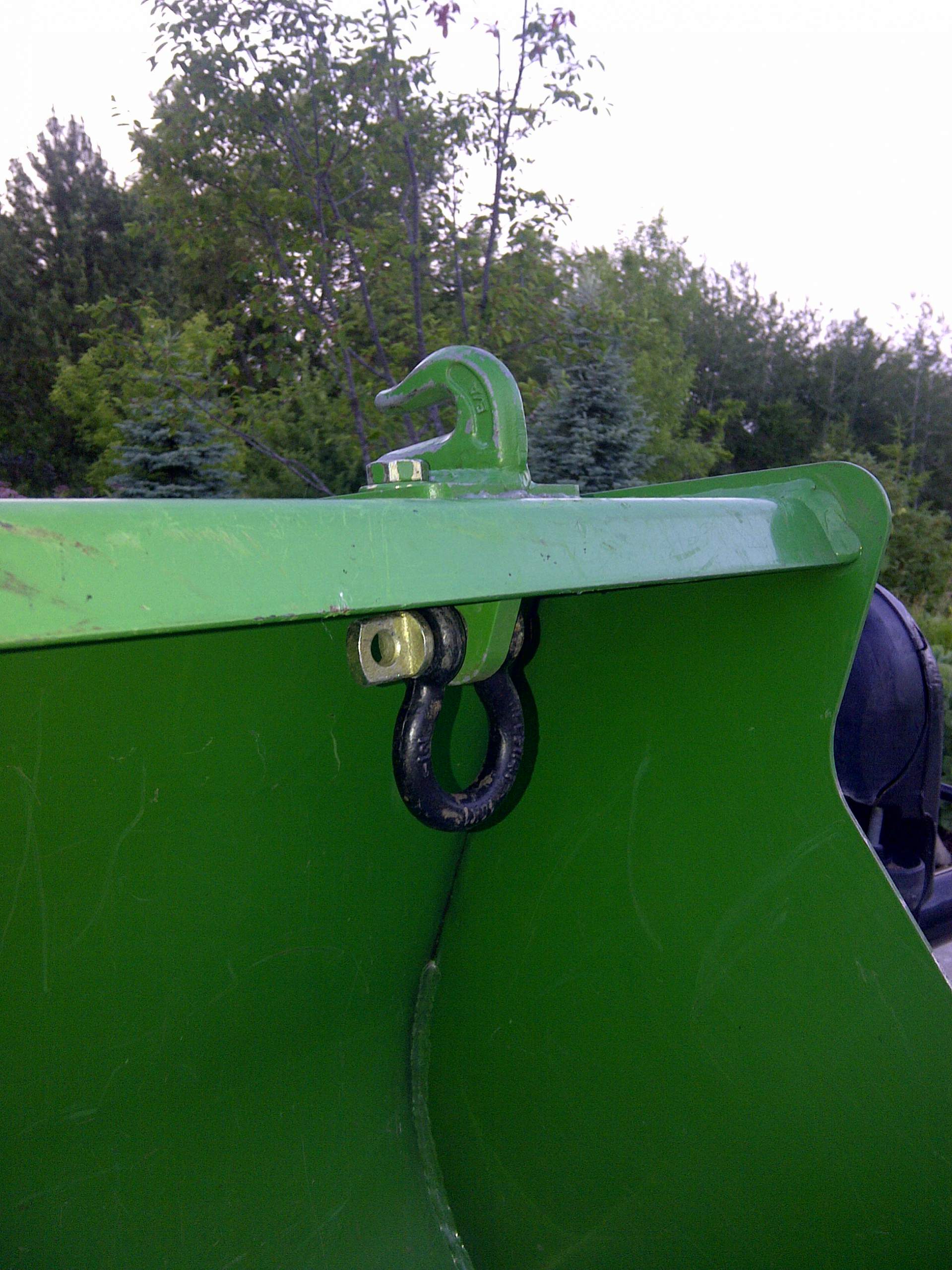

David,
I went with both...

Hey lost, pretty good idea
