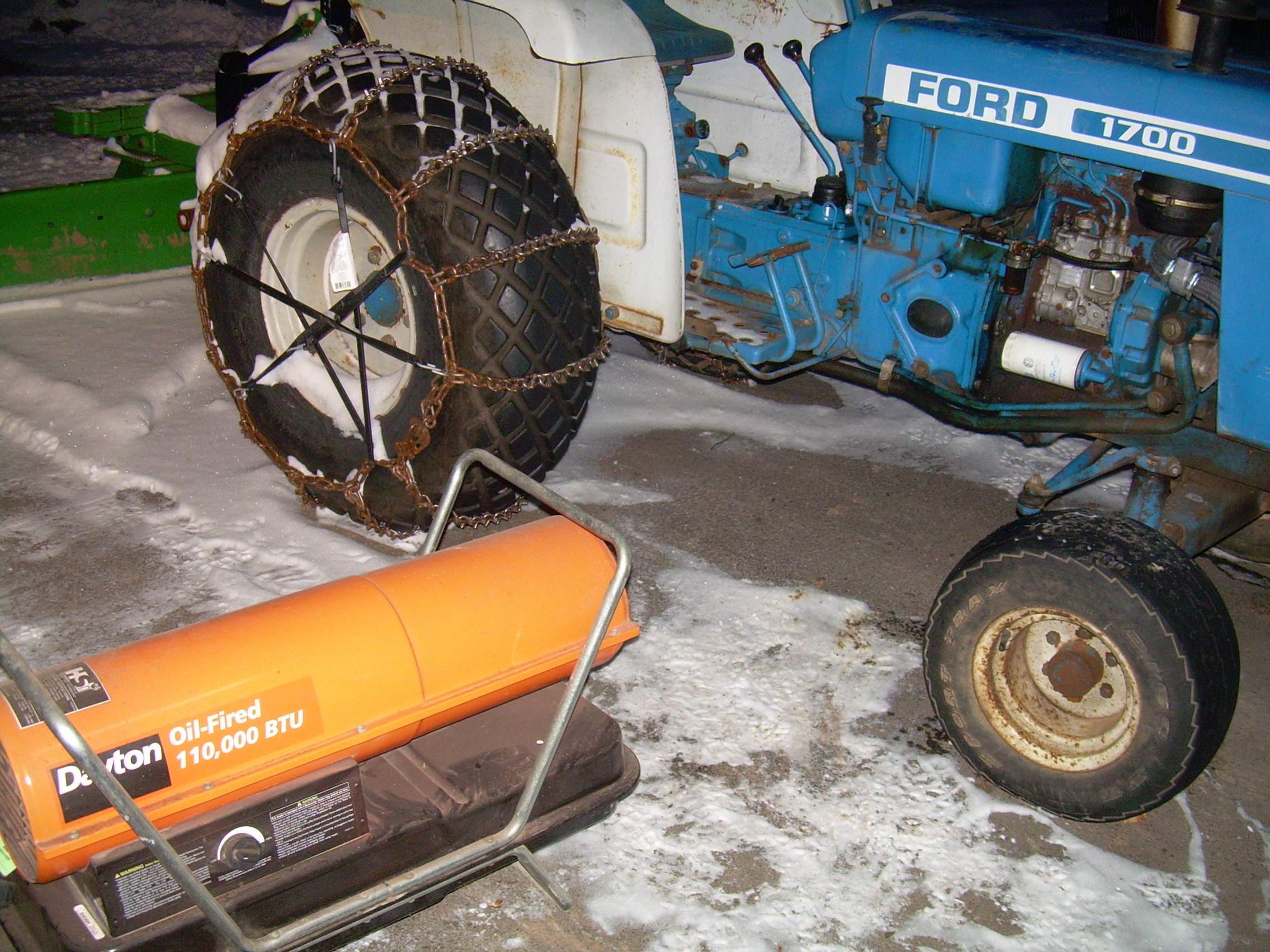

I run my torpedo off kerosene rather than diesel so its cleaner burning. I dont use it in the barn often, but that's where I mostly use it. I've got a carbon monoxide & explosive gas detector in the barn & on the other side in the shop. The barn at least is leaky/ventilated enough the detector has never gone off. Even then I can get a hair of a headache. Between that & cost due to it sucking down fuel means I dont use it often.

The barn is well ventilated & that will never change. The shop is attached & has a dual layer metal roof & 2 inches of foam on the roof. It's often 10 degrees different between the 2 halves because of the extra insulation with no heat.
I've got a wood fireplace & gas furnace in the shop to get hooked up. They wont help working on the tractor in the barn half when it's cold though. Not a big deal as I only need to work on it occasionally in the cold.
