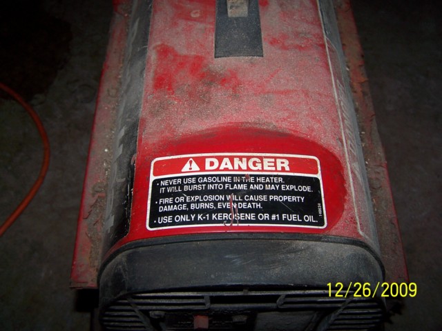

I've got a 110,000 btu unit, mine doesn't say it's multi fuel, Would like to burn diesel, K1 is 1-2 bucks more a gallon and not always easy to find for me.
Is it commonly accepted that any kero burner can substitute diesel?
Looking at the picture, it does just say oil fired, not kero?
JB.
Looking at your pic and some back ground investigation it looks like Dayton is produced by Desa the same company that makes Reddy heaters. My Reddy heater is multi fuel and will run on almost any lite oil. More then likely you will be able to burn diesel just fine but the emission will be higher then with 1-K. I have found regular red dyed kero locally to produce the highest emission. I currently am running on #2 heating oil since I have a bunch of it. ULSD burns cleaner then even heating oil in my heater. Find the model number of your heater and see if you can verify what it can run on. I know the John Deere heater Desa also produces can run multi fuel as well. Reddy heater parts may be able to clarify for you and if need be sell you a different nozzle for your heater so you can run multi fuel.
