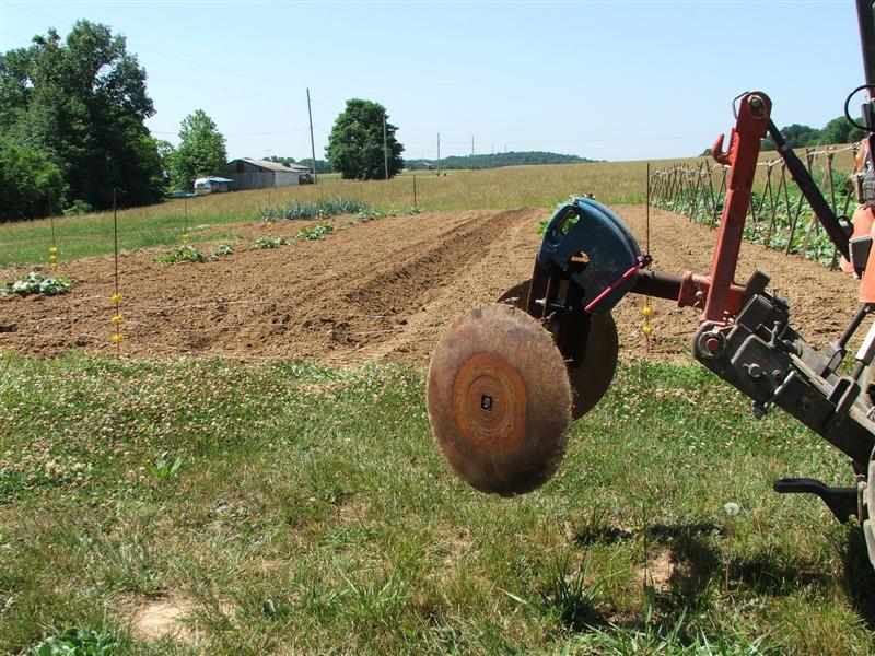

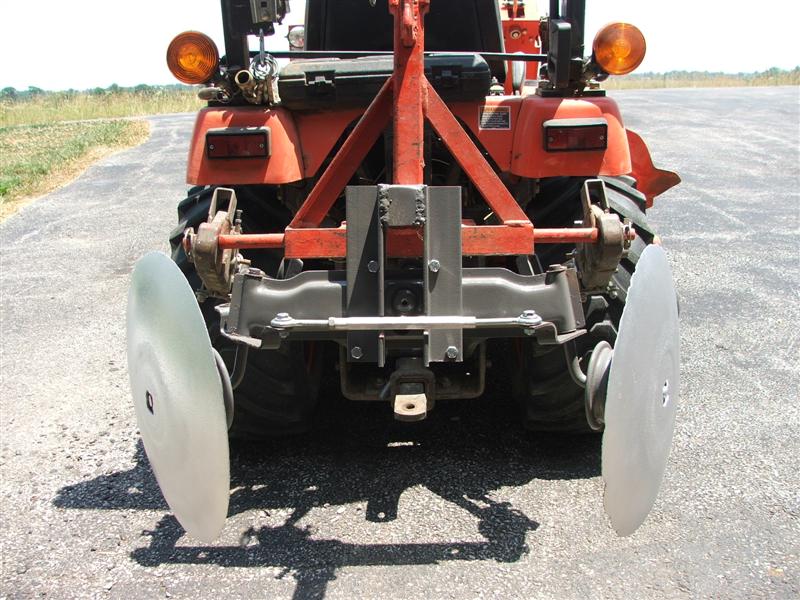

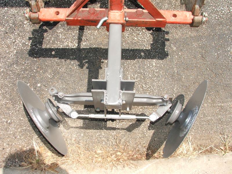

I looked at them and really like them, but decided to make one since I'd only use it for my garden. I had an old front axle from a Sears rider and a couple of disc blades and came up with a contraption that works better than I expected. I removed the tires and welded the disc blades to the outter edge of the rims and replaced the tie rod with an adjustable turnbuckle. I had to add a couple of weights and the last picture is where I tried it out before I cleaned it up and painted it.

Milkman, that looks really good. Raised beds must be fun to make.
Wayne
   / Keulavator L3130 #4
That was my first try at that, and it was fun, I already had my potatoes in the ground and that row was for my sweet potatoes. This year I will use it for all my potatoes and hope it will help keep some of them from coming to the top and turning green, though I don't have a lot of that. I'd like to do some parsnips this year too, oh well, just dreaming with all this gloomy weather.
