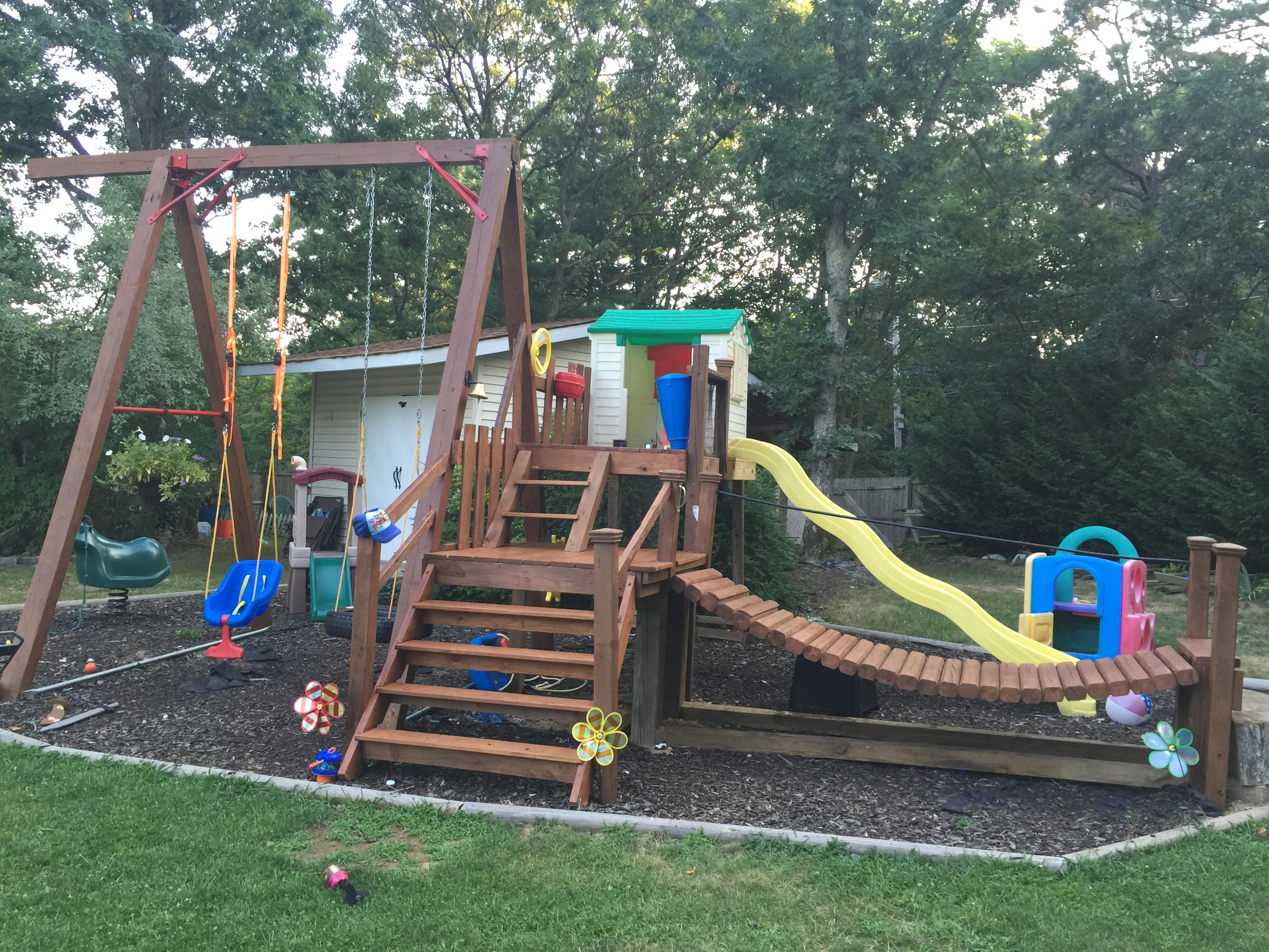

I built a swings for my grand kids last spring
the uprights were 12' treated 4x6 stained..... brackets were 3x3 angle bolted together
equilateral triangle is most stable format base but I went with 8' spread at leg bottom/
Rock solid and a long swing arc for kids
