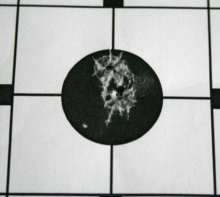

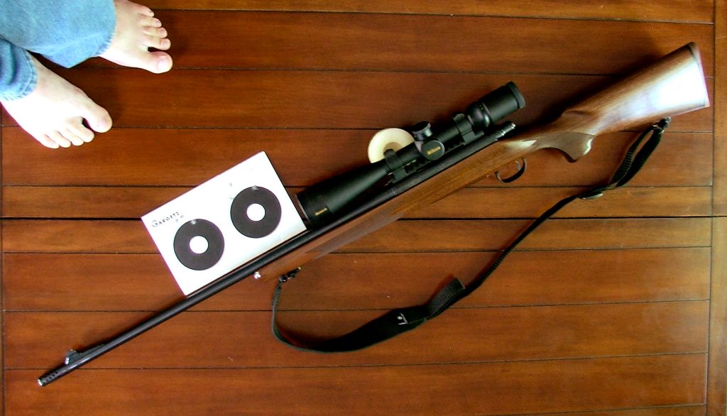

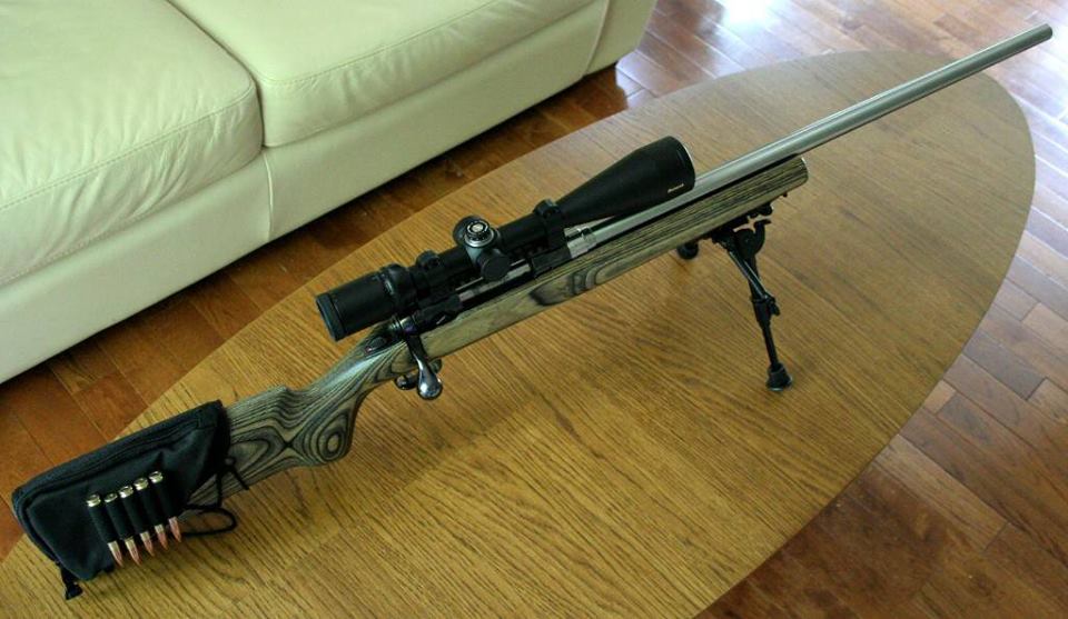

My worst personal experience was a Remington 700 "Classic" with a beautiful walnut stock. The original owner had a mag na port brake fitted to the barrel which made it loud as **** (it was in 8x57 Mauser). That thing never shot better than 2.5MOA regardless of new stock, bedding job, new trigger, better scope etc etc. And a variety of hand loads. When I first got it, it was 6moa. The quality of the Remington barrel and chambers were just very poor, rifling finish was bad enough to cause a lot of copper fouling and of course the factory trigger (post lawsuit) was about 10lb and couldnt be adjusted based on the new springs used in it. I finally swapped it for a "basket case" savage rifle which when I got into it, was assembled with the wrong recoil lug, which was preventing the barrel nut from being torqued properly. 1 new recoil lug later, and a headspace gauge, and I had a rifle with a Shillen lapped barrel which shoots less than 0.25MOA. My most accurate rifle ever.
In the meantime, if I want a different caliber, I just buy myself a cheap model 10 or 12 savage rifle with the appropriate action length and steel magazine, and order a Shillen barrel for it and when combined with a decent stock, you always have a rifle that shoots great for a minimal amount of money.
The Remington "Classic" with the best groups it ever shot....
The basket case Savage with its group from reload development
