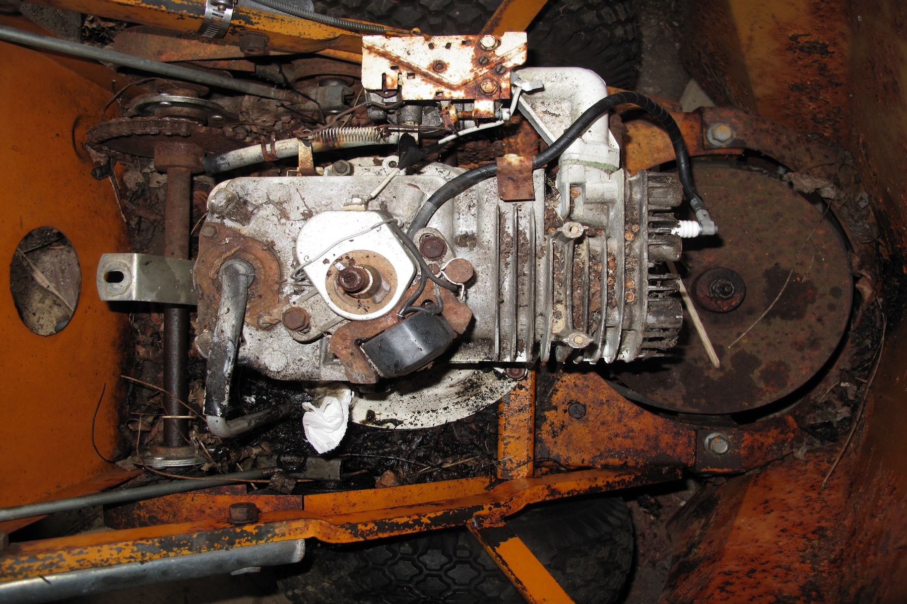

Took the motor apart to change leaking seals on both output shafts and will also seal up the oil filler spout where it joins the motor, still no luck finding a manual, I have the Tecumsa engine.

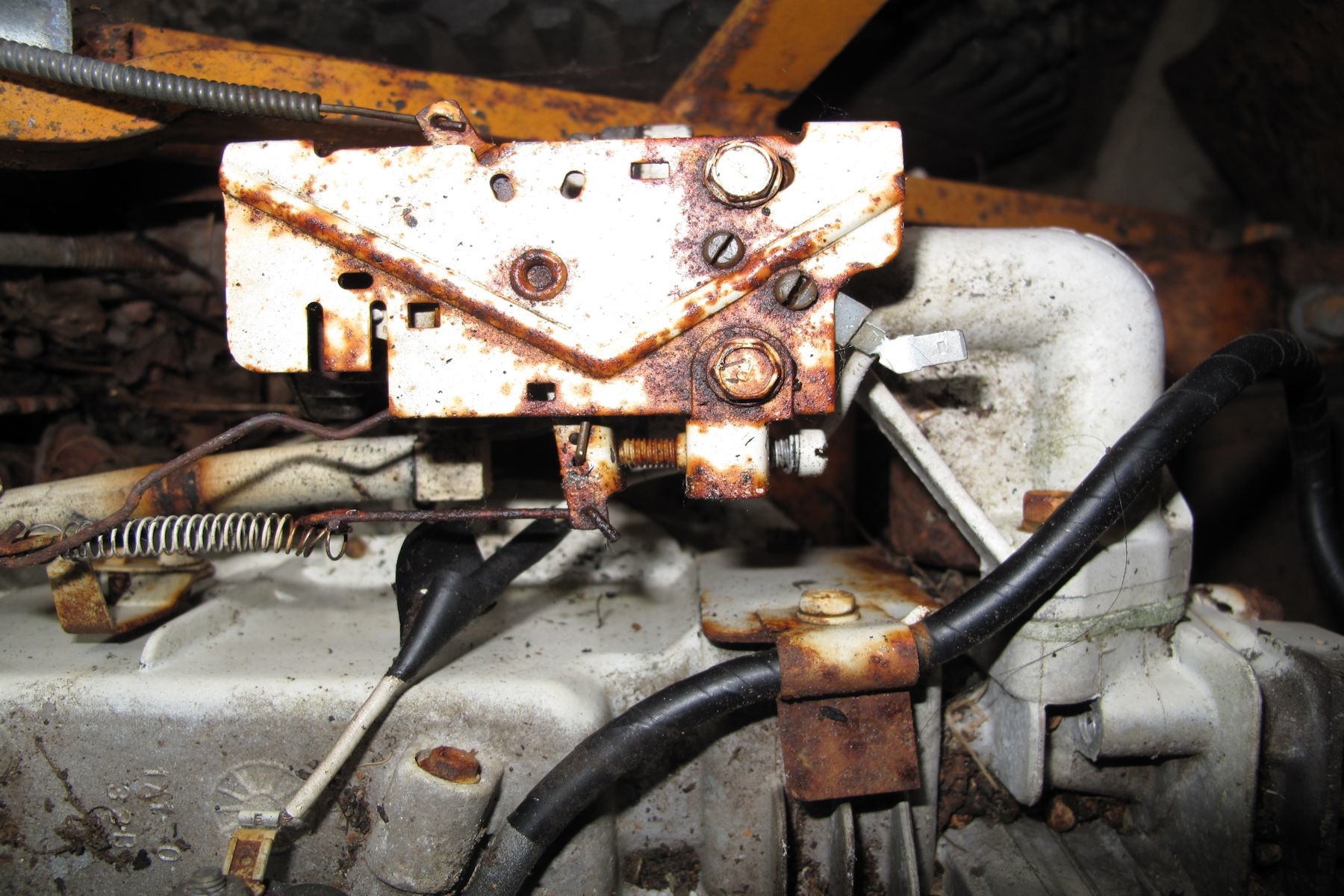

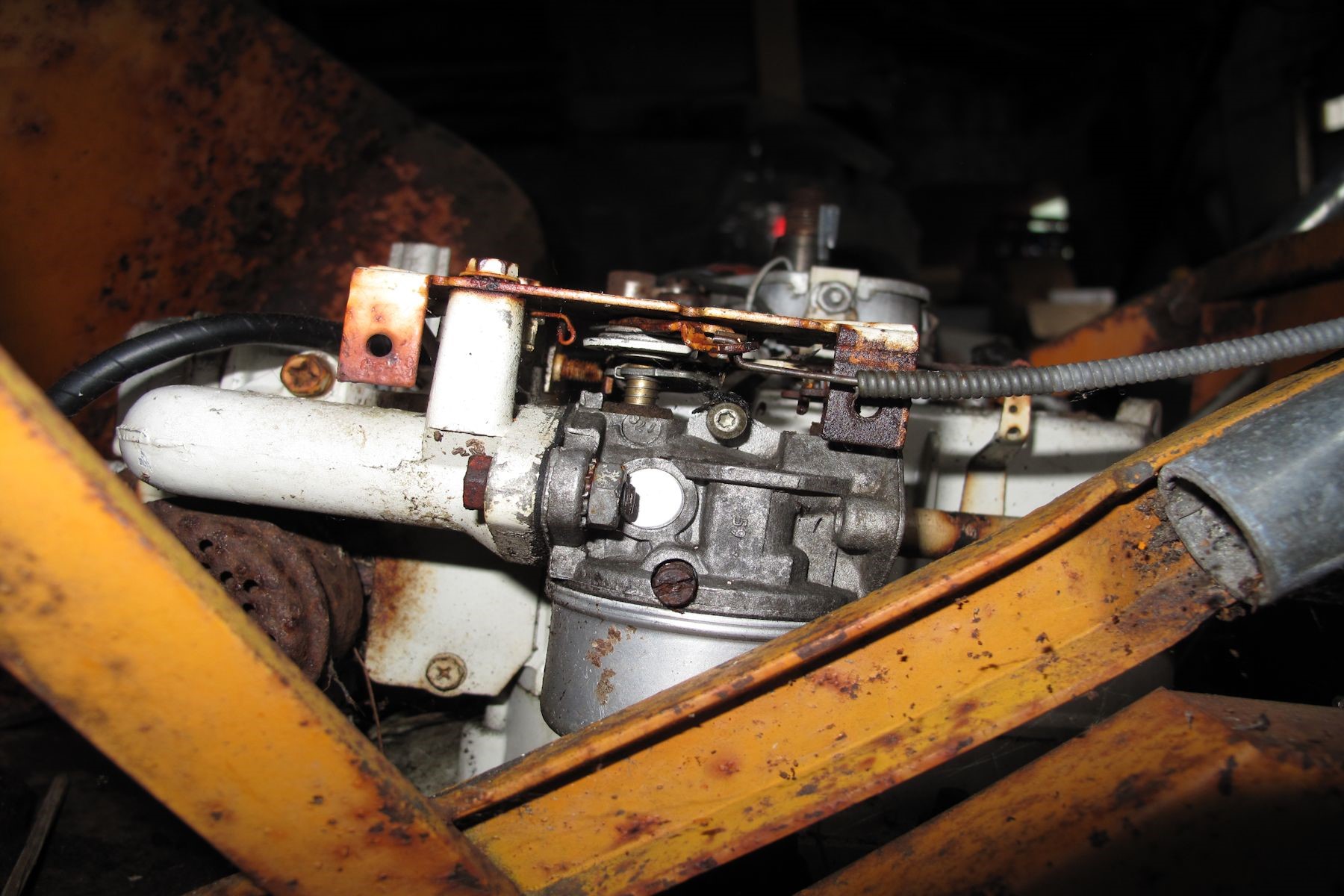

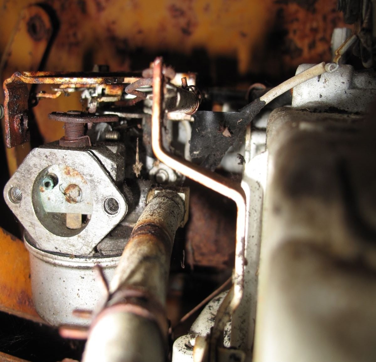

Here are some pics as I removed my Tecumseh carburator. Tecumseh carburator govenor linkange connection.jpg Tecumseh throttle linkage to carburator.jpg Tecumseh Carburator air intake.jpg top view.jpg

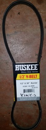

Kinco KMG-38 V belt obtained from Tractor Supply. Correct size is 1/2 inch by 38 inches. 0.5 in by 38 inch v belt.jpg

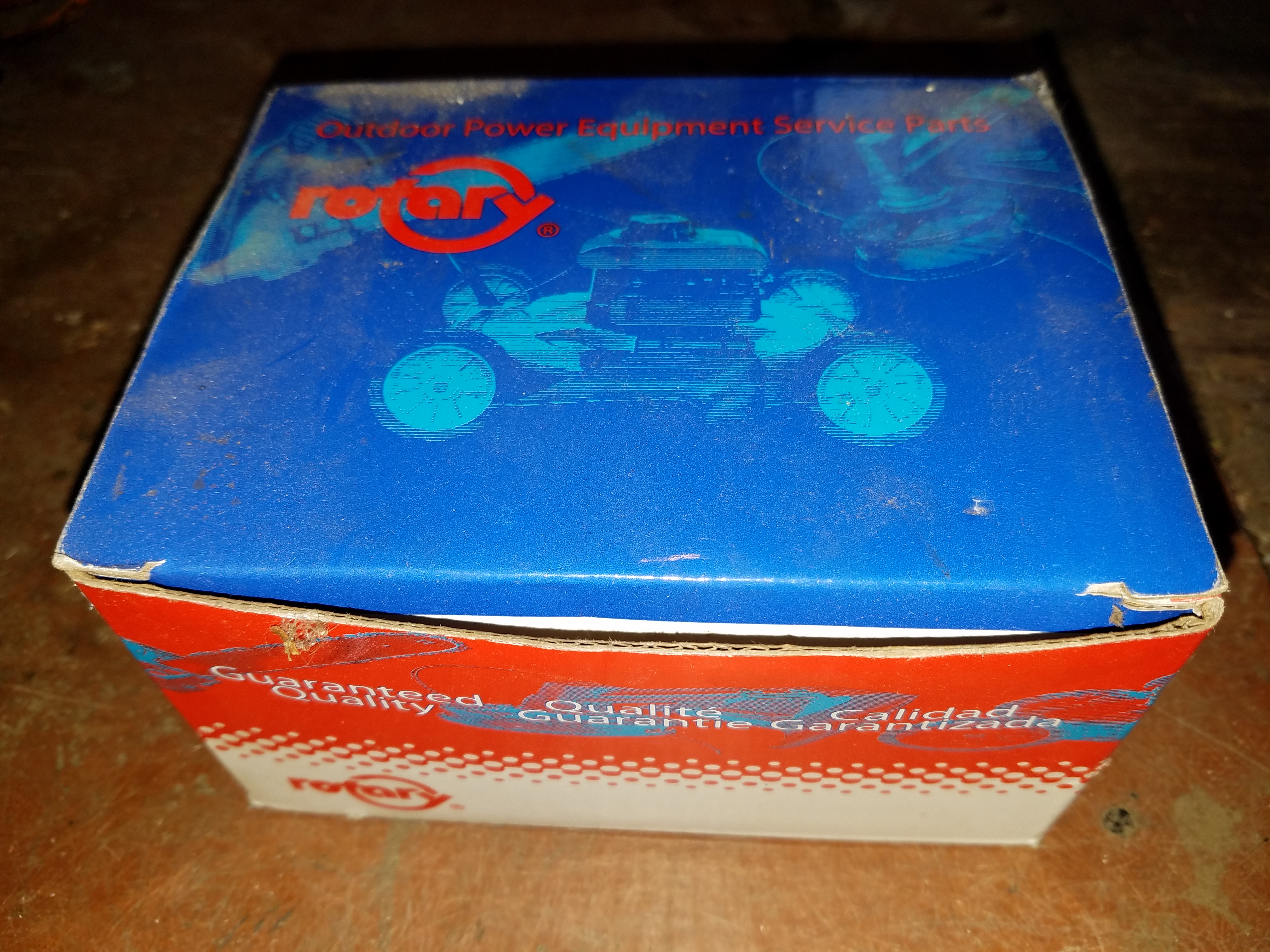

My Kinco KMG-38 with a Tecumseh got a replacement carburetor that I ordered online. It needed no adjustments after installation.Carburator box top view.jpg Tecumseh 3.5 hp replacement Carb.jpg
