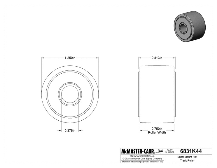

We have a DR Power K55, discontinued as the K34 seems to do the same job. Purchased in 2014. Overall very pleased as the cycle time is much faster than hydraulics and it’s split everything we have (Ash, Birch, Hornbeam, Maple, Red Oak. Limited amounts of White Pine and Eastern Hemlock).
Recently the bearing that holds the rack gear against the pinion gear broke. The parts manual listed the bearing as “Bearing, Yoke, Roller, 1.25” OD, 3/8 ID, 0.813” wide.”
Ordered the part from McMaster for $36 plus shipping. Delivered next day.
For reference, the rack and pinion gears are supposed to be greased every ten hours. Hadn’t been doing that. The pinion gear is shiny but not worn. On it!
