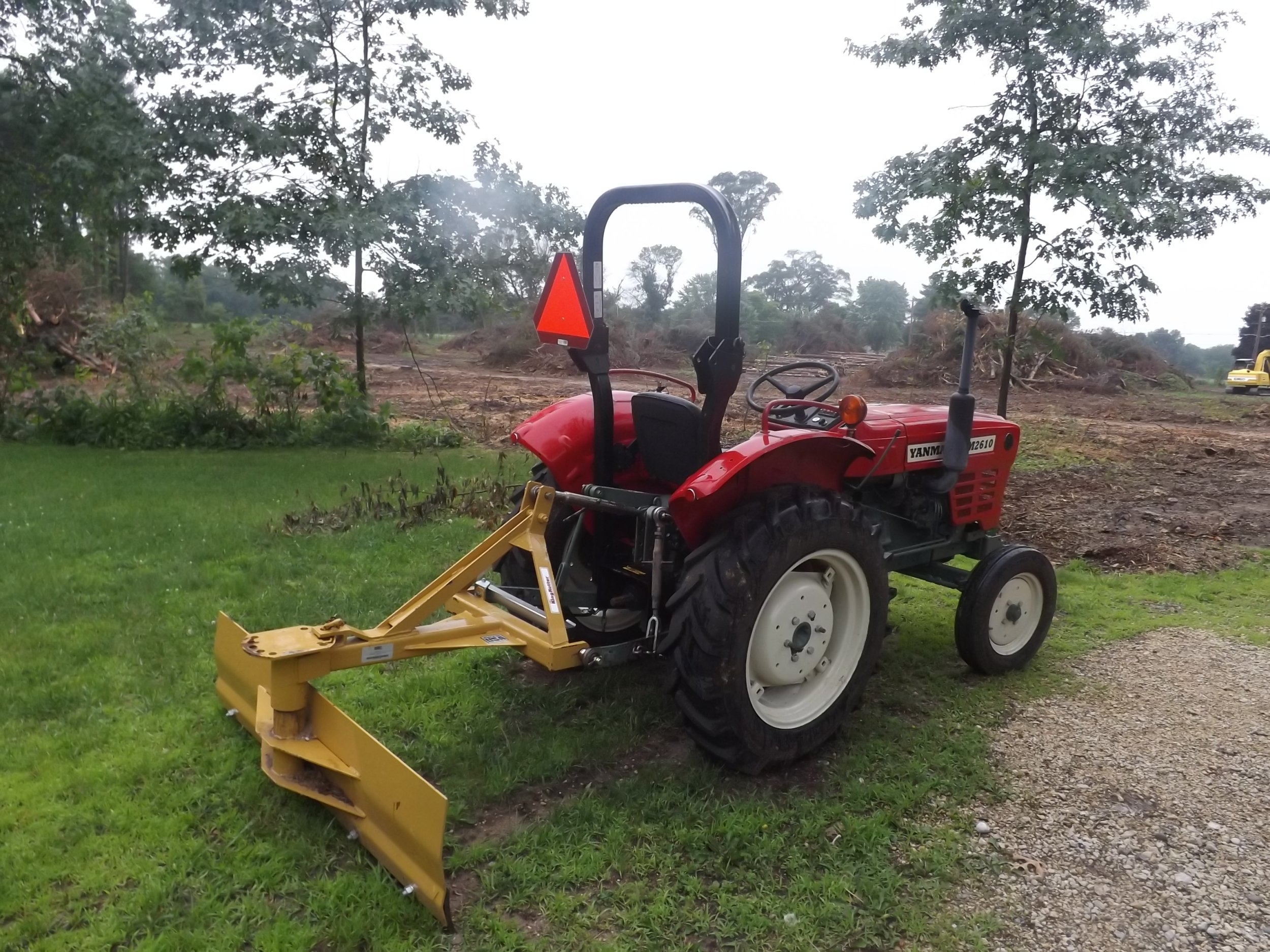

I think you will be disappointed with that flat faced blade when it comes to moving snow. Also - flat faced will not be as strong a curved blade.
I have a King Kutter Pro series rear blade. Just like the OP pictured
It is curved, They a not a flat face blade
   / King Cutter professional rear blade #12
Not the best blade for removing snow. It's way shorter. The blade will bend/twist permanently if you try pulling out stumps or large rocks out of the soil.
Now, if you don't have a heavy duty use like I had mentioned, then indeed get it.
I have a bunch of KK implements.
Dont buy this style of rear blade. The edge has next to no support. It almost alreaty looks bent in this pic.

I have one like that, I use a cordless 1/2” impact to adjust it, it stays where I put it.

The problem with those blades that adjust by bolts is you can’t quickly change the offset while using it. For example, while plowing snow or grading gravel, I like to make the first pass on either side of the road with the blade offset to push snow into ditch or pull gravel from the ditch. Then I like to spin it 180 degrees to do the road center with the back or the blade, so I don’t start moving gravel. This is possible with a pin offset blade.

We don't ever have enough snow to plow and if I am working on a road, I go down one side and back on the other side at the same angle.

Bolt adjustment is out of date. Mine is pin adjustment.
See post 6 by oosik. The adjustment is faster/easier and you will be MUCH HAPPIER with a pin adjustment style blade, and find you can do a lot more with it.

Then it works for you. I do like the offset ability to pull gravel from the ditches back onto the road. That’s one reason why I prefer a good offset blade over a box blade for road maintenance.
