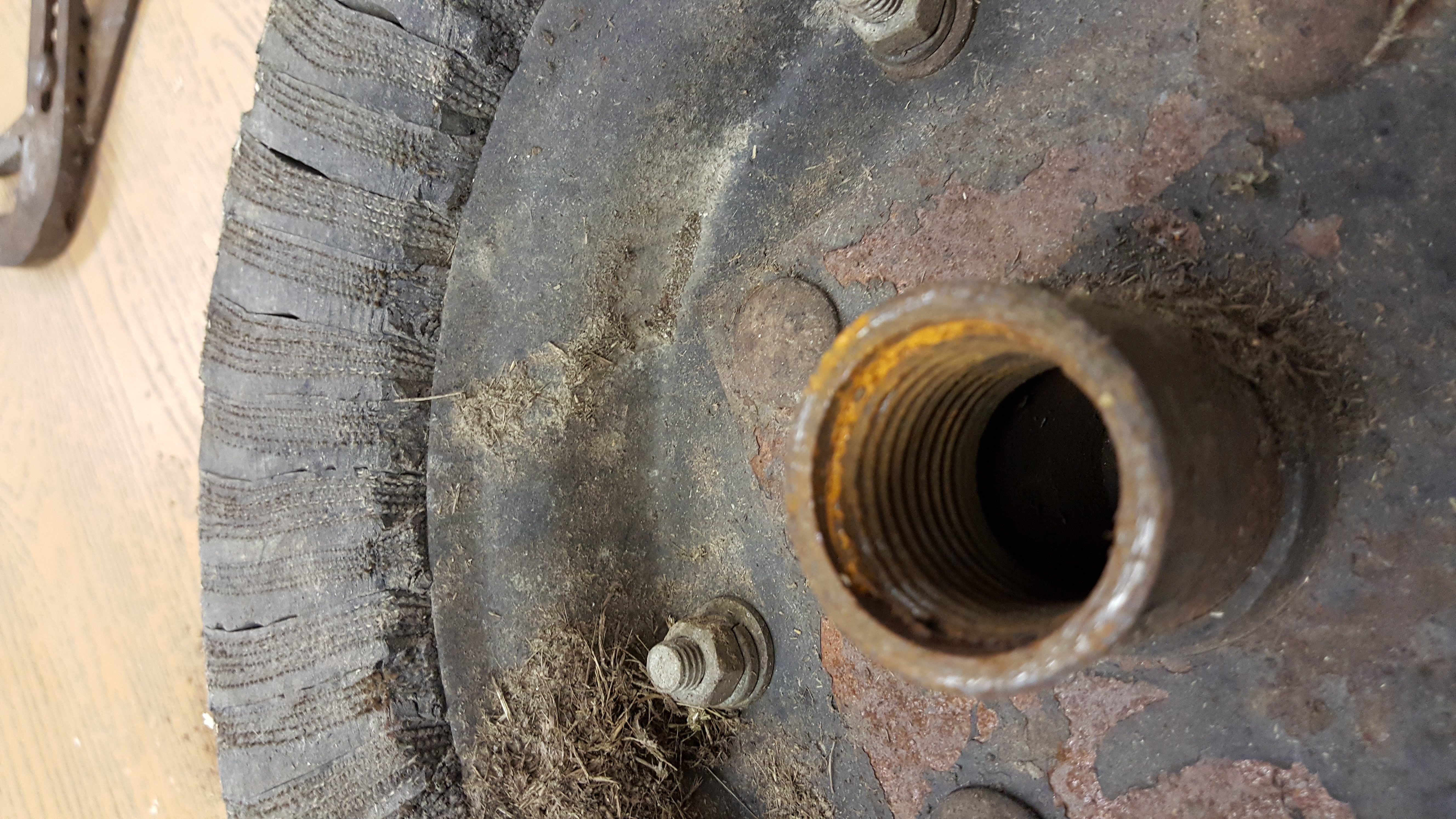

Any idea where I can get a bushing to thread into the tailwheel on this King Kutter brush hog? Thanks
   / King Kutter - Brush Hog Parts Question #2
I have gotten parts for my KK brush mower from Rural King. They have an online parts catalog & their prices seem ok even with shipping.
   / King Kutter - Brush Hog Parts Question #3
How close is that thread to NPT/iron pipe? A pipe nipple in there and then bored to just fit a nice off-the-shelf bronze bushing might work nice. Maybe drill and thread a hole through the side of the pipe nipple for a setscrew to hold the bronze bushing so that it's easily replaceable.
I will check on the pipe- may just buy a new hub - 25$
   / King Kutter - Brush Hog Parts Question #5
The whole hub assemblies are available at Rural King and I think TSC. They make a couple models, $20 and $35.
