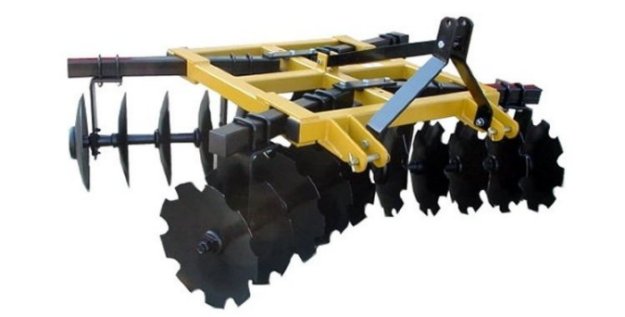

Are you talking about a KK disk like this?

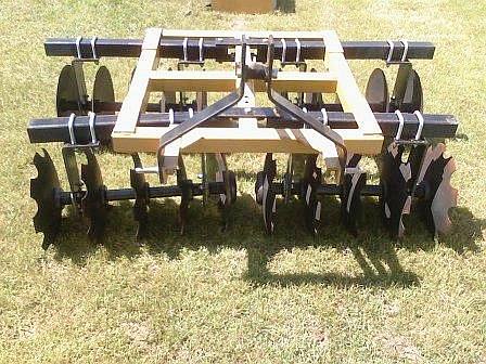

Or this one?

Here's the disc I've been bad mouthing. As you can see, it's not a giant, but isn't a cheap angle iron lightweight either.
