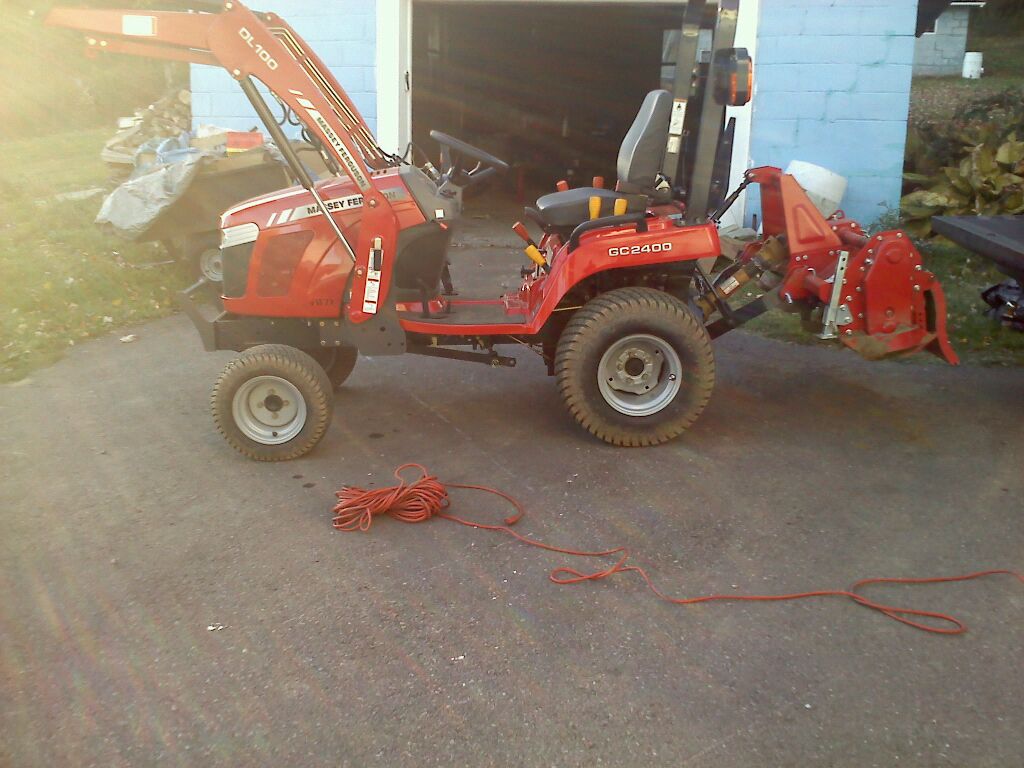

If you are going to be using it on the BX25.............you want someting like the XB model. It isn't just the 'narrower hitch' , it's also the lift height...............The BX25 will not lift as high as a compact tractor. The XB style tiller was made specifically for subcompact tractors.
Like the Bush Hog RTC48 tiller I own, it's made for subcompact tractors.

You may want to measure the height of the lift arm pins on the XB and your lift arms on your tractor. I had a King kutter XB box blade and with my 3PH all the way down it was barely on the ground.

He may be okay with something short like a tiller these tractor lift pretty high. I can move a wood LR landscape rake I just have to watch real uneven spots. The sure thing to do is measure the lift arm pins on the implement and the 3PH all the way down.

Checking is required. I purchased a 1 row cultivator from TSC, although I can lift it, all it takes is one bump in my yard and the tines dig in while fully raised. It now resides at my BIL's house and has been fitted with potato hillers. He uses it on his JD790.
TSC mainly sells attachments made for compact tractors.
Here is what it should look like with a tiller attached and raised:
