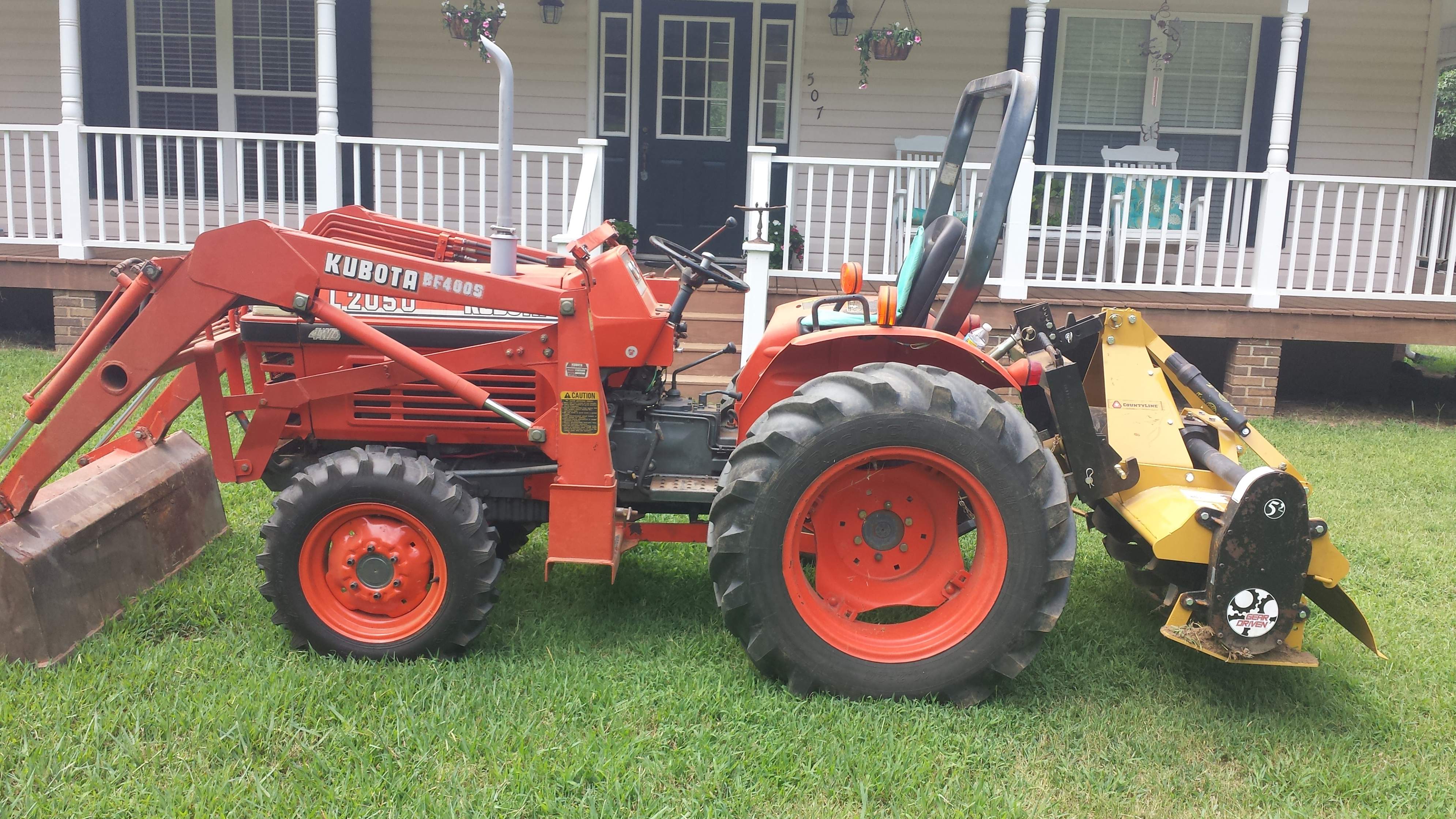

I've got a 5' KK tiller spec'd at 25 to 40 hp. I run it on a Kubota L235 (23.5 Hp with 19.5 PTO HP) Bought it when I was on sandy soil, but now use it on clay & rocky soil (more like pockets of gravel with some 3" gravel pieces). It does fine, just take it slow. It's weight is about all the tractor can handle and the tiller does try to push the tractor some, so the tiller is a little big from that perspective, but as far as HP & tilling the soil, it all works fine.
